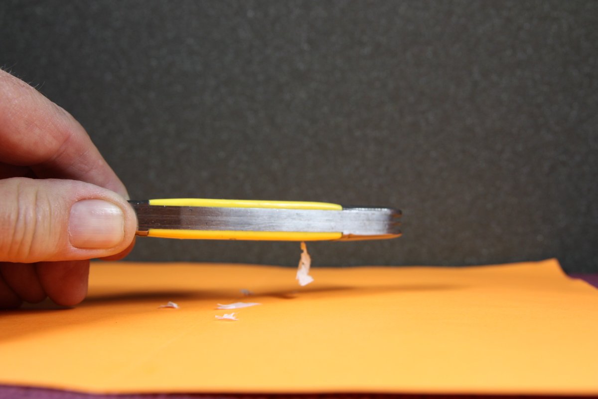

I learned something interesting yesterday that relates to the frequent question asked here on AAPK, are those handle slabs on my old knife bone or not? A fellow was telling me how he learned this from an old guy that collected knives for decades. It is a static electricity test. The way I tested this at home today to see if it works is like this. As you can see in my photo I had an orange piece of paper so things would be more easily visible, then I tore some pieces of tissue paper into tiny pieces (make sure your hands are clean and dry before doing this). Then I took a knife that I knew to be of composition (not bone) material and stroked it against the back of our cat Sophie. This built up a static charge on the handle material of the knife. I then carefully brought the knife down toward the pieces of tissue paper WITHOUT TOUCHING THEM and WOW, some of the pieces jumped up and stuck to the knife handle.Everyone who has animals in the house is familiar with the static charge that builds up when you stroke them, especially during the drier winter months indoors. Bone handles will not accumulate a static charge like synthetics will and it is this principle that makes this work. I would be interested in seeing what results others of you who are reading this get when you try it.

Very neat ! I will give it a try when time permits and see what happens.

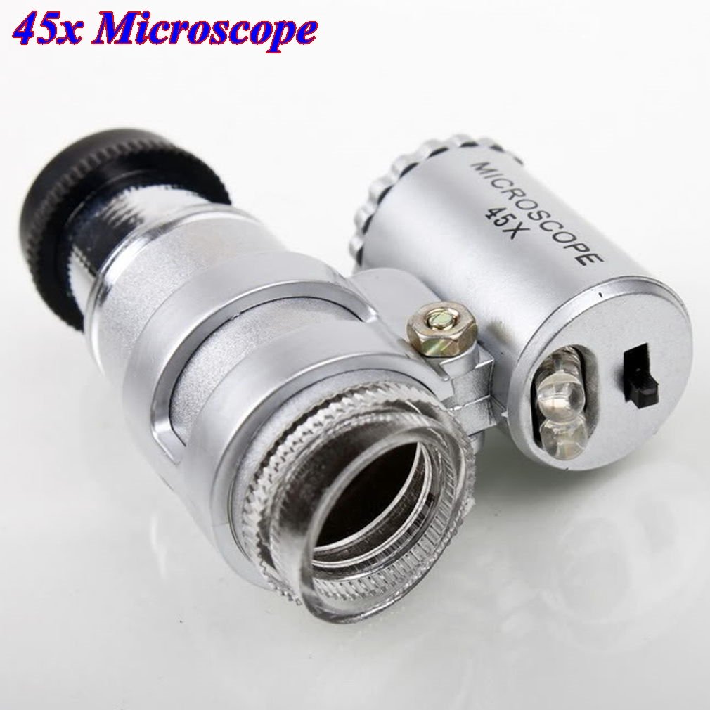

It's a lot easier for me to pick up my 45X microscope and just look. Cost me 2 bucks on ebay.
BUT if you don't have your microscope with you or don't have one, that sounds like a nifty low tech way to differentiate between bone and synthetic.

Thanks for posting this info, a very useful tip.

Jerry, that is a lot cheaper than having to maintain a cat. loljerryd6818 wrote: ↑Sun Mar 21, 2021 6:59 pm It's a lot easier for me to pick up my 45X microscope and just look. Cost me 2 bucks on ebay.
