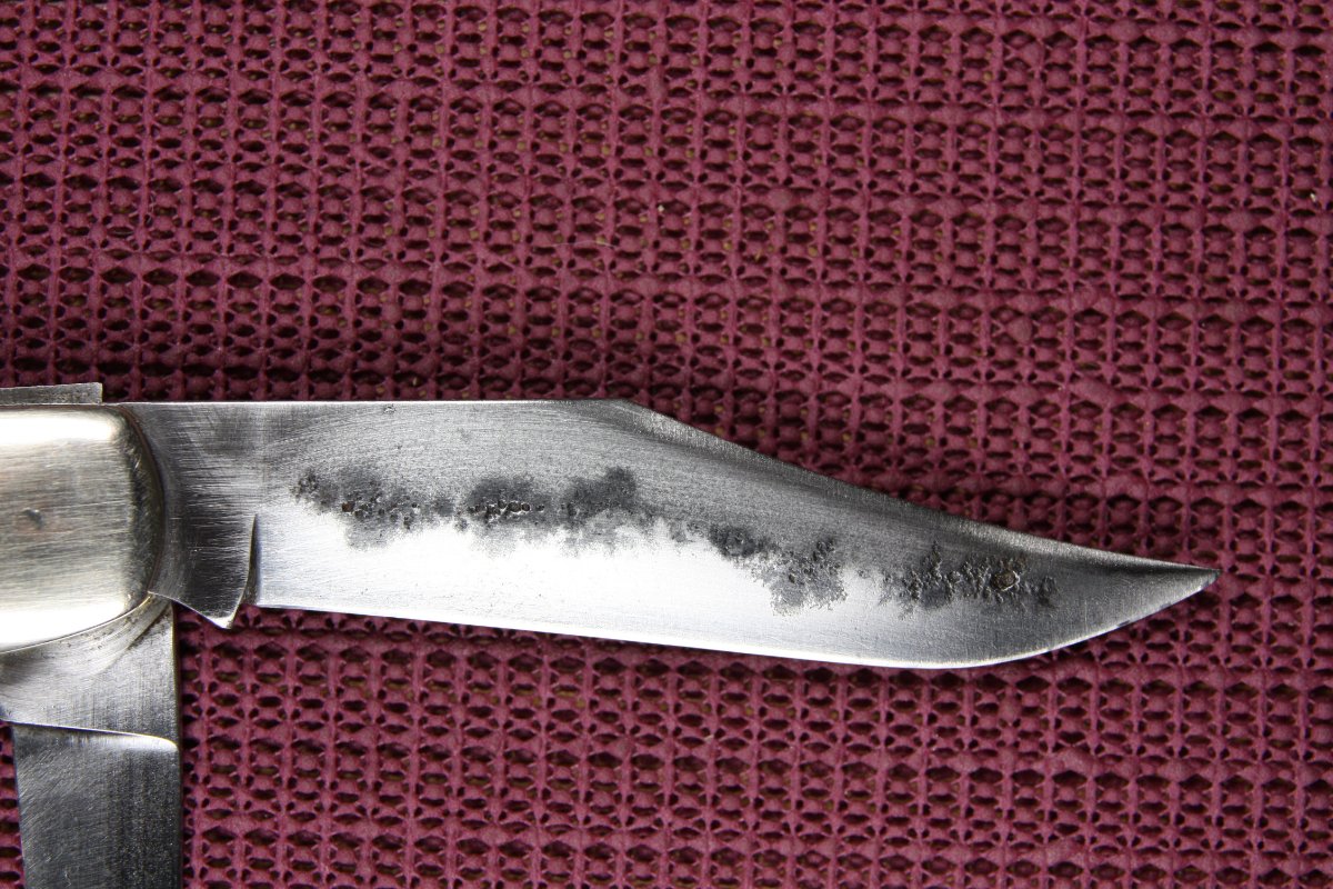

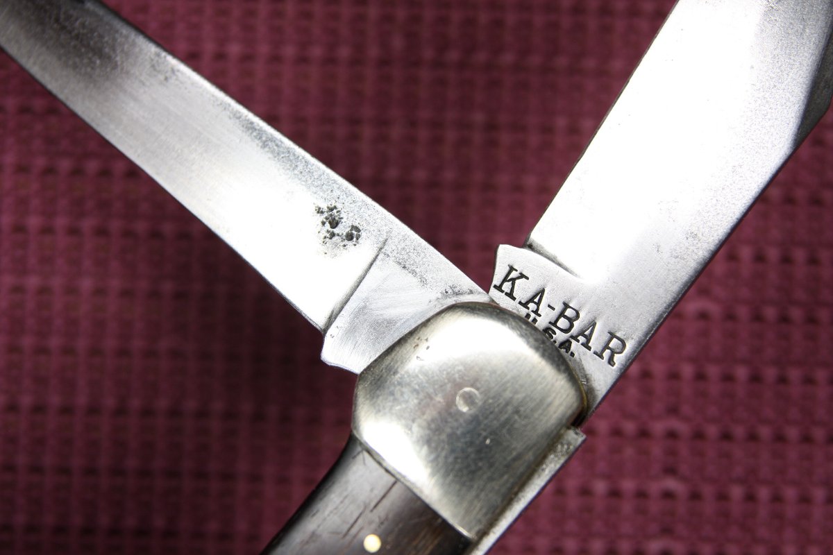

I agree, there is no way to fill rust pits. Only remove metal around them to make them "go away". Is the knife as bad as this KABAR folding hunter that I picked up at a flea market for $1 because the seller thought it was useless junk? I rehandled it with rosewood and it is one of my favorite folding hunters to carry and use. The pits have no effect on performance.
