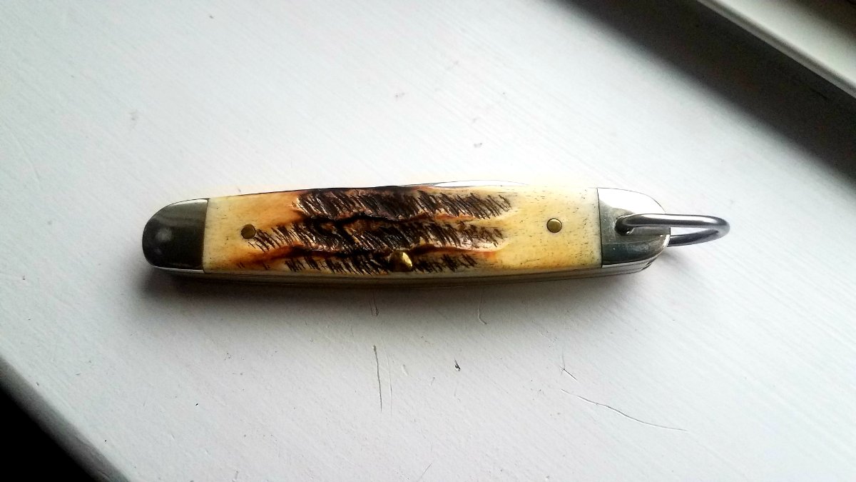

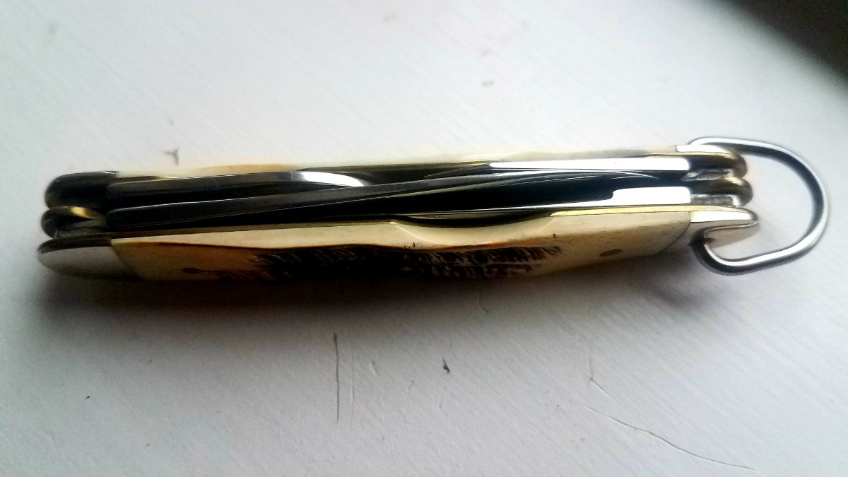

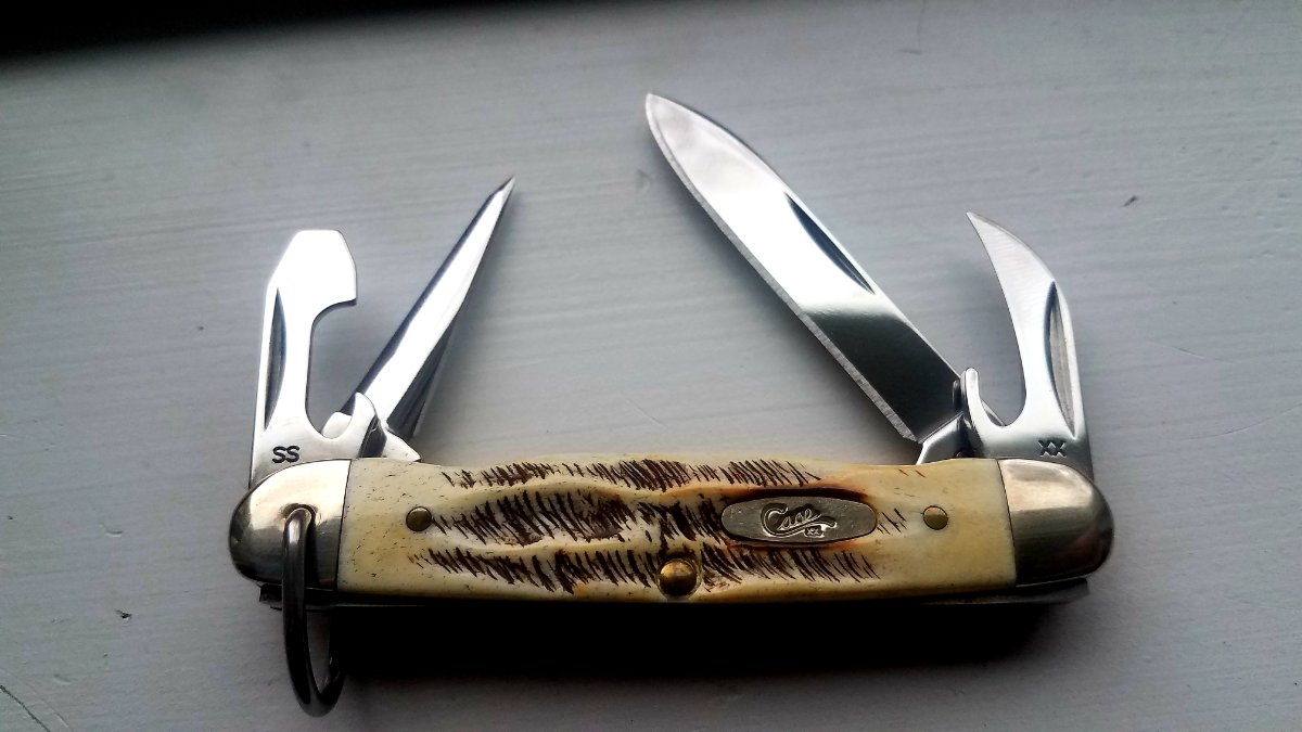

So I have this lovely Junior Scout that I got a while back and would like to carry once in a while. The problem is the way they cut out the notch to access the awl is not sufficient and I cant get my nail in far enough to grab it. You should he able to see in the pics.
Any advice on the best way to reshape the bone scale so I can access the awl? I was thinking of just using my dremel very carefully but I want to see if anyone else had any better ideas first. Thnks!

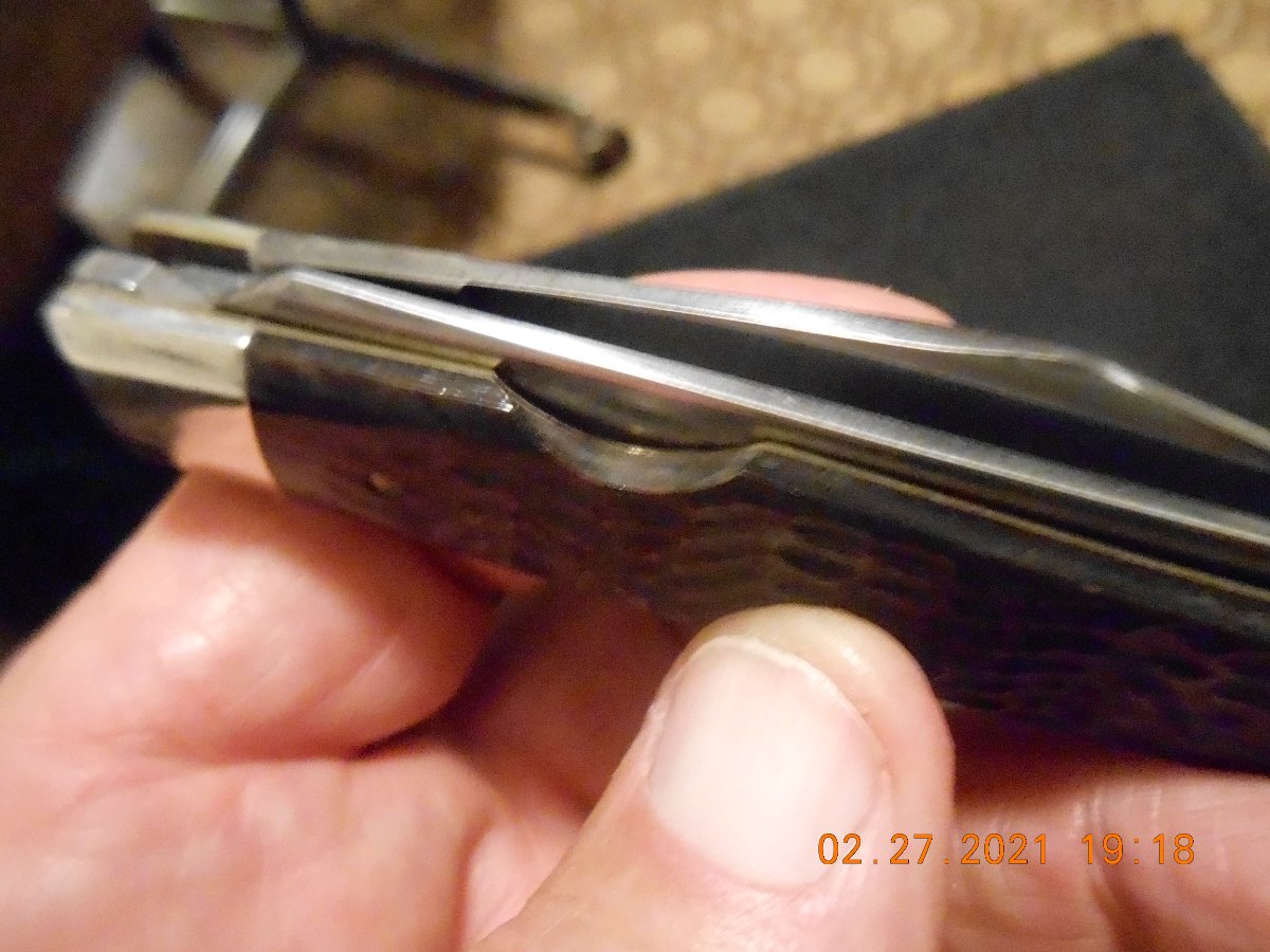

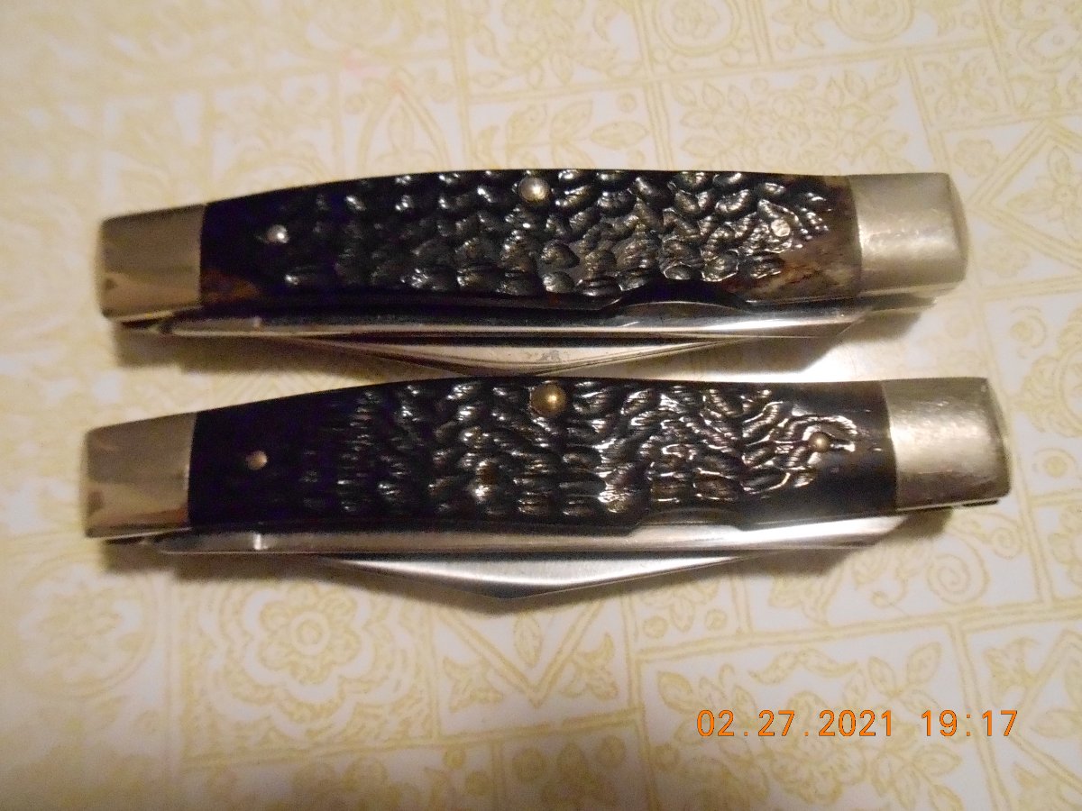

Not to be contentious but personally I wouldn't hesitate to expand the notch with my Dremel. I was bombed/gifted a Case 6275 Moose, a 1981 issue. It had the same issue with its' spay blade as does your awl. I carefully expanded the existing notch to allow easier access to the nail nick. I chose one of the sanding drums and was able to remove enough bone and brass to open the blade. Can't tell it from one that was untouched.
Can you tell which one has been worked on? Here is a closer shot of the Dremel work: Treefarmer
- cudgee
- Posts: 6930
Re: Need advice on Case Jr. Scout
You have done a great job there, if you have confidence in being able to control a dremel you show what can be achieved. I would not trust my skill or lack of skill level on such a knife as in the original question. If i had old knives to practice on i could probably improve my skill level.
