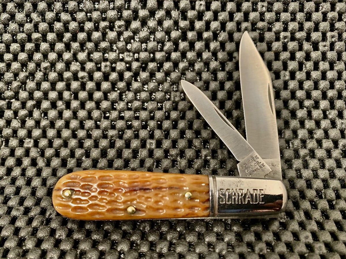

Interesting Lyle, I will certainly give that a try also, do you use wide lead like a carpenters pencil?
Here is the knife in question, a Schrade Cut Co Barlow with close to full blades and very hard to find jigged bone covers, saw cut bone was the standard cover material and the jigged bone was not used much on the Barlow.
