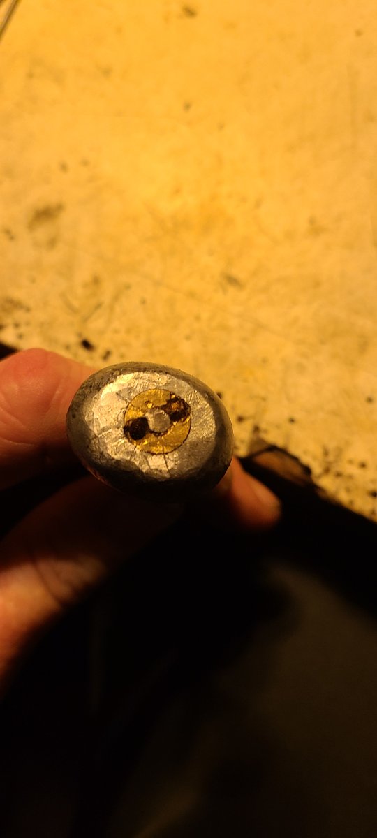

My question is...how do I get this fixed knife apart. ::shrug:: ::facepalm:: ::dang:: Special tool maybe? I have yet to get it to budge.

You can make a tool by notching the blade of a very large, cheap screwdriver, or buy a "pommel nut tool." I recently worked on an old Marble's Woodcraft that had a loose pommel. I bought a pommel nut tool form the big auction site and it worked beautifully. I PM'd you a link to the tool I purchased.
If the pommel nut and knife tang are in really good shape you can usually get them off by using the tips of a pair of needle nose pliers. Looks like that won't work in your case...

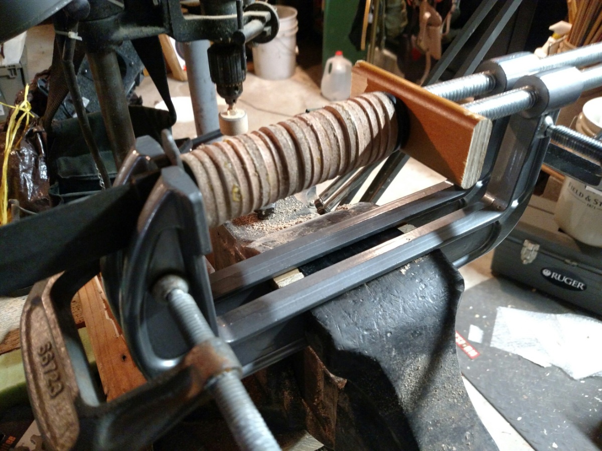

I was not aware of the soldered pommels. This is the jig I made for a KA-BAR style with a pinned pommel.

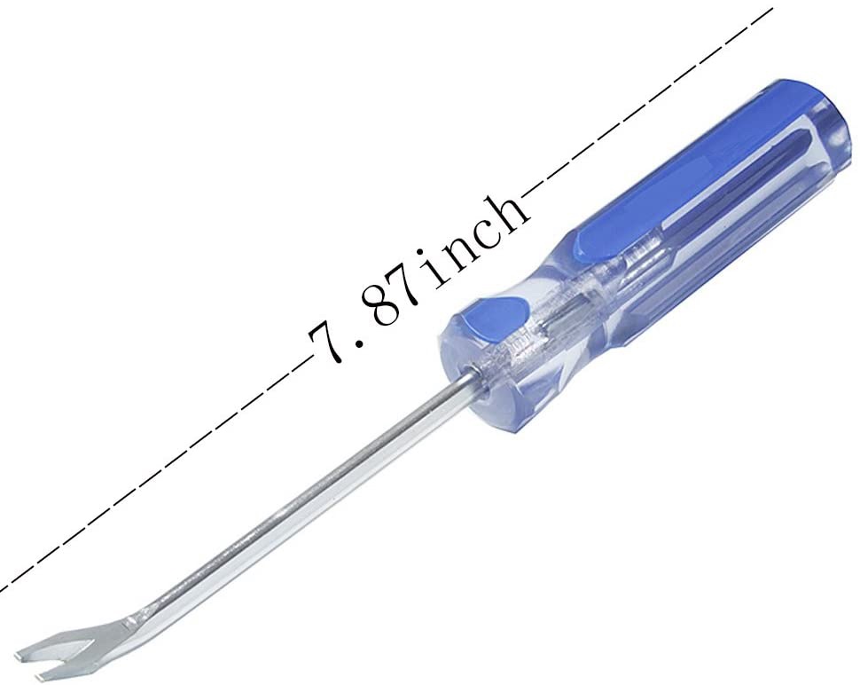

Post by KLJ77 »
I've used one of these on several pommel nuts with great success.

Sweet! I think I have one of these.
KLJ77 wrote: Sun Jan 03, 2021 2:19 am I've used one of these on several pommel nuts with great success.
