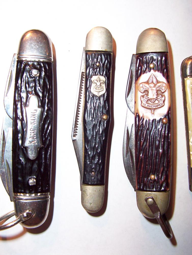

SFC ADP
Posts: 506
Joined: Thu Feb 02, 2006 6:20 am
Location: Iowa City, IA
Post by SFC ADP »
I will have to try the mineral oil,
As for handle types, One is stag, or possibly imitation stag,
Others are celluloid or some type of composites.
Another which is some type of plastic composite I think, looks like a layer of plastic over metal that has a textured service, I imaginethis is defined as a type of composite handle as well.
El Lobo
Posts: 3036
Joined: Tue Dec 14, 2004 4:47 pm
Location: Arizona, right here in the U.S. of A.
Post by El Lobo »
SFC ADP,
Can you post some pictures?
Bill
SFC ADP
Posts: 506
Post by SFC ADP »
will do, been at the hospital most of the past few days, we just had a new born, but will try to get some time this weekend to show ya.
