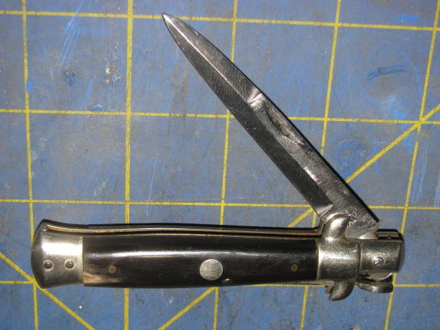

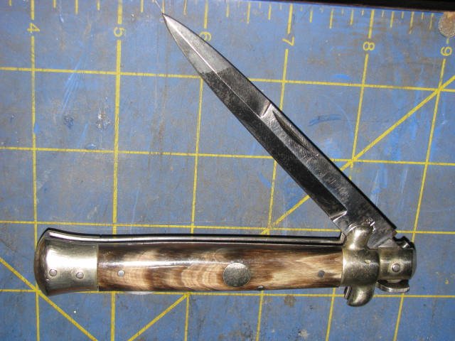

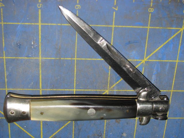

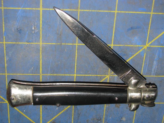

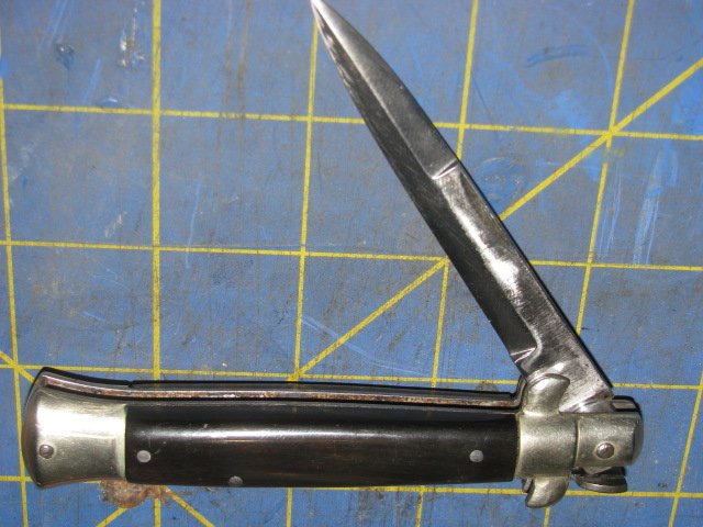

knife7knut
Posts: 10697
Location: Tecumseh,Michigan
Re: Period Advertisement, Mystery Knife.
Post by knife7knut »

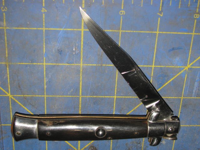

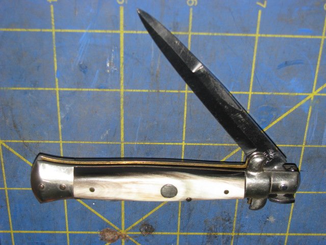

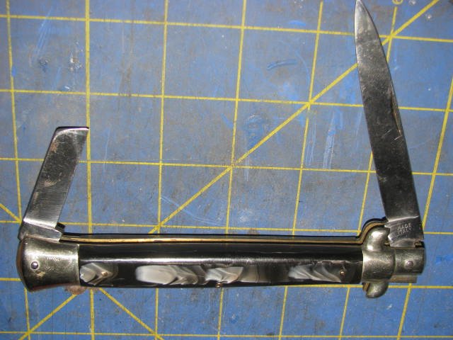

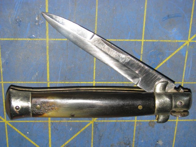

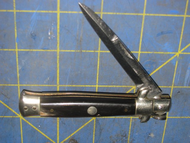

Here are a few from my accumulation.Some of these have a fake button covering the hole for the real one and some do not. One has a fake spring loaded button.None of these have release tabs on the back spring;they all have to be closed(without,"lightning"speed)by inserting your thumbnail under the tab near the pivot. The two bladed model does not lock open but depends on spring pressure alone. The only one like it I've ever seen.

Ray, you have quite a collection of these so called "Stiletto's". Do they open by depressing one side of the guard ? Is this how the "Wolf Killer" on OP opens ?
kj
knife7knut
Posts: 10697
kootenay joe wrote: Sat Dec 12, 2020 3:19 pm Ray, you have quite a collection of these so called "Stiletto's". Do they open by depressing one side of the guard ? Is this how the "Wolf Killer" on OP opens ?
kj
Roland;they open as does a regular knife;by inserting a thumbnail in the nick and pulling open. To close the blade requires inserting your thumbnail under the lock on the front and pulling up to release the blade.The later models used either a projection on the rear of the back spring to push down on and lift it up or rotating the side guard.The Wolf Killer ad is a bit deceptive in that I think they altered the original copy where it said,"Opens with lightning speed" to say ,"closes". Why they didn't just eliminate it altogether I don't know;maybe to keep the original balance of the copy and not leave any negative space in the ad.
