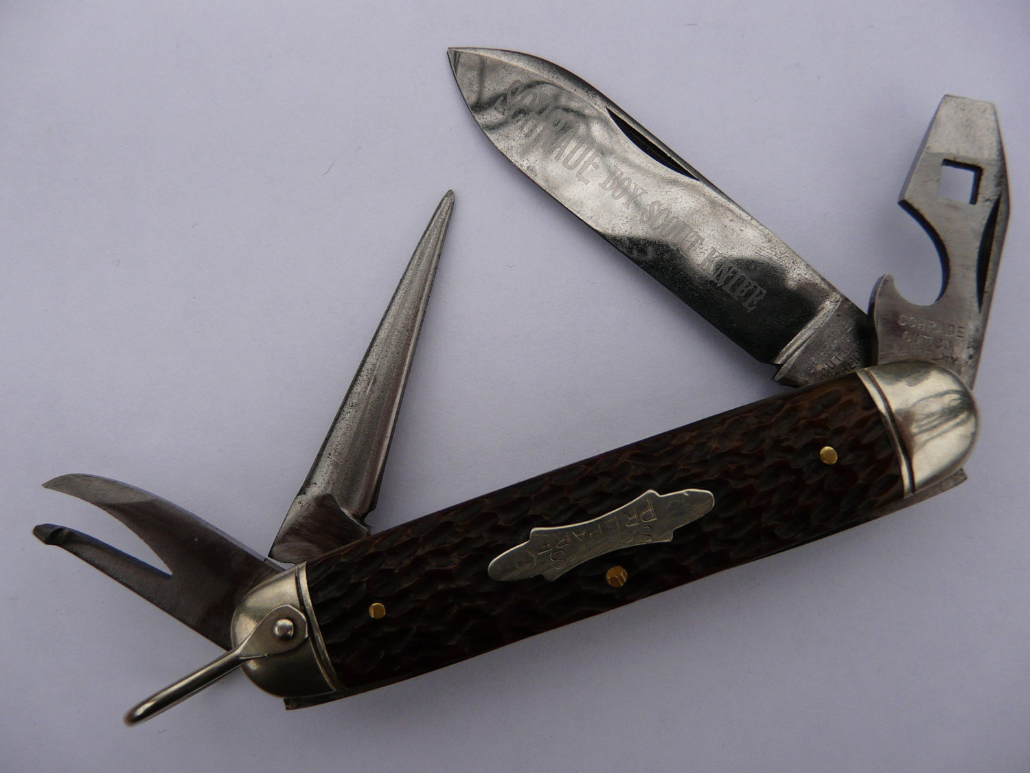

I was wondering if anyone has heard of a way of preserving a blade etch, or if an etch will even fade at all without being used. Any other storage tips? I'm concerned about keeping my Schrade Cut. Co. in its never sharpened, mint-for-its-age condition. Thanks for your help.

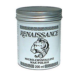

already ot a little pepper so i suggest a light coat of mineral oil or whatever oil you use, no w-d 40. or ren. wax is a good alternative to oil. excellent way to preserve. no abrasive polish on etch. nice old knife.

I see you are new here so Welcome and just to help you some more.
This is what jonet143 means by ren wax.
I have many old Schrades with etching on the blades and I use this on the entire knife not just the blades.
I also use a drop of TUF-GLIDE oil on the joints.
