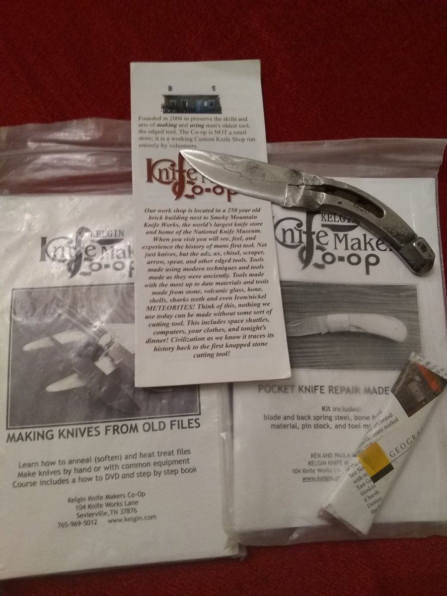

Posts: 18809
Re: Horseshoe knives?
I made this at the Knife Maker Co-Op which, back in 2011, was located in a reassembled log cabin in the parking lot of Smoky Mountain Knife Works. Anyone know if it's still there or in existence? ::shrug:: I see these knives for sale in the SMKW catalogues sometimes, they're not expensive.

Robert E. Lee
Posts: 18809
Colonel26 wrote: Fri Dec 04, 2020 11:34 pm Horseshoes are really easy to work with. But in my experience they’re a low carbon steel. I have one and it’ll get sharp, but I don’t think it would hold an edge for long.
We added stovepipe carbon while forging this one. Not sure how effective it was but, being a greenhorn, it seemed logical to me.
