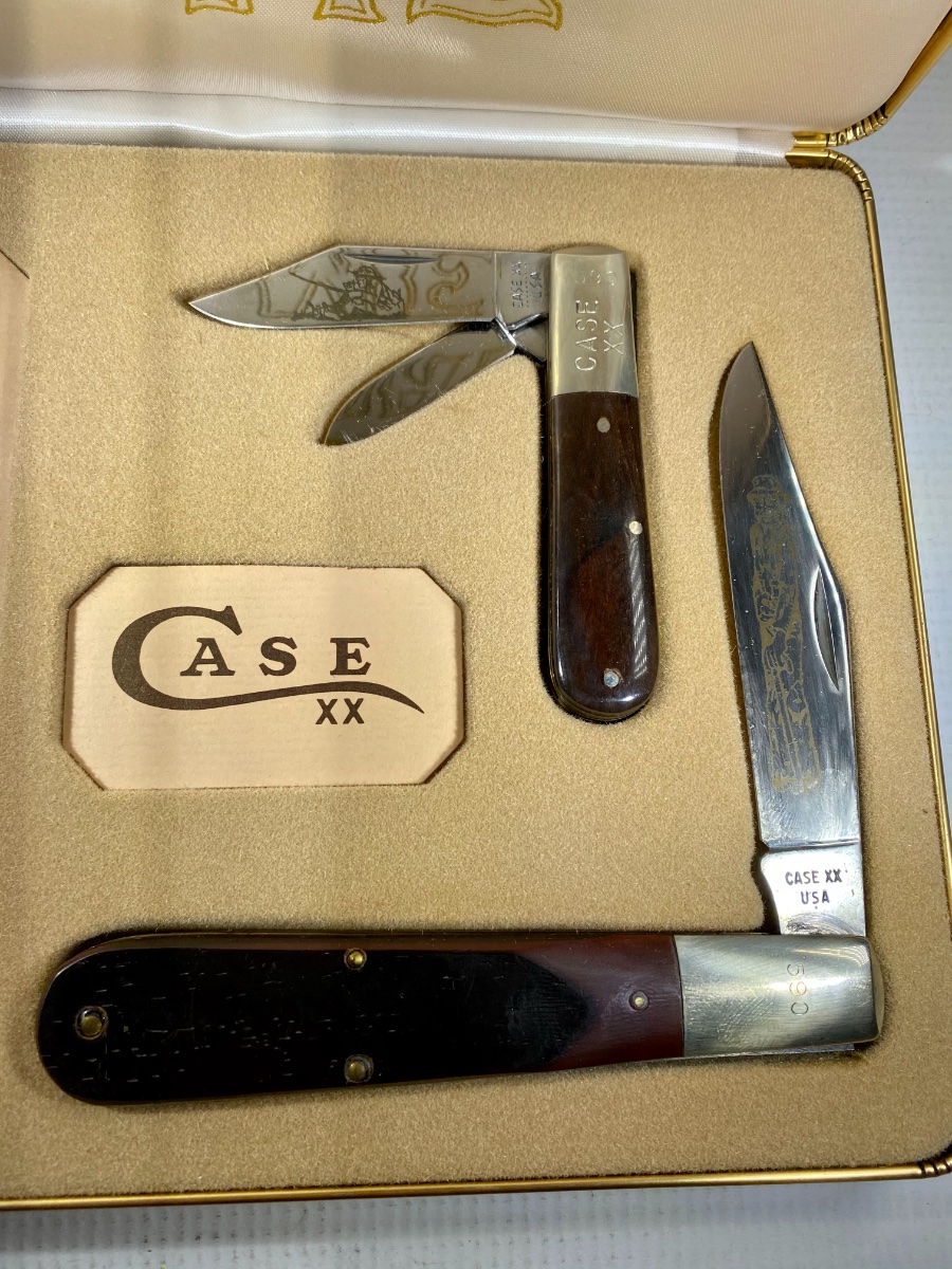

Anyone have info on this? Can’t find it anywhere. From the tang stamp it MIGHT be 1960’s? The USA has no dots in it though, so it’s not an exact match to that era and I can’t find it anywhere.
One of six hundred, serial #069.
Any history and/or estimated value would be most appreciated.

Looks like it was made in1979.

The large (granddaddy) Barlow was made in 1980. The small one is 1979 (it has one dot that I can see).
The set was likely put out in 1980.

Smoky Mountain Knife Works was born in 1978.
How many "Dots" are on your smaller knife bolster. ::shrug::

Just One. Thoughts?

The smaller knife appears to have many dots?

You have it backwards Ken.
The Grandaddy is 1979, the small one is 1980.

Sorry, I got them backwards when I typed that post. The large one has one dot, 1979. The smaller one has 10 dots and the lightning S, which is 1980.

Another quick question... This knife is the smallest one you all are telling me mine is, which is correct, of course. You rock stars you. :)
https://www.allaboutpocketknives.com/ca ... rlow-knife
What is my knife? Assuming ____________ Bone.
While I am at it, the big one is Delrin, right? Found this interesting, as I had to look it up... :)

Could be bone or Delrin, hard to say from the pictures. But you can usually easily determine under low magnification. Get a loupe and look for Haversian canals which are present in bone but not in a Delrin. Here’s how to do it viewtopic.php?f=98&t=62145
