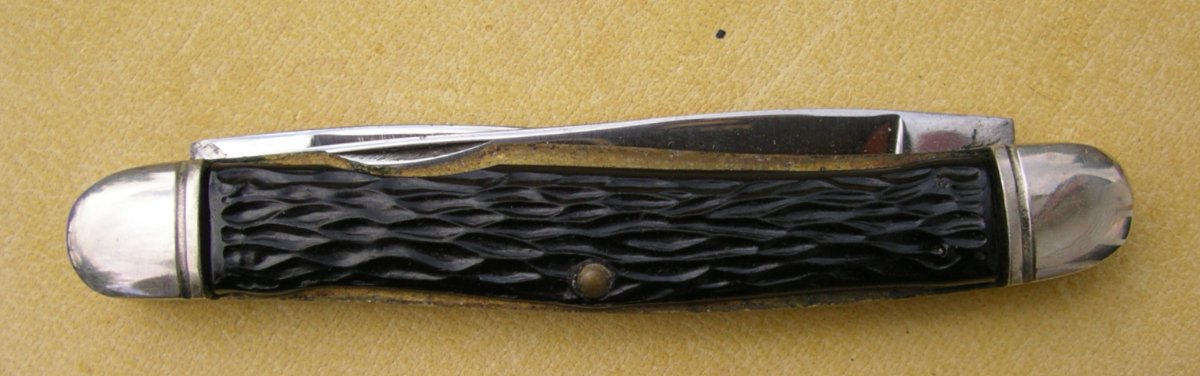

Here are 3 Camillus knives that i would like help to date and help to ID handle material on 2 of them.

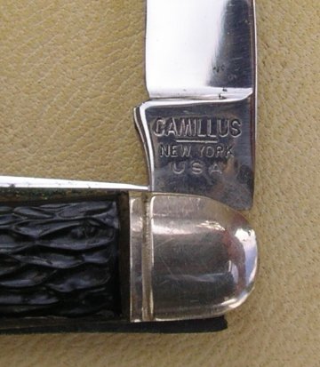

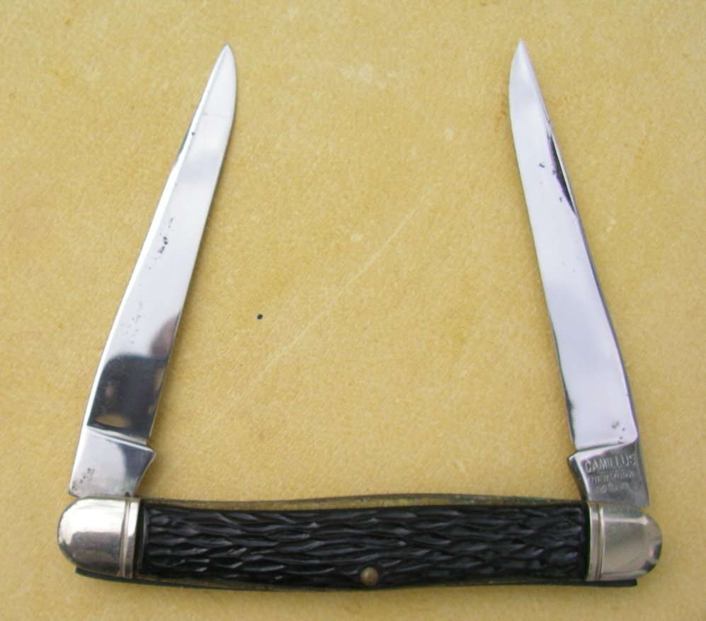

Camiilus #20, Muskrat, tang: "Camillus/New York/USA" with short line under "Camillus". The synthetic handles have shrunk so they are not Delrin and knife should be pre 1960. I doubt handles are celluloid as there is no corrosion of the steel.

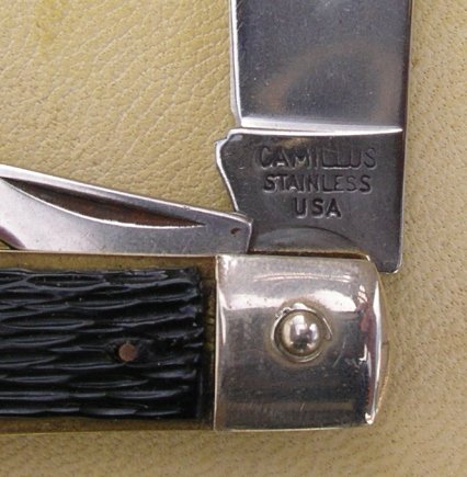

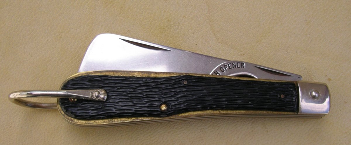

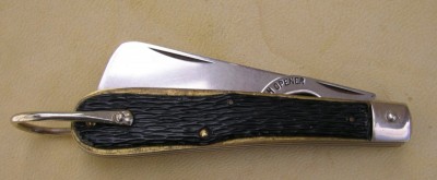

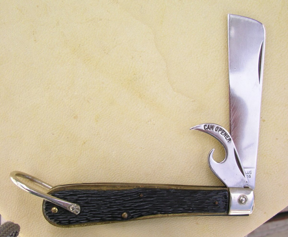

Camillus S702, a Rope knife with Can Opener secondary. Tang is marked: "Camillus/Stainless/USA", no line under Camillus. These synthetic handles have shrunk a lot but again no signs of corrosion on steel or brass so likely not celluloid.

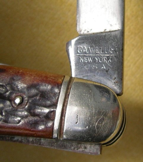

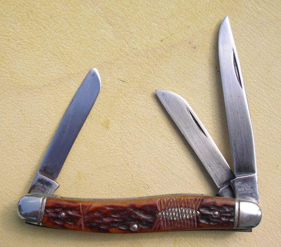

Camillus #69, with bone handle that has been 'customized' with cross hatching. Tang is: "Camillus/New York/USA" with a long line under Camillus.

I don't have a clue about the YOM on any of them BUT, I must say... I LIKE the rope knife! Very cool to see a can opener for a secondary blade.

............short line-1914-1941, long line not sure of dates!!........can't get to my "goin's" right now!!..........

The first two knives were made in the late 40s - mid 50s. The handle material was called plastag or stagged.kootenay joe wrote: ↑Wed Sep 02, 2020 9:39 pm Here are 3 Camillus knives that i would like help to date and help to ID handle material on 2 of them.
The third knife was made in the late 50s - mid 60s. It's a shame that some idiot ruined his handle.

The bone #69 has been used so i don't see the attempt at file work on the handle as "ruining" the knife. It would be a good one to carry and use.

Thanks Mike. This knife is a good candidate for some skilled knife person to re-handle. The GEC "Beer Scout" knives are now selling in the $700 range and here you could have a "Can Opener Scout' for just a few dollars.Meridian_Mike wrote: ↑Thu Sep 03, 2020 5:44 pm I don't have a clue about the YOM on any of them BUT, I must say... I LIKE the rope knife! Very cool to see a can opener for a secondary blade.
