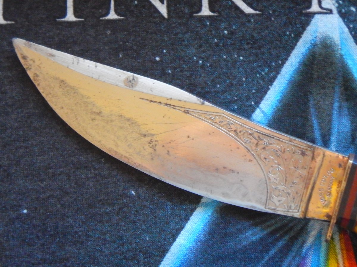

Sup crew.

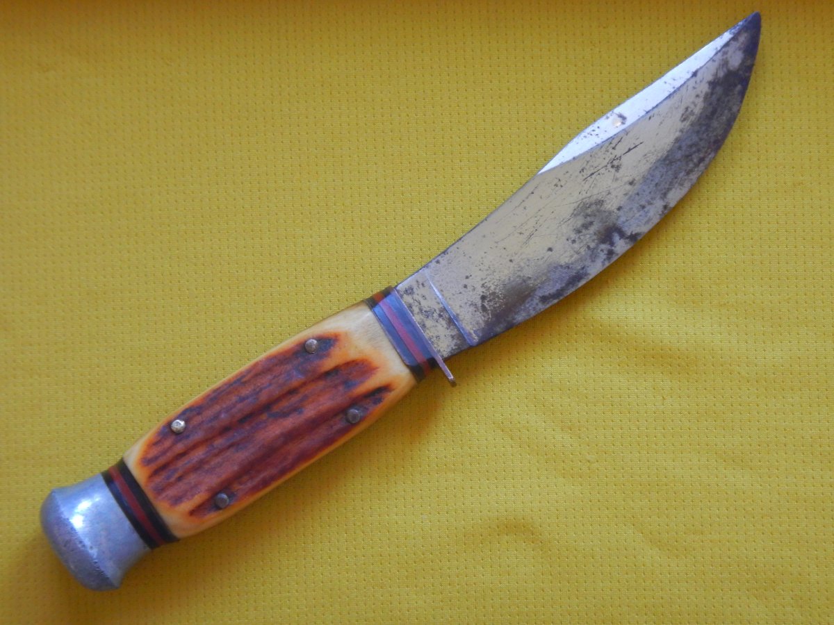

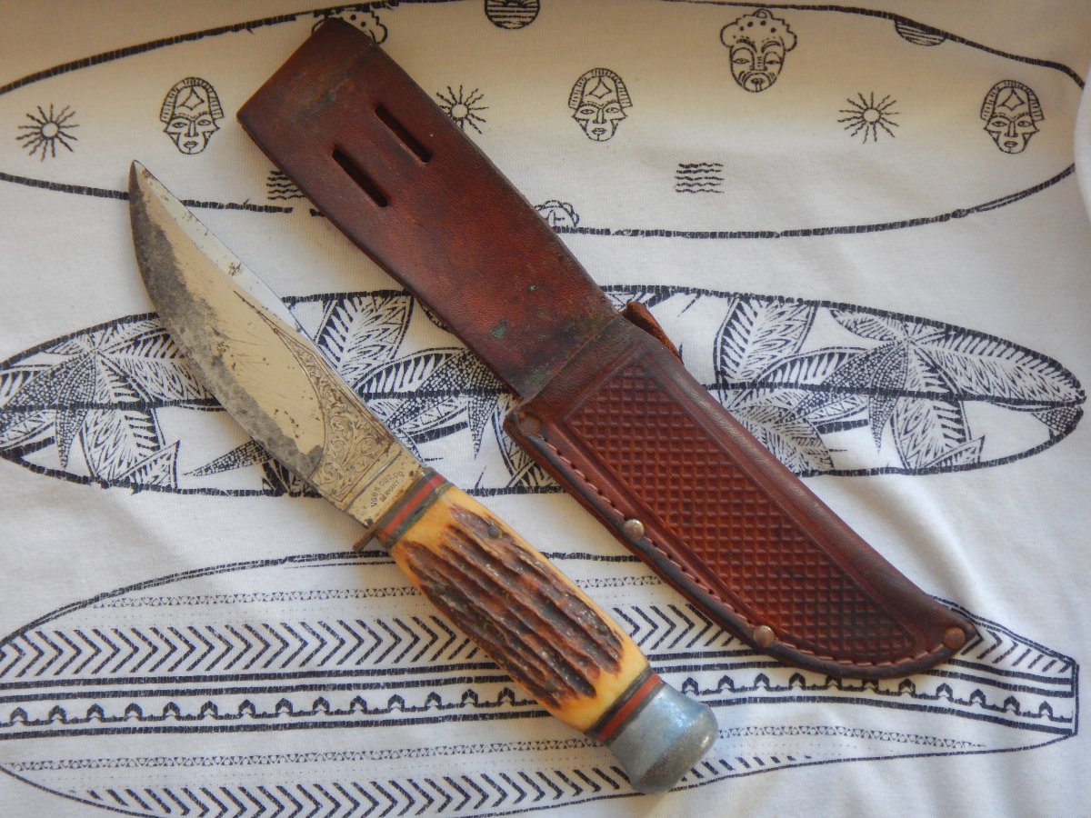

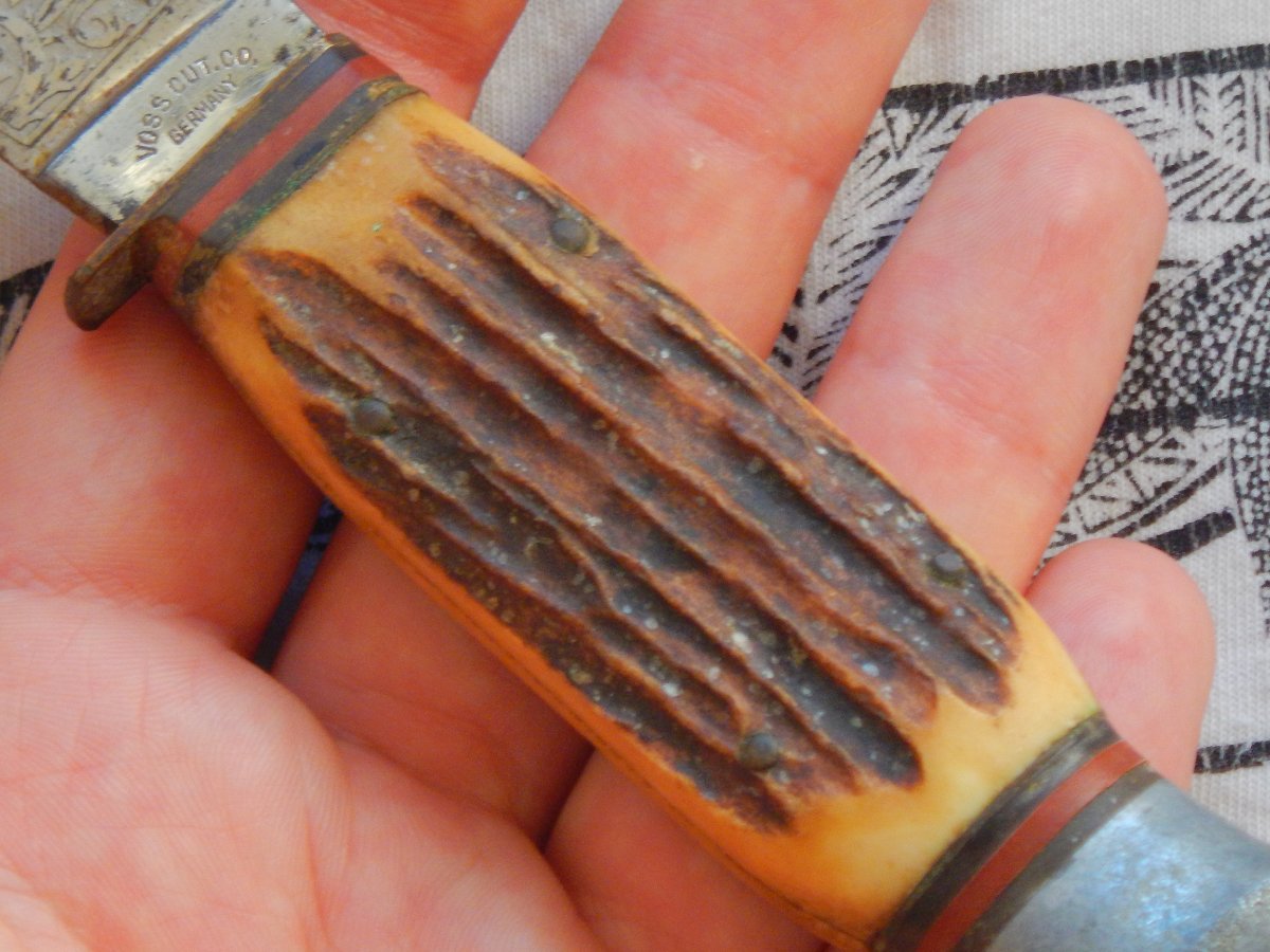

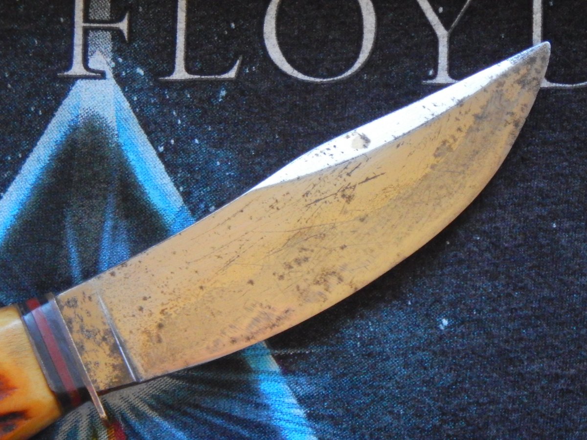

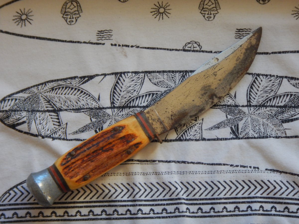

I'm in need of help/suggestions/tips, on how to clean/polish this knife. It's a vintage Voss stag skinner, that arrived to day from Mr. Case :wink: . He gave me a really good deal on her, so it's worth spending the money, and getting her cleaned up.
Any leads will be greatly appreciated ::handshake:: .

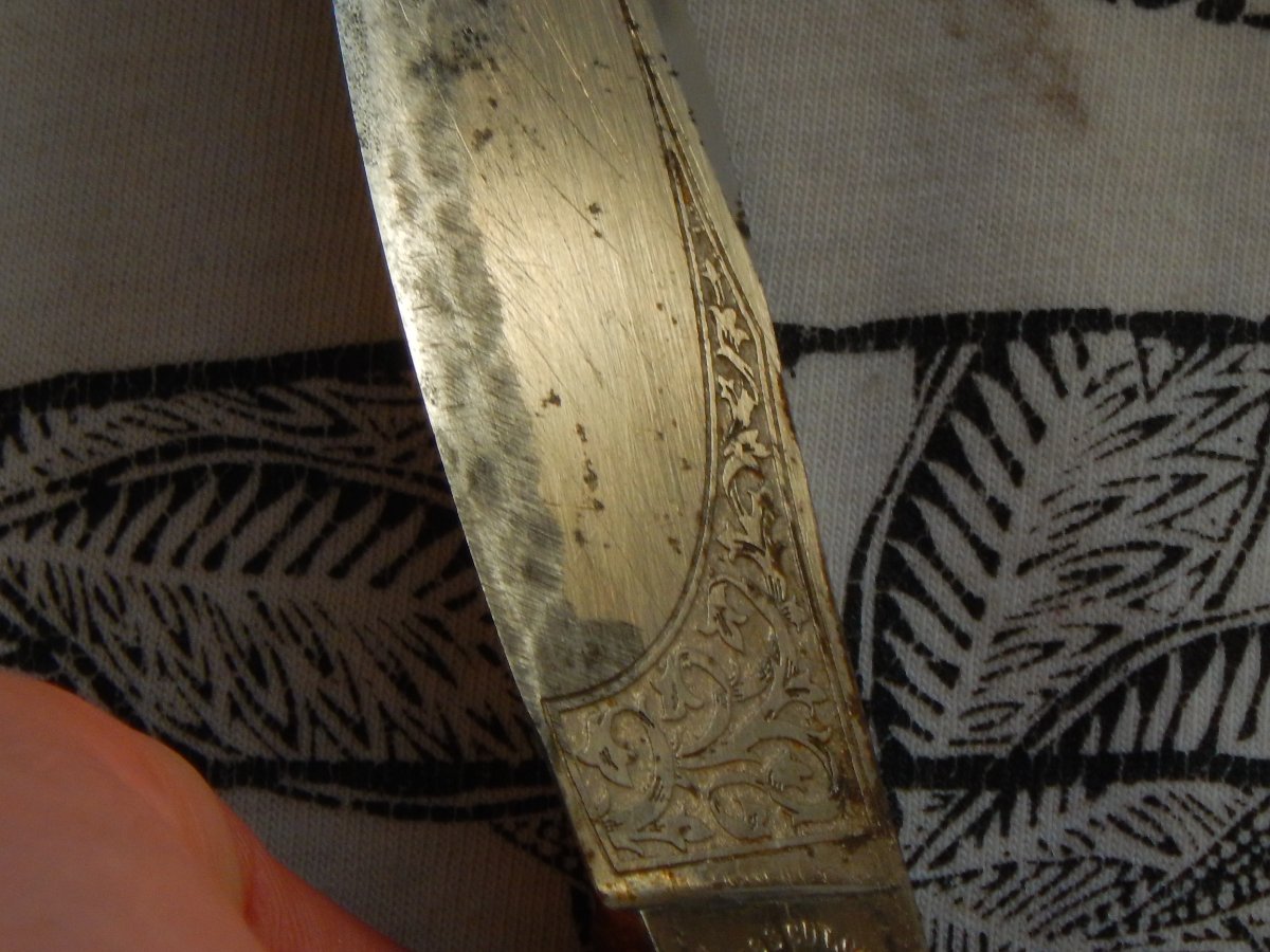

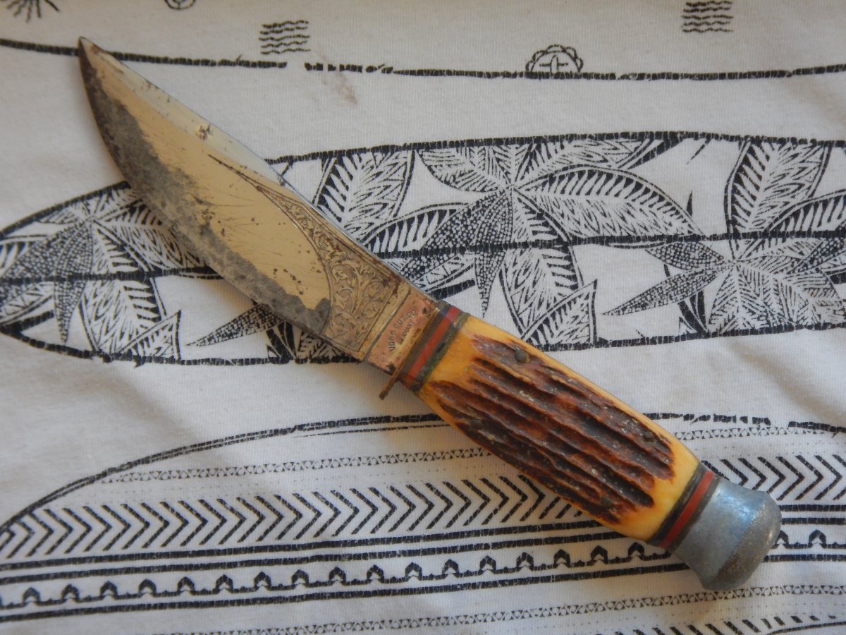

It looks like somebody "sharpened" it. There is a lot of scratches on the cutting edge. That area looks to be where the dark tarnish is showing up. Get it in hand and take a good look at the areas you want to address, You probably need to be very careful what you do at the deeply engraved area. One edge of that engraving is very close to the cutting edge.
It begin with, I probably wouldn't use an aggressive sand paper. Maybe start at about 500 grit and some oil and see how that does for you.
The bone handles may have aged to the yellow color. In my opinion, that is a BEAUTIFUL color for bone.
Good luck!
::tu::
Gunsil
Posts: 3081
Re: Need help...
Post by Gunsil »
What do you expect to get out of it? Those grinder marks are awfully deep, and with a flat ground blade be near impossible to remove without destroying the engraved portion. The grinding marks are so deep 500 grit will not help one bit, you'd have to be down around 180 or 220 and then work back up to 1,000 in steps of 100 -150 grit to remove the scratches. There is a reason knives with such deep grinder marks are sold at low prices, the work getting rid of the marks can take a LOT of hours if done by hand. Doing it by hand is likely the best solution since a belt sander will be harder to avoid damaging the engraving. These 1960s-1980s German made hunters don't have a large collectors following so if you plan to use it just let it be, hours of sanding out the grinder marks will not increase value or user ability by much. By the way the sheath is from a Schrade hunter, not original to your knife. The stag handles were dyed, they did not age to that color by themselves. Pretty much all stag handle hunting knives use dyed and sealed stag otherwise they would be rather white in color when new and few are. PS that is sambar stag which is quite dense compared to American stag which has never been used on factory American knives such as Case or KA-BAR and the German or English knives.

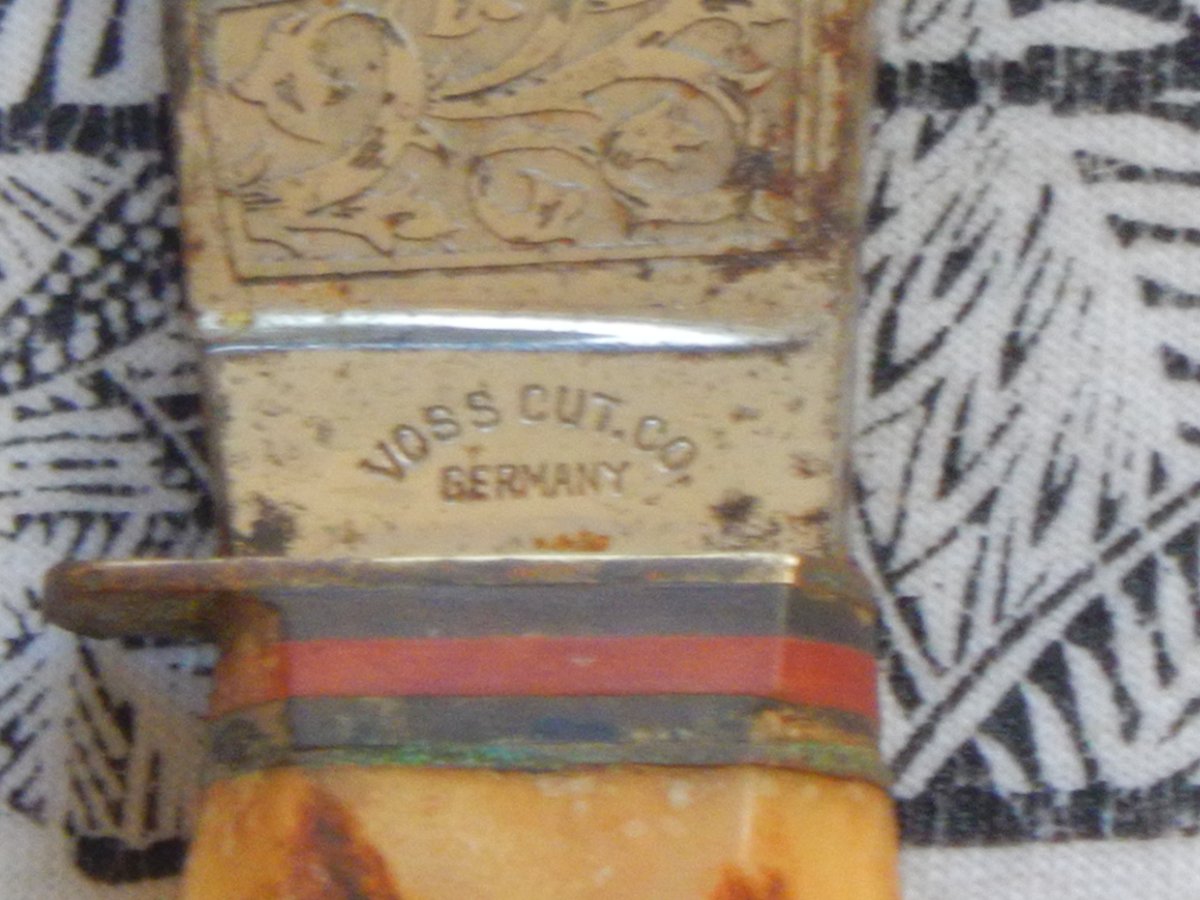

Your knife blade was nickel plated after it was acid etched (not engraved.) That is why you see the discoloration where it was sharpened.
The blade could be cleaned up with much careful hand work, but then would have to be nickel plated again.

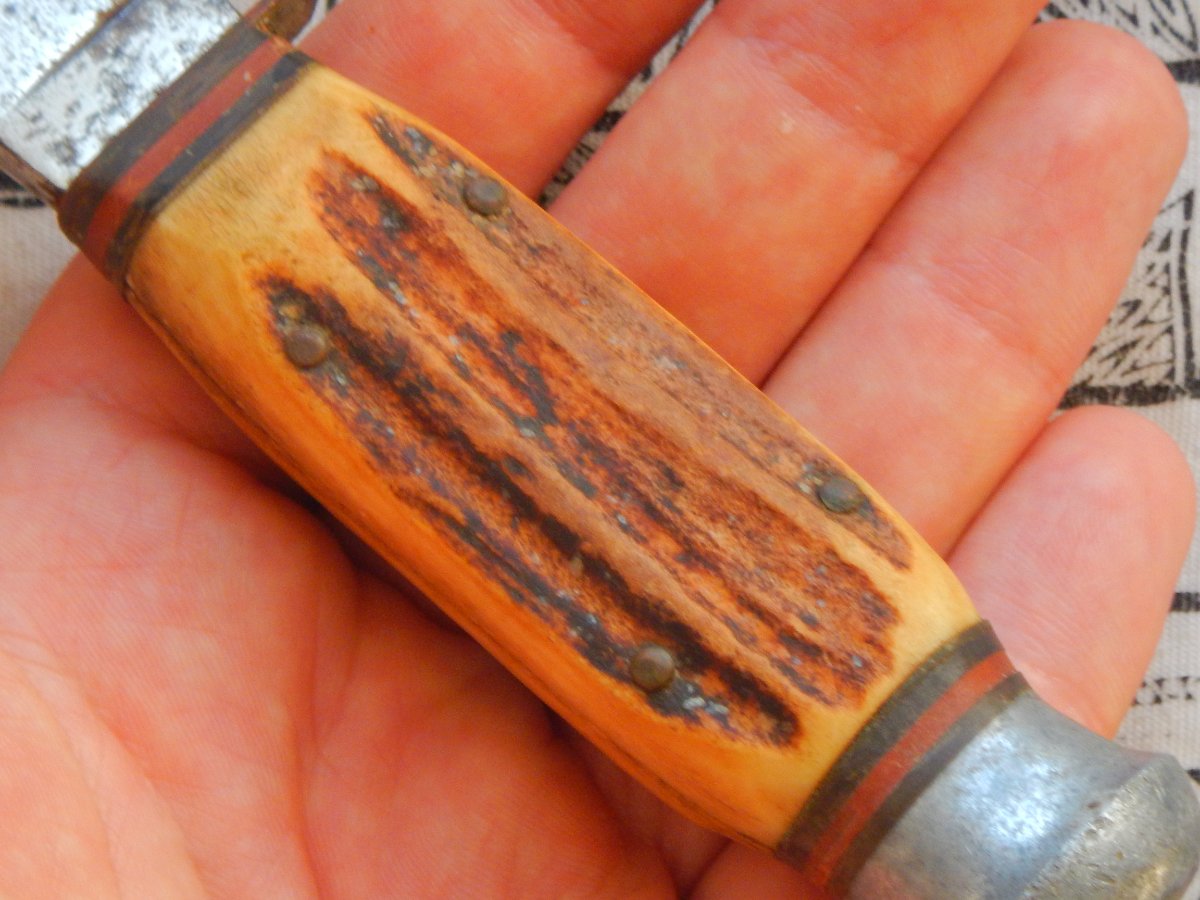

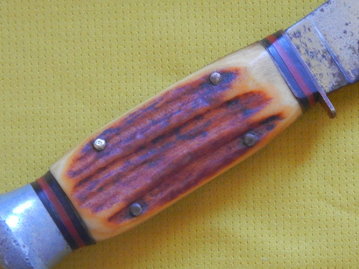

WillyCamaro
Posts: 6186
Re: Need help...
Post by WillyCamaro »
Thank ya mate's for all the tips/advice/idea's, lot's to take in, so better get cracking at it. ::handshake:: .

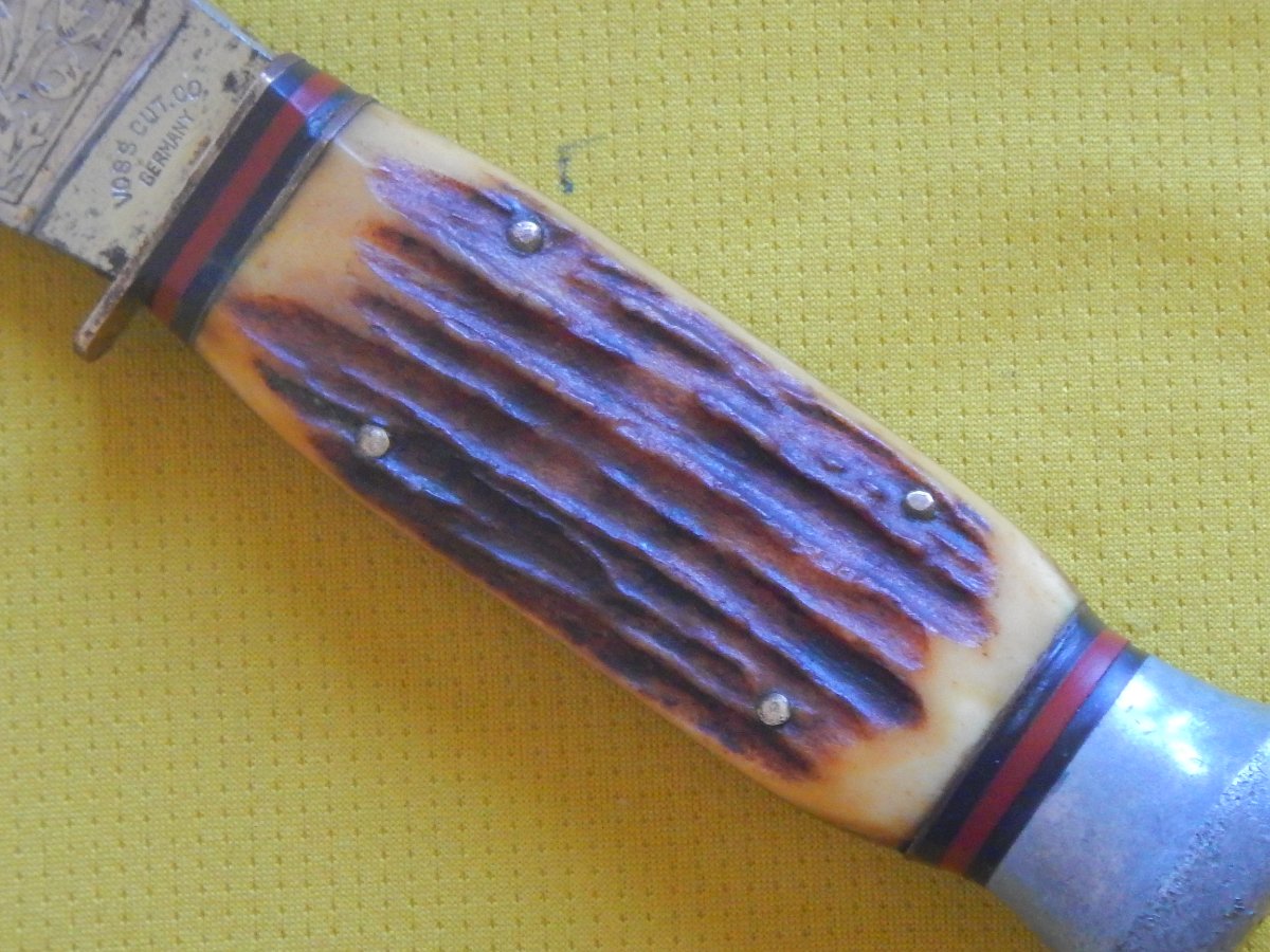

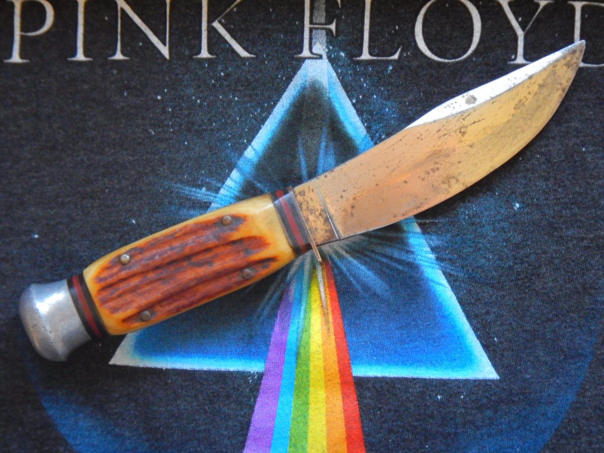

Here's the progress i've made so far, this afternoon.
Stag cleaned up wonderfully, better then I hoped for ::super_happy:: . Even did a little weathering on it, surprised how well it turned out.
For my first try cleaning up a fixed blade, came out far far better then planned.
::ds::

That does look much better!

Yes sir! That looks much better for sure!

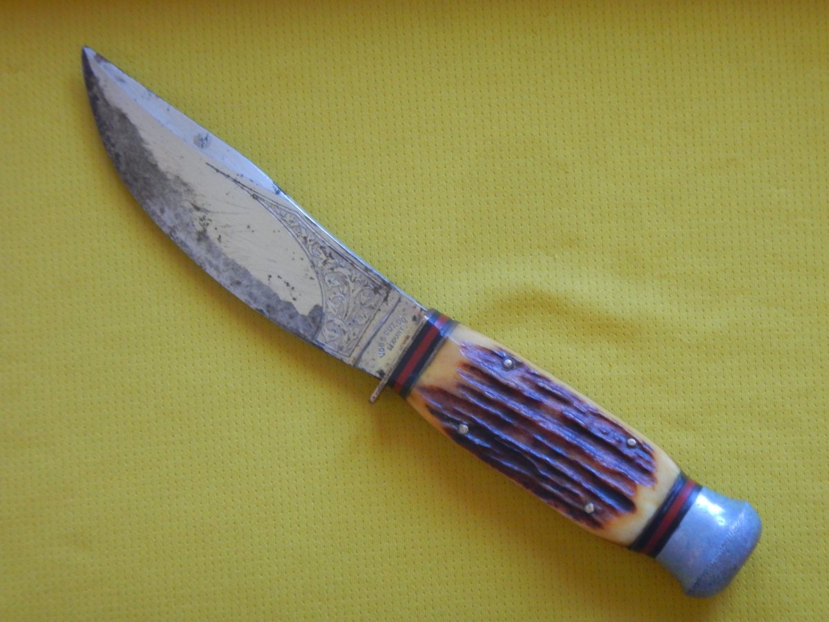

WillyCamaro
Posts: 6186
Re: Need help...

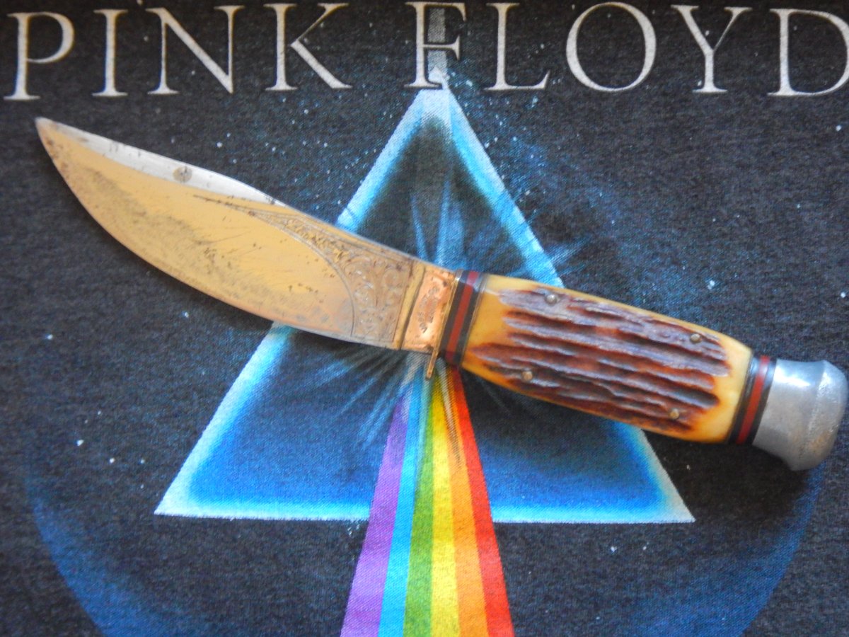

Hey Mates, I finished cleaning her up this morn, whole project turned out phenomenally better then i hoped for, expected. Yippie! ::ds::
Even my Mom, who's absolutely not in knives, thought I did a wonderful job, thanks Mom!
Enjoy.

I think that you managed to find that balance between doing too much, and leaving it a hot mess.
That was a fine line, but I think you walked it well.
