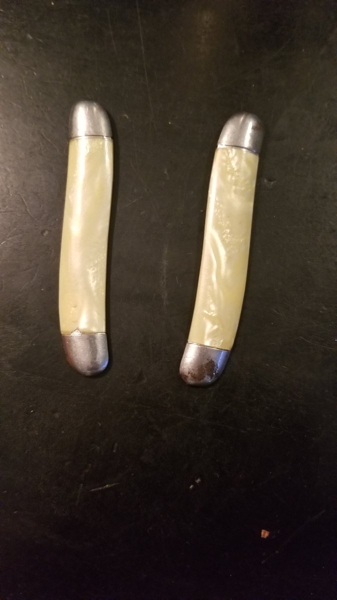

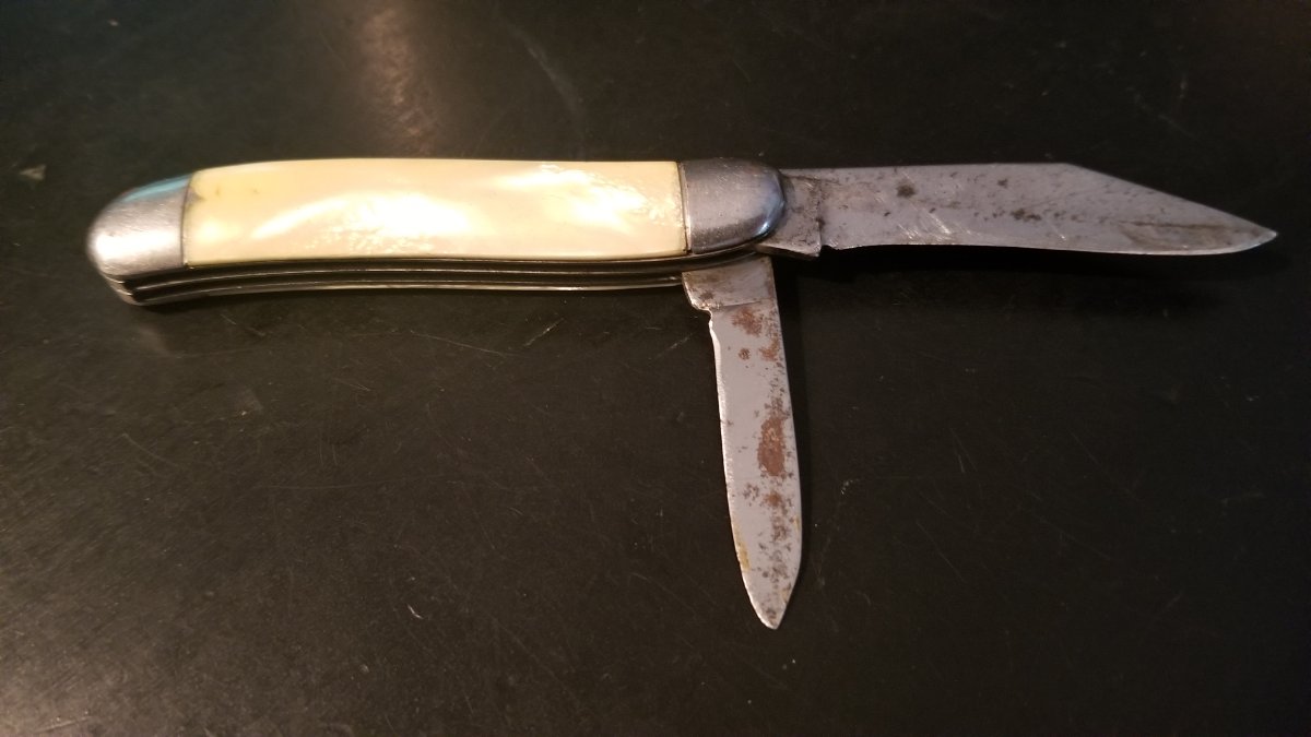

Thanks in advance for any assistance. I know nothing about knives or knife restoration but want to learn.

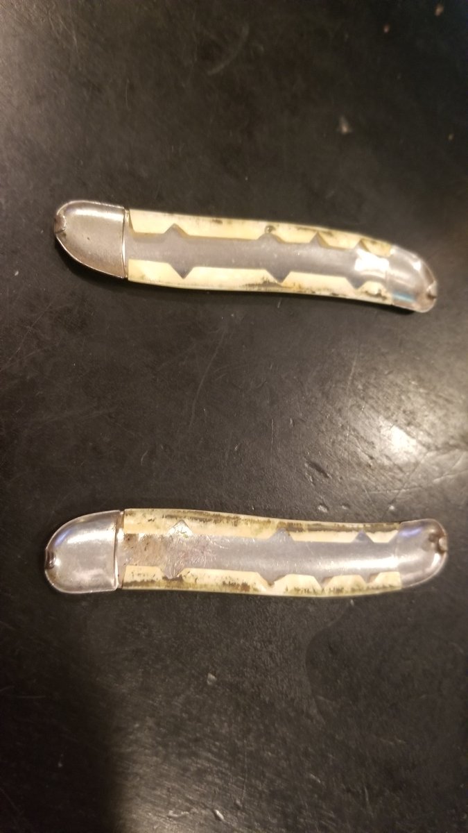

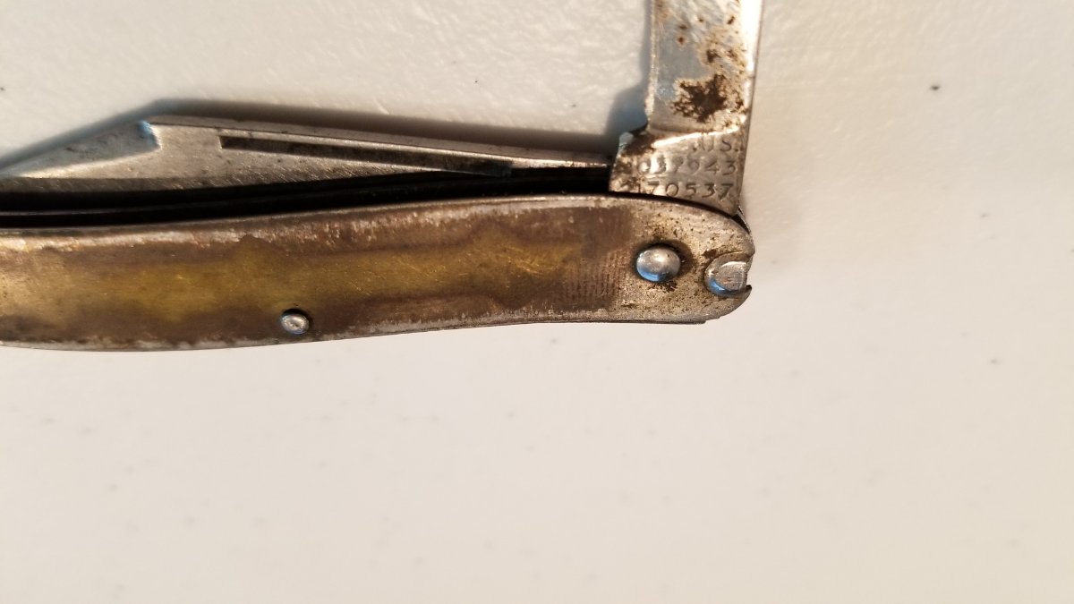

I found this knife in an old toolbox I was given by my father(he doesn't remember it so it doesn't hold a lot of significance so this is all about learning). As far as I can tell, it is a Hammer Brand from 1938-1941 (photo below). The handle is pearl-like with a couple chips missing. It is dirty and has some rust (photos below).
I want to restore it. Today, I tried to remove the scales and was surprised to find that it doesn't have normal scales but what seems to be celluloid wrapped around metal.
Any advice or correction is appreciated. :)
My questions are as follows:
1 - What is the best way to clean up the blades? If this were a hand tool I'd be hitting it with a wire wheel then steel wool. I'm guessing a blade needs wet sanding and buffing/polishing.
2 - What is the best way to clean up the other exterior metal? (fake bolsters and edges)
3 - What is the best way to clean the slots that the blades reside in? How can I get into the deep slots?
4 - What should I buy to re-wrap the handle and how can I do it? I've found celluloid but am guessing most of what I've found is too thick. If I use celluloid, do I form it with heat?
Thanks for your patience!

::welcome:: to AAPK! Since I'm more of a traditionalist, I would just remove the rust and oil the joints, then reassemble it as it was. ::nod::

The question “how do I clean my knife” is probably the most frequently asked of all questions here. You’ll find the answers about cleaning the blades, the blade wells (what you called slots) and other parts can be found here: viewtopic.php?f=37&t=54157
Replacing or repairing the handles is another entirely different topic. I’m not sure what can be done with the ones on your knife, which are called “shell” handles. You’re correct that they are metal covered by a thin layer of celluloid, which is an inexpensive knife handle technique. Others may have some tips for that.

I've never seen a thin veneer of celluloid replaced, on the original cover. I've see "Shell conversions"...which are very involved repairs. Search "shell conversion", in the SEARCH feature that is located on the top left, in the Quick Links. A new member just did a replacement, without bolsters (the metal ends)...on this post. This would be a much easier approach to handle replacement.

Here is part of the process of removing and discarding the shell overlay...then fabricating a solid nickel-silver bolster...it's much more involved; than, just covering the handle in a solid material as the link I posted above.

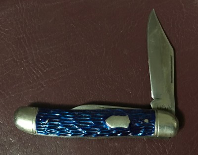

Here is an Imperial knife that I cleaned up. I cleaned up shell handles with steel wool, then painted them. Nothing fancy, just Testors model paint. Some people use nail polish.
I lightly sanded these blades by hand with 800-grit sandpaper, and cleaned the blade well (where the blade sits when closed) with Q-tips and oil. I have sometimes used an Emory board in them, but those are pretty coarse and leave some scratches.
I would not clean a knife that is antique, rare, or had collector's value. But I am okay cleaning and polishing a common and inexpensive knife like this. These are made with great blade steel, and make good EDC (Every Day Carry) knives!

Nice job, exactly what i would have done, reverand.

Love that blue you used. Really highlights the knife. ::tu::
