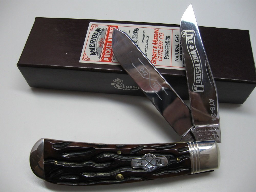

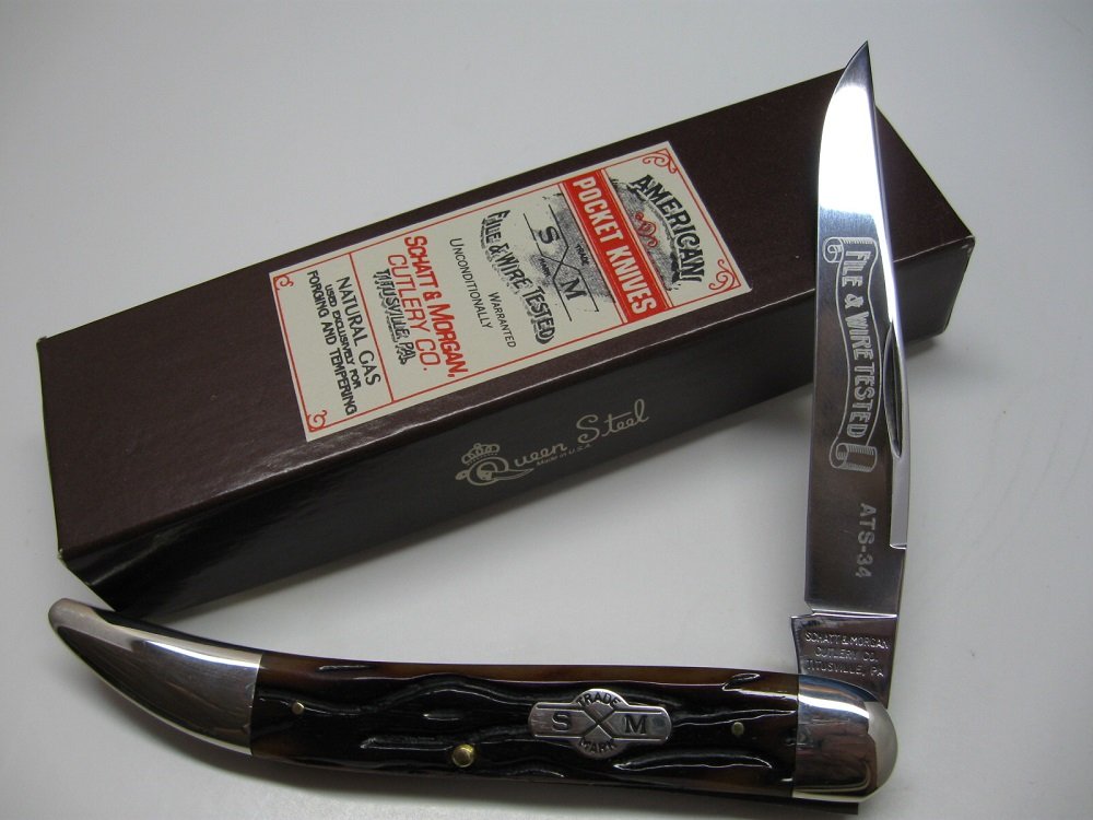

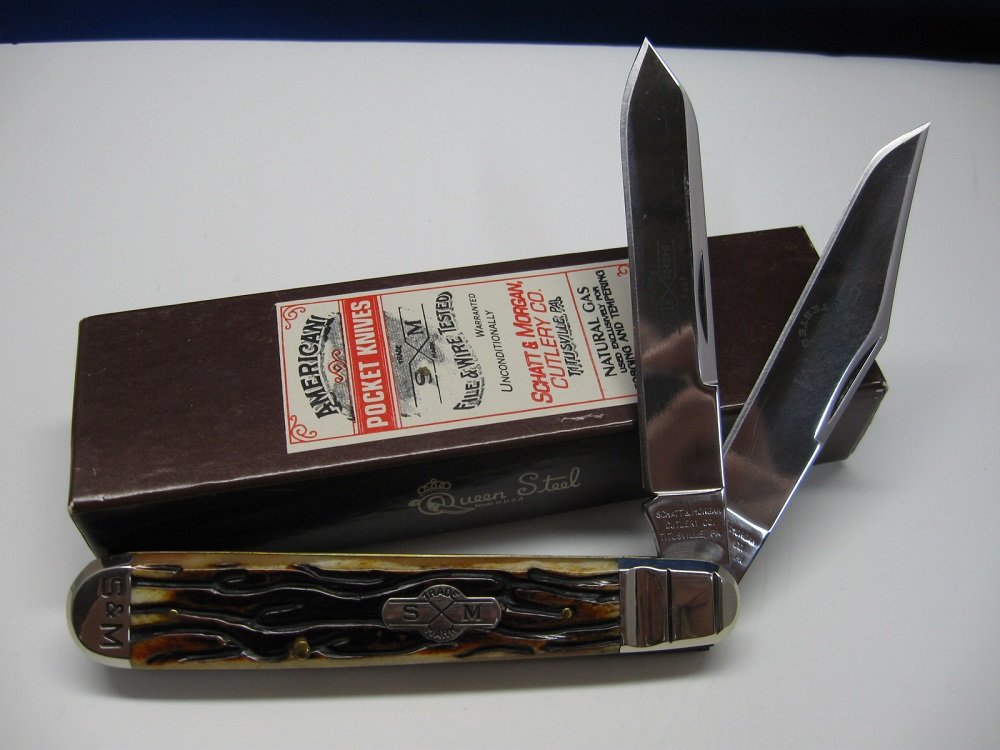

There were 5 patterns in Series #1, I believe each pattern was only produced for 6 months before moving on to the next pattern. The Hunter was the only knife not offered in ATS-34 but rather 440C or 420HC depending on who you talk to. All 5 patterns in Series #1 had Brunt Red Worm groove jigged bone covers, nickle silver bolsters and a Saturn shield.
Folding Hunter, Pattern #041883 The 2nd knife is a Clip point swing guard Lockback...... #04111L
The 3rd knife is an English Jack.... #042229 The rest to follow...
Dave

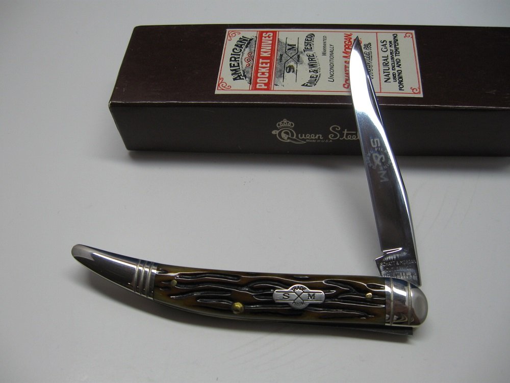

4th knife is a Swaybelly Trapper #042101
Dave
5th and last knife of the 1st Series is a Toothpick #041120
The second series next! Dave

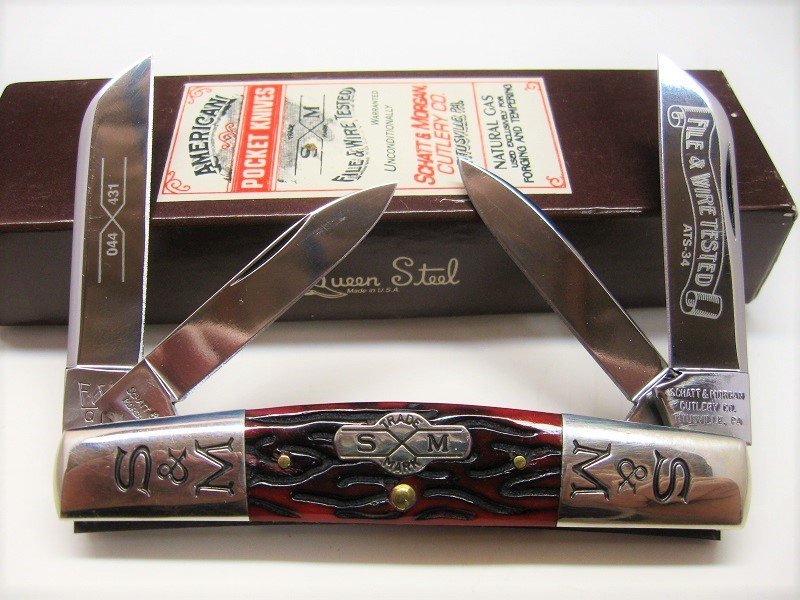

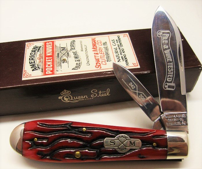

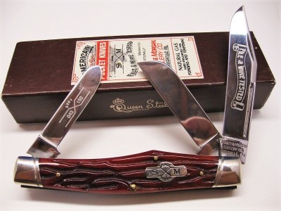

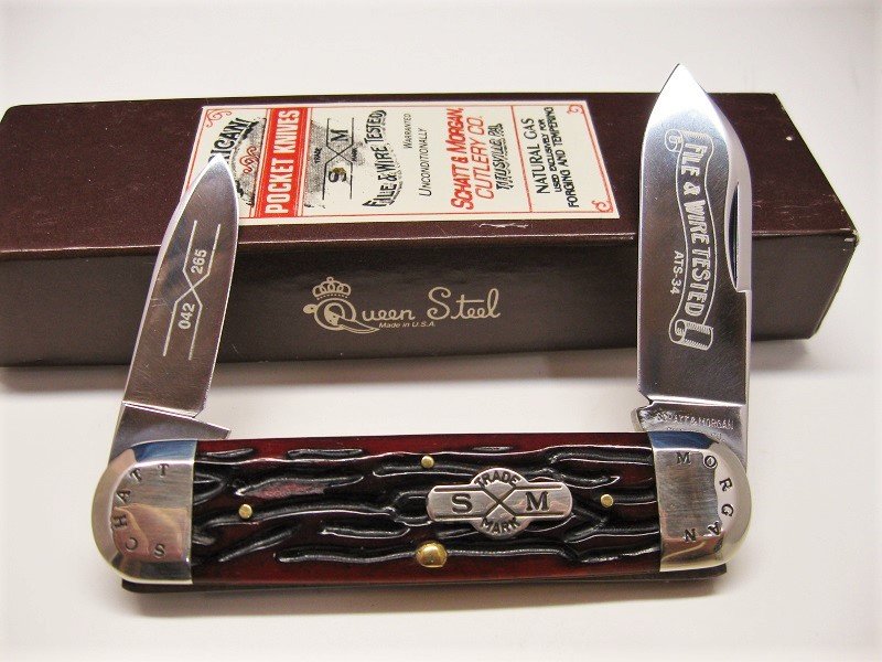

The Second Series also had 5 patterns. They all have brighter Red Worm groove jigged bone covers, not burnt like in the 1st Series. Same S&M Saturn shield, N/S bolsters, ATS-34 blade steel. My pics are pretty dark, the bone color shows up best on the Teardrop.
1st knife is a Reverse Gunstock Stockman #043150 2nd knife is a Teardrop Jack #042206 3rd knife is a Signature Bolster Congress #044431 4th knife is a Spear point Swing Guard Lockback #04121L 5th knife is a Signature Bolster Sunfish #042265
Dave

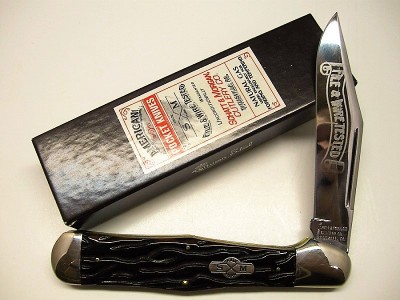

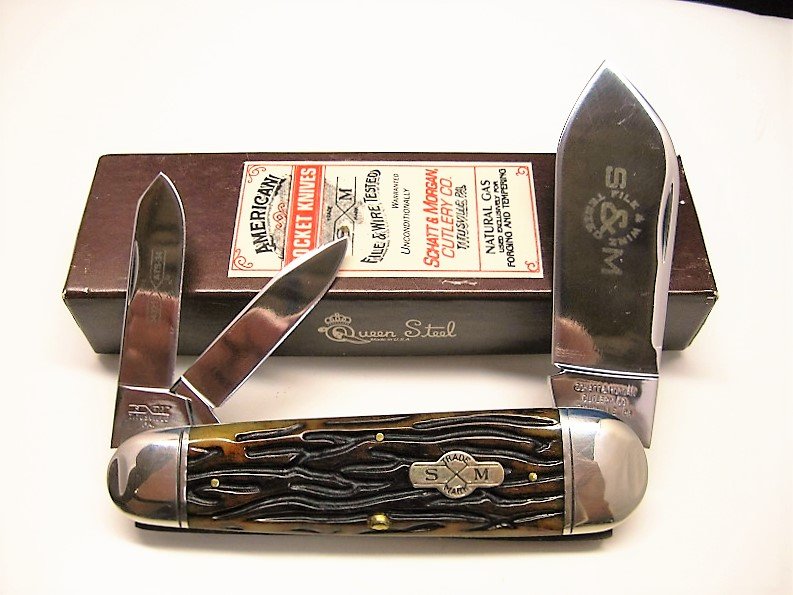

The 3rd Series also had 5 knives, they sport Goldenroot Wormgroove jigged bone handles, Saturn shield and N/S blosters.
1st knife Queen calls a "Mountain Man" it is a lock back #04113L 2nd knife is a Signature Bolster English Jack #042129 3rd knife is a Gunstock #041140 4th knife is a Sleeveboard Whittler #043213 5th knife is a smaller Toothpick than was released in the 1st Series. #041812 Dave
