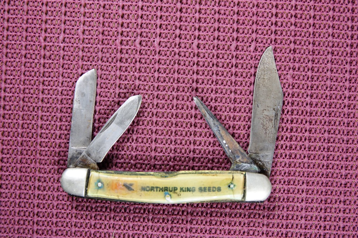

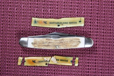

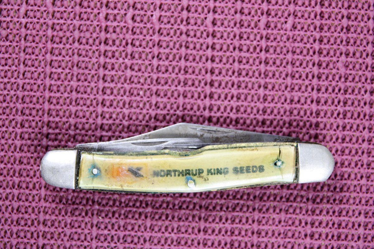

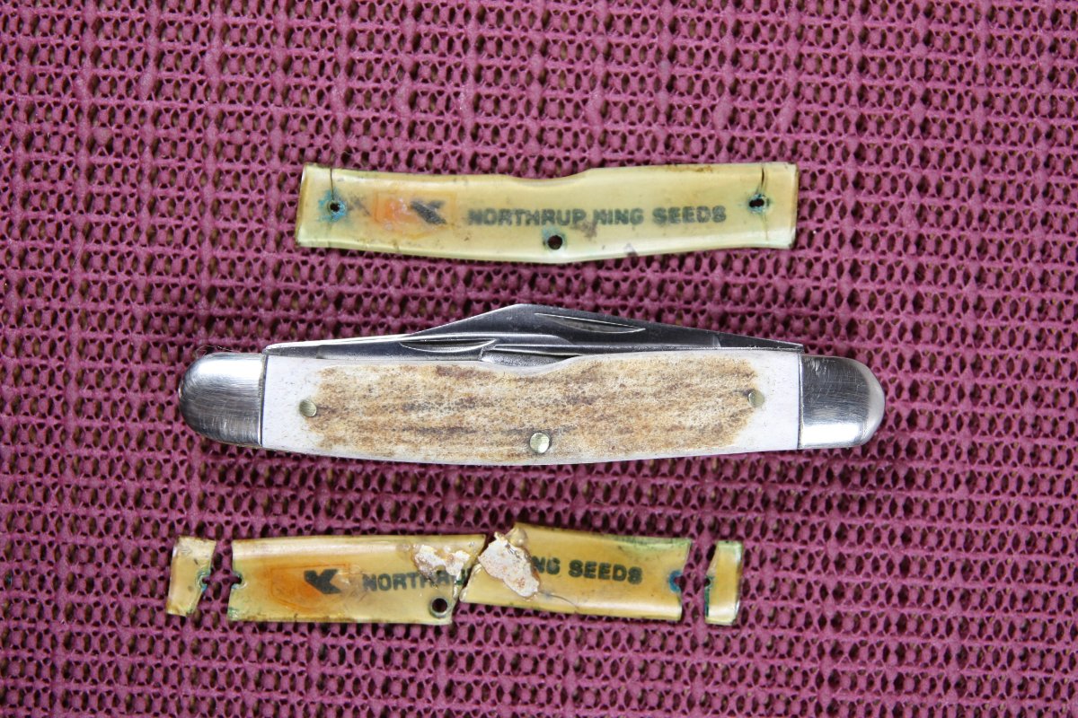

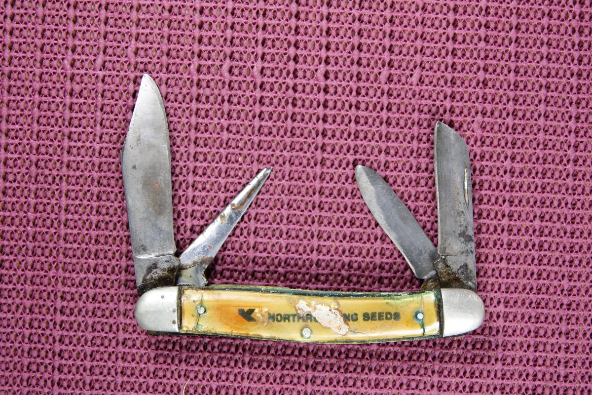

I just got this 4" Kutmaster 4 blade stock knife at a gunshow last weekend for a one dollar bill, but decided I wanted to get at this right away and get the old celluloid covers off. As you can see the seed corn advertiser covers are in real bad shape from shrinkage and cracking. Upon checking the handle material inventory I had, I found a pair of stag slabs would work out OK as far as size is concerned. The stag is a little bit light in color, but they match fairly good. This old knife has had some bad sharpening techniques applied more than once, but there is still enough to make a good EDC out of it.
Before

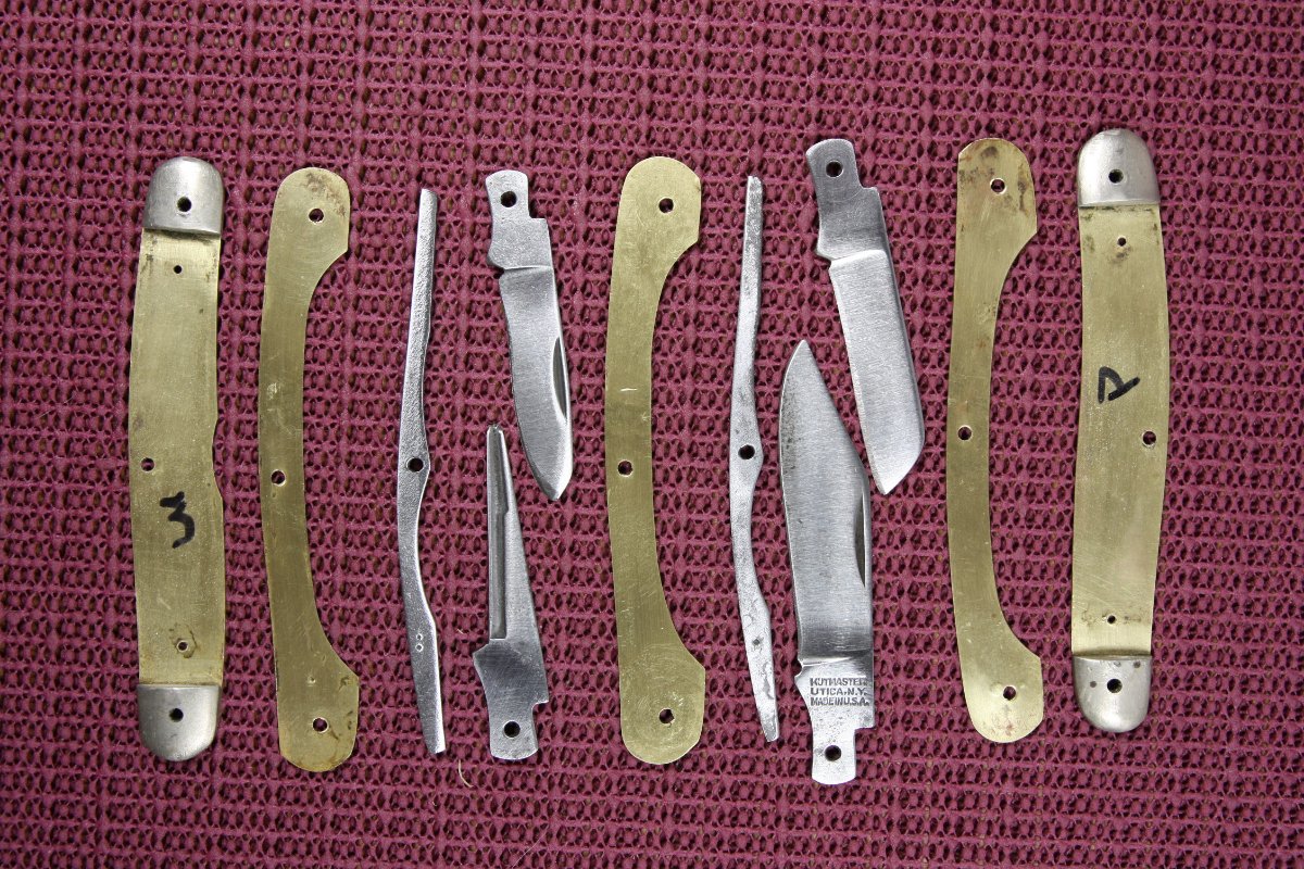

Parts all cleaned up and ready

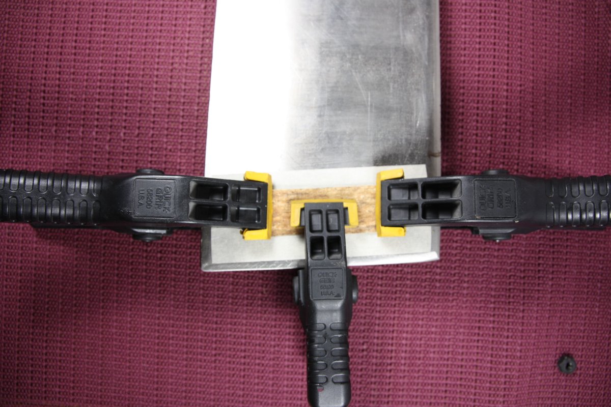

Clamping the new handle material while gluing to a piece of 3/8' stainless steel plate to keep everything flat

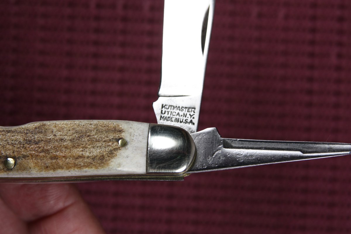

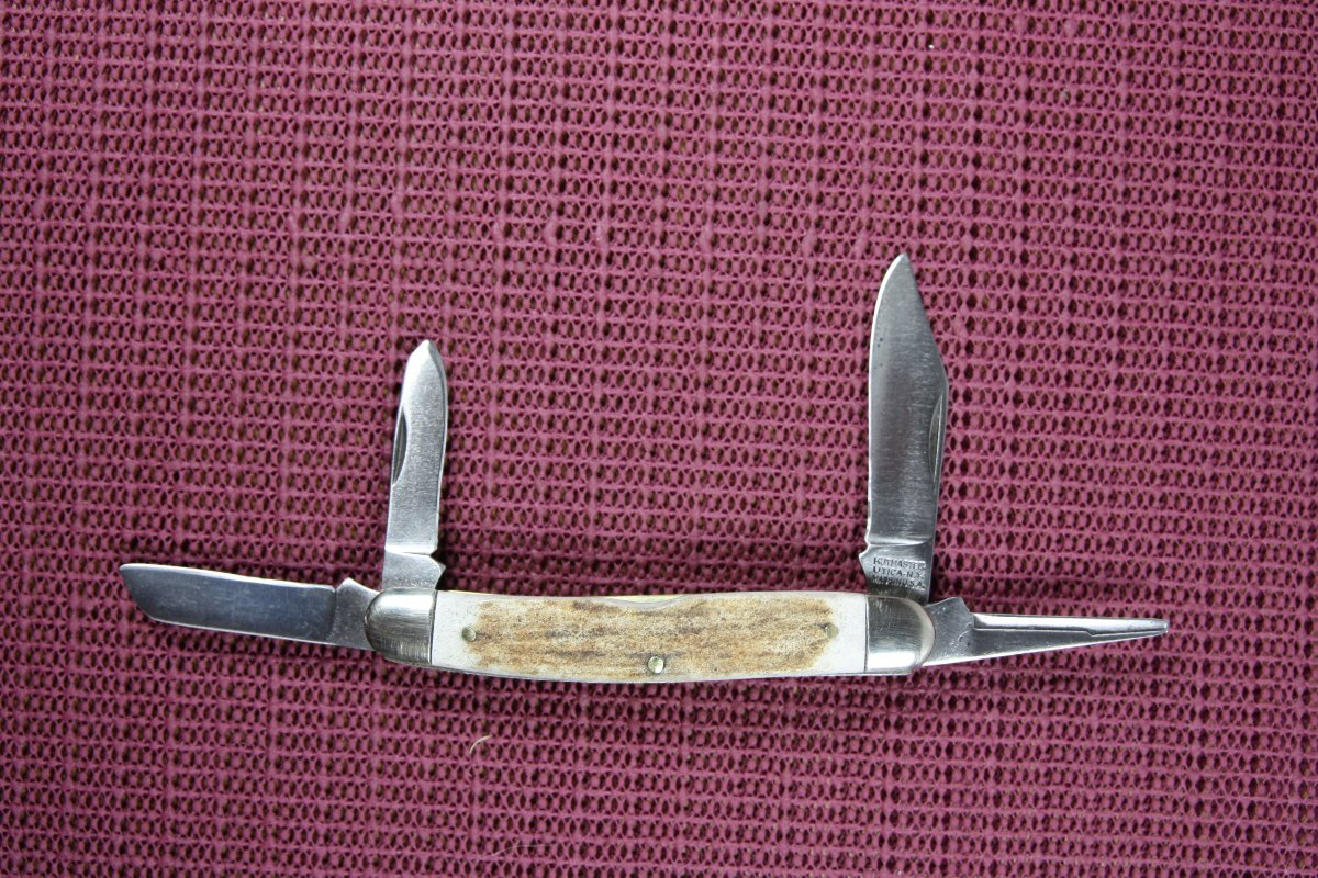

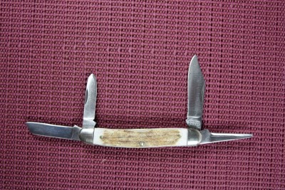

All done

Hard to believe it is the same knife OC. Excellent work. I like the handles, they look good while being almost understated. Great work as always. ::nod:: ::nod:: ::tu:: ::tu::

That long settles a question I've sort of had mostly due to bad eBay photos--it is a two-spring knife. I always thought due to four blades, it was a three-spring knife. '
Stag looks great on it! Now to get one of these knives finally and get the Mother of Toilet Seat off and replaced with something else.
OLDE CUTLER
Posts: 5670
Location: South Dakota
Re: Kutmaster 4 blade stock knife
Post by OLDE CUTLER »
cody6268 wrote: Fri Mar 13, 2020 3:08 pm That long settles a question I've sort of had mostly due to bad eBay photos--it is a two-spring knife. I always thought due to four blades, it was a three-spring knife. '
Yes it is a 2 springer. I have a 3 blade Kutmaster stockman which is newer than this one. It is delrin handled, and the tangstamp is the same lettering, but a smaller font. This is the first 4 blade stockman I have. The steel in these Kutmaster knives seems to be of good quality, this one took a real good edge.
