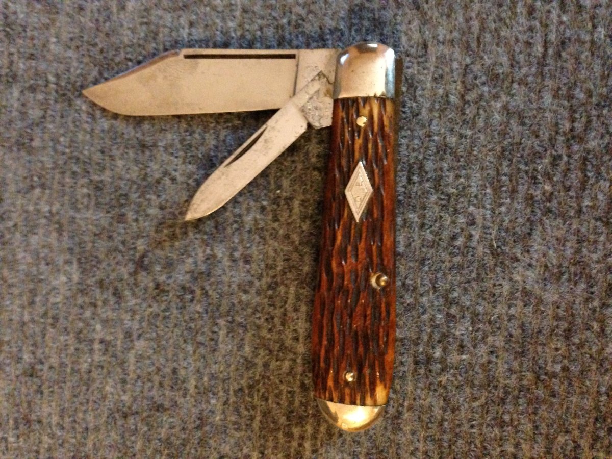

How to remove a finger print from a blade? This knife has never been sharpened. I don't want to use an abrasive. Harold

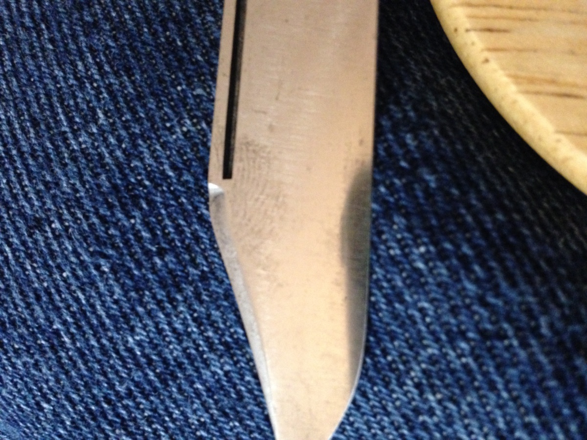

Steve this is really set in, probably been there for decades. Simichrome did nothing I am hoping someone has magic cure. Harold

You may have to keep polishing over and over to get it out. I was once told that every time I polish a blade, it removes microscopic traces of metal. You may have to remove just enough metal to get that print off.
Can you take a close-up photo so we can see?

Mnay folks have overly acidic sweat, which will cause an acid etch of their fingerprints in steel. This happens surprisingly quickly, within a matter of hours. It's one reason why you see a lot of sellers at knife shows wiping down their blades after each person handles a knife. We had a guy at the knife shop who wasn't allowed to sharpen the 1095 bladed knives for this very reason. The first time he did there were etched fingerprints on half the blades, and every knife had to be re-buffed.
Harold what kind of knife is that? Is it a mirror finish?

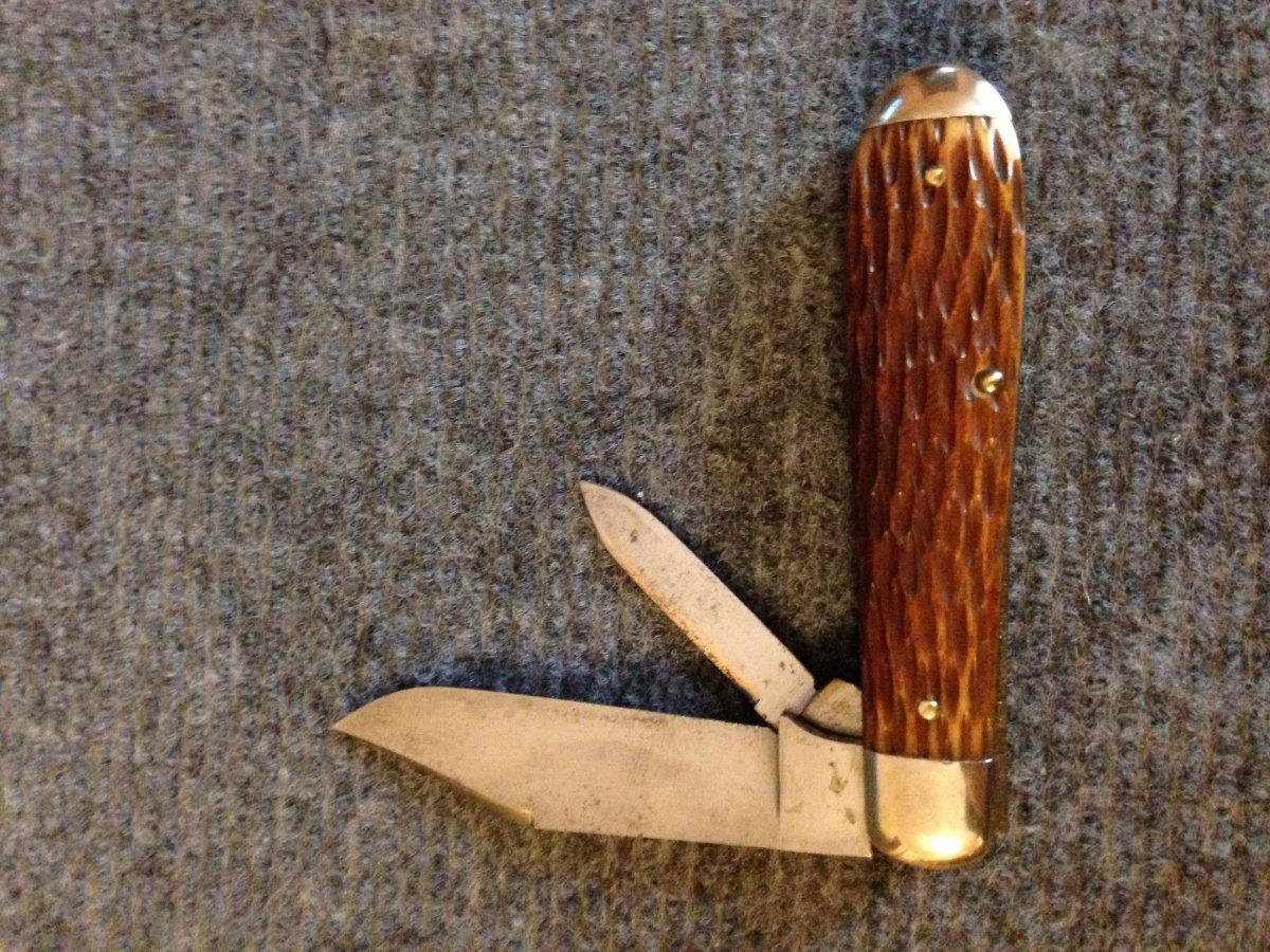

The knife D-E I think Sch Cut Co. Maybe Walden? Will try to get the wax.
