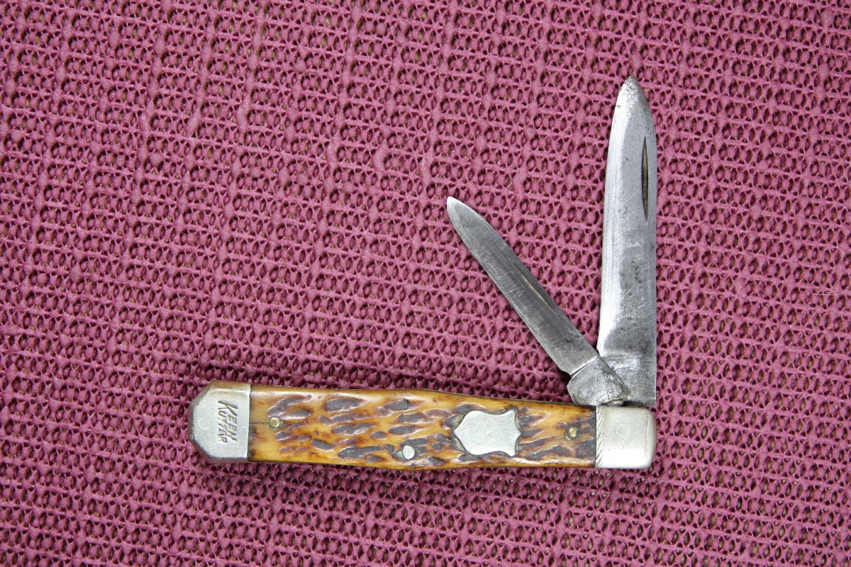

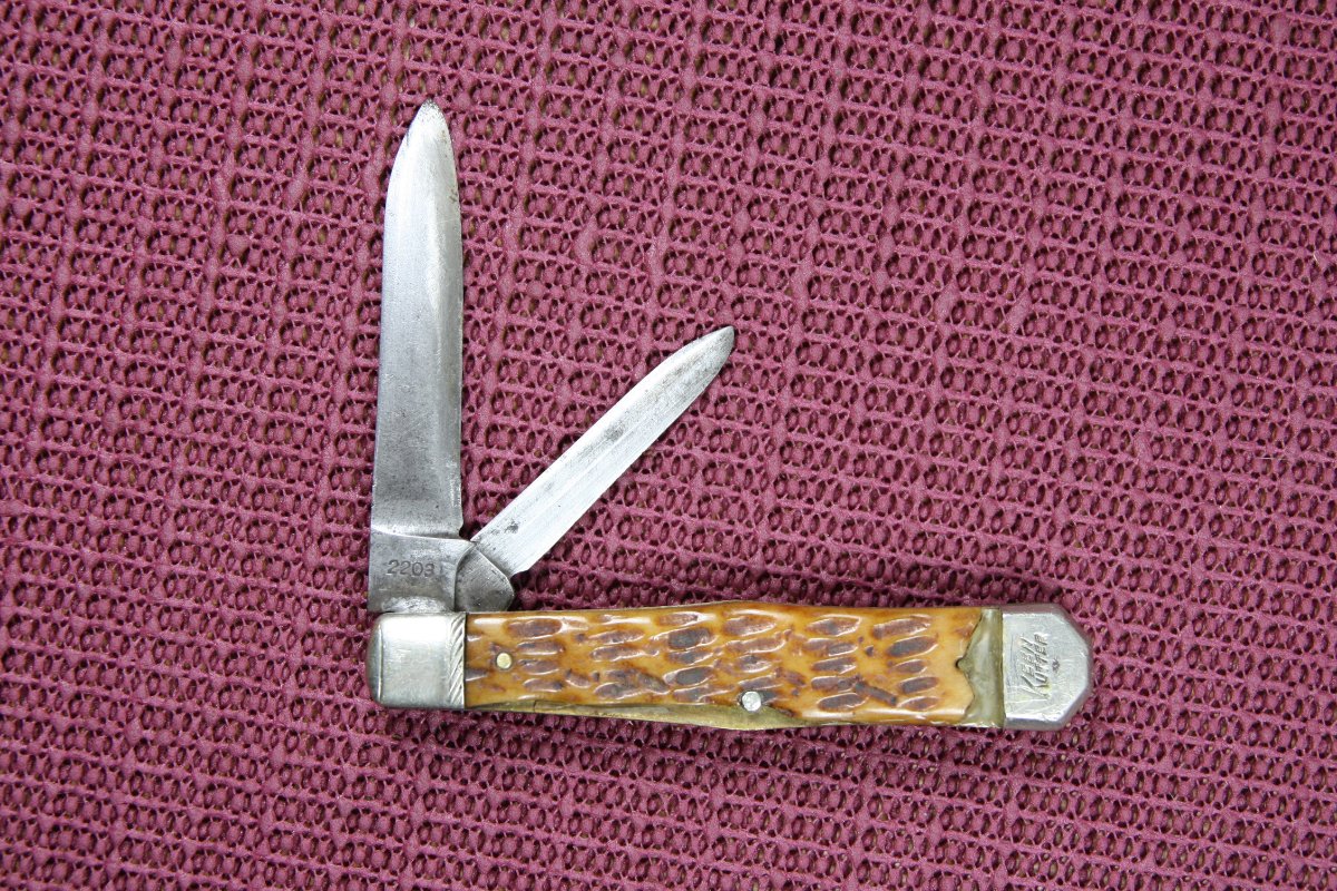

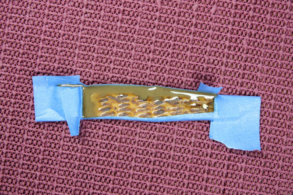

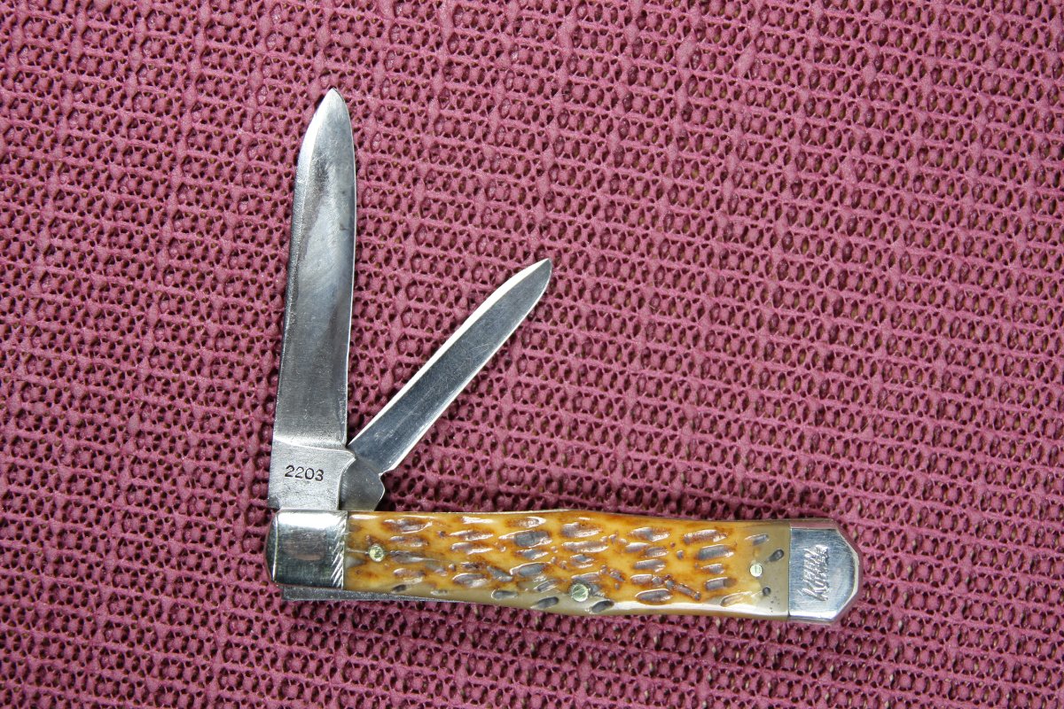

I found this 3 1/2" Keen Kutter coffin handle jack at our local fleamarket a while back, and just got it back into shape for EDC. It had a broken spring on the smaller pen blade, and some pieces of bone missing on the pile side cover. Some 1095 high carbon took care of the spring and the bone was repaired with Acra-Glas.
It has blade loss from sharpening, but still some left.
Broken spring

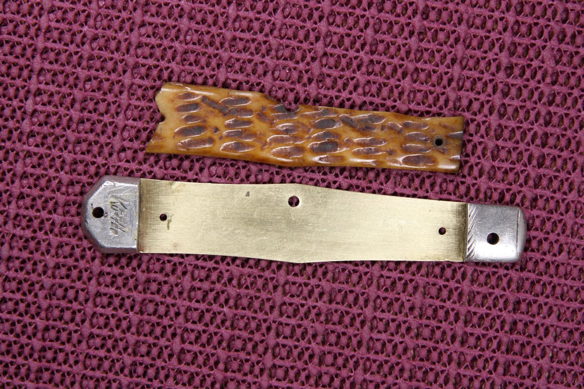

Pile side showing bone loss

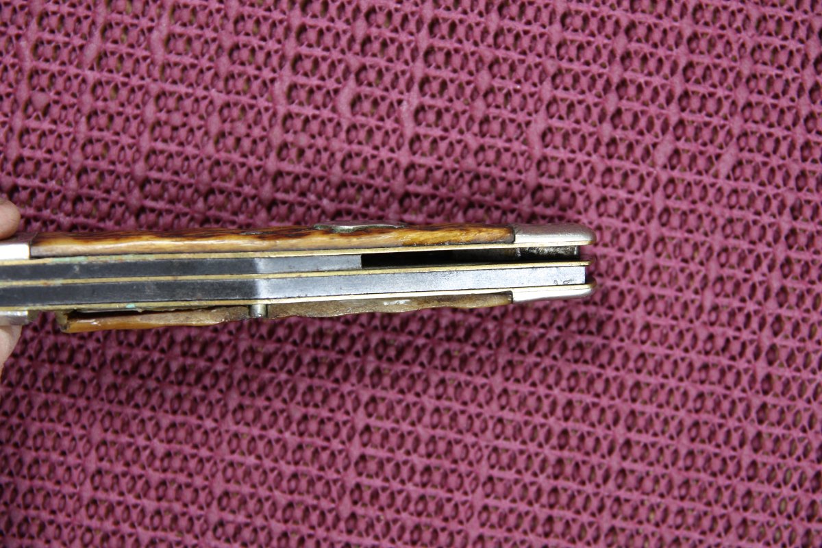

Acra-Glas repair to replace lost bone

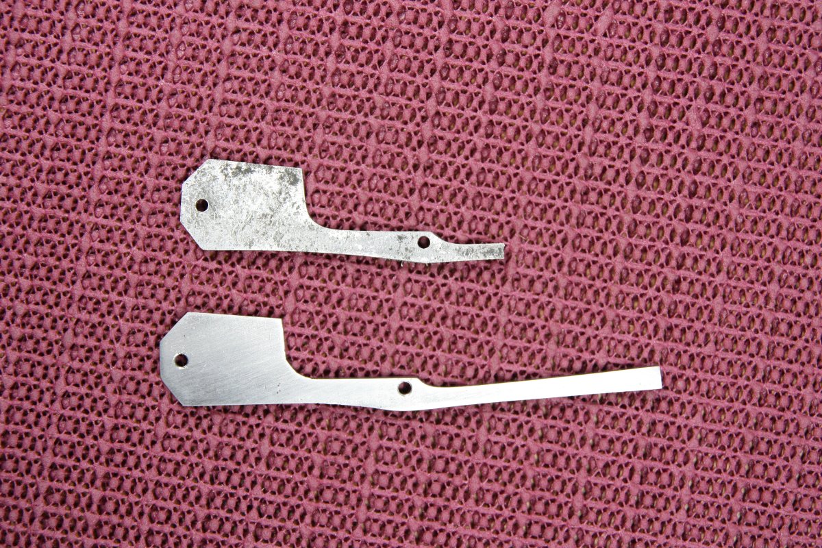

The butt end spring had a somewhat unusual shape, old and newly made replacement springs shown

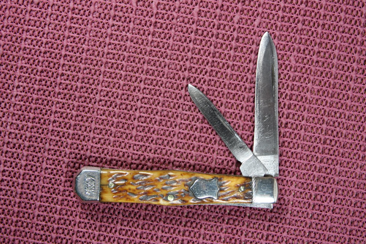

Back together
Pile side showning repair
There were some other cracks in the bone handle material, both front and back and this was stabilized by forcing cynoacrylate glue into the cracks.

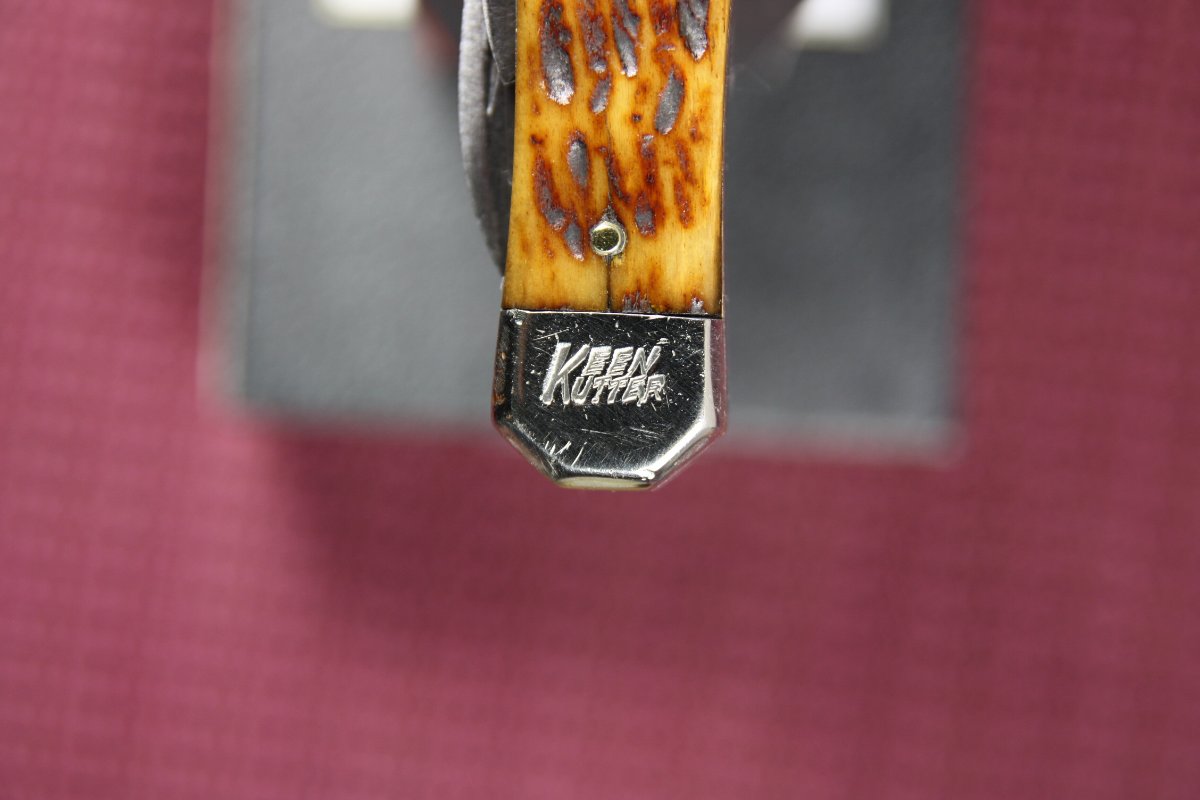

What I like the most about this Keen Kutter is the stamping into the bolsters and the coffin handle shape. Ready for EDC. It sure took a great edge from the Lansky, some good steel in this one.

Do you have any ideas as to why the spring for the pen blade is shaped the way it is? Kind of a combination spring, filler. that when pinned into the knife stiffens the whole unit?
I'm not sure if there was a mechanical reason for it. I do see this on some of the fancier knives though, I think it's like getting leather interior on your car.

Very nice work! I am especially impressed with the replacement spring that you made. I would really like to hear about how you go about doing that. ::tu:: ::tu:: ::tu:: ::tu::
