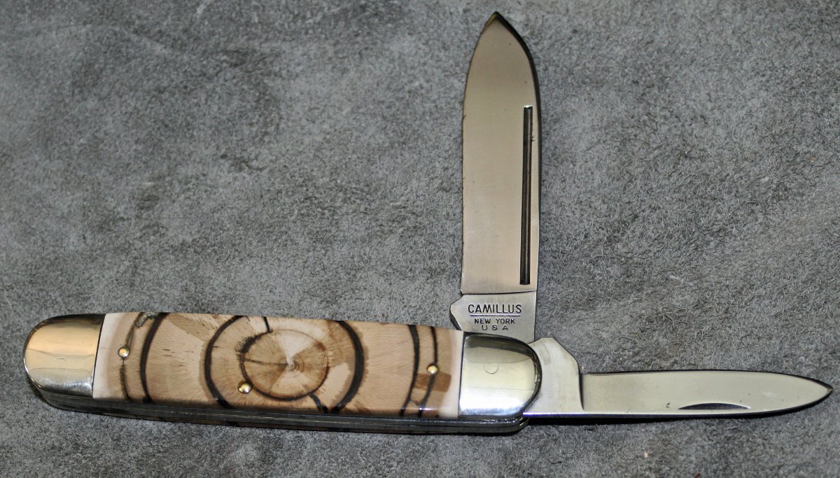

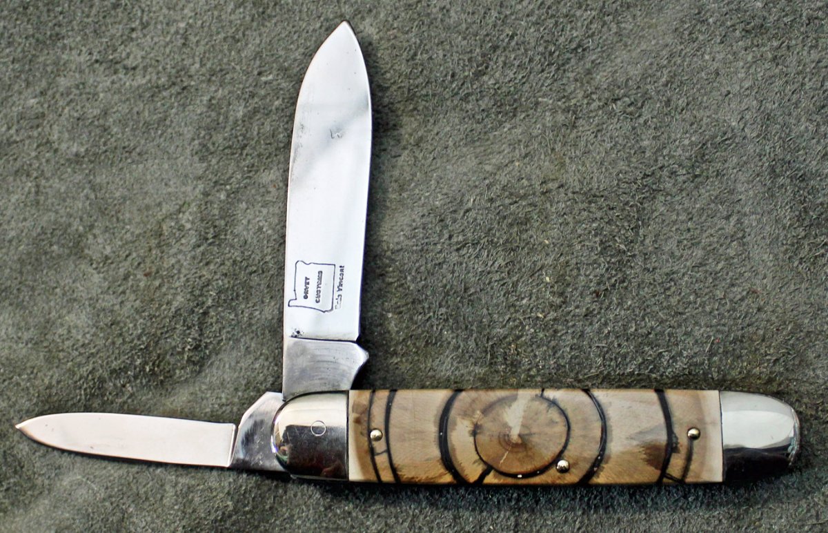

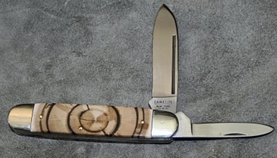

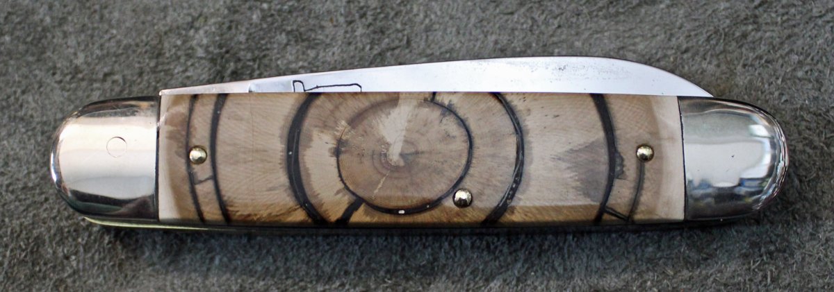

I found a nice example of a Camillus #23 and have kept it back until I can find an exceptional handle to put on it. I found such a handle at Blade Show West a couple weeks ago from Charles Turnage. Stabilized cross grain mammoth ivory. I used the #23 because of the size of the handles that allowed me to put most of the Ivory on the knife.
The knife was not completely mint; you can see a few little pits in the blade. This type of handle material, according to Charles a Turnage, needs to be glued to a backing. In this case the backing I used was the brass liner, which he said was fine.
This was a painstaking build as I used every precaution not to break the handle, such as avoiding heating the ivory when sanding, using new drill bits when drilling it and gluing and taping the backside of every hole I had to drill.
I thought it turned out pretty good.
I hope you enjoy the pictures. I would love to hear what you think of it.
