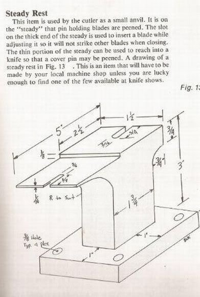

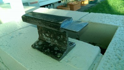

I also posted a photo of a stiddy I made from cane tram rail line. Wheni took the photo it was unfinished but I have since 'pulled my finger out' as we Aussies say and completed it.
While it is rail line it is very light line.
To explain further, it is a piece of scrap sugar cane railway track.It is abundant where I live in the sugar cane growing area of Central and North East coast Australia.
Its construction was dependent on owning a band saw with a good blade that cut and having a mate with a mill who cut the top deck and sides to make it look nice.All cuts bar the top were made with my 6x4 bandsaw.

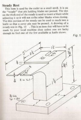

I'll take a pic of the finished one buy meantime if it helps, here is a drawing from the net.
Ozwelder
