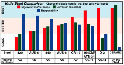

The A.G. Russel chart shows ATS-34 & VG-10 with about the same amount of carbon (hardness). The VG-10 contains Vanadium & Cobalt which the ATS-34 does not. I was told Vanadium makes the blade "tougher", as in edge retention. VG-10 has a little more chrome, so it would be more stain resistent. I have no idea what the cobalt does. Only 3 of the 36 steels listed contained cobalt. Hope that helps a little.

This is only my opinion, but I think A.G. Russell offers a very fine Steel Guide here.....
http://www.agrussell.com/knife_informat ... index.html
It helps in comparisons about the strengths and lesser qualities of the various compositions.

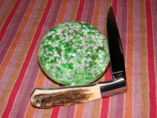

Thanks helps alot I picked up an older MOKI pocket knife MK-500A which is made from ATS34...I was trying to find / get a price check on it but it seems all MOKI knives are now made from VG-10 stainless and my model is to be found, now anywhere. I was wondering if the ATS34 is a better all around blade material than the VG-10.
Just a side note the quality of MOKI knives is top knotch and I'm looking at getting a few more.

MOKI Knives
Post by lenny357 »
That was fast the customer service in Japan is something I miss I served there for 12 years, my wife got the following info from MOKI knife Co.
VG-10 is the replacement metel for ATS 34 due to the expense of working it. They sill use ATS34 for there higher end lines. My knife is a MOKI MK-500A (Stag lock back) no longer made and when it was very limited (according to MOKI Co.). He also said that to produce a knife which is Stag and ATS34 would be much more expensive now than there current line of Bone Stag handles/VG-10 blades. This man has been working there for 12 years and has never rembered this knife going out/shipped so it's either old or very limited. The company man is now curious about the knife and is asking more senior workers in the company for more information (more to come). I tried to take a good picture but well need to practice ::dang::
