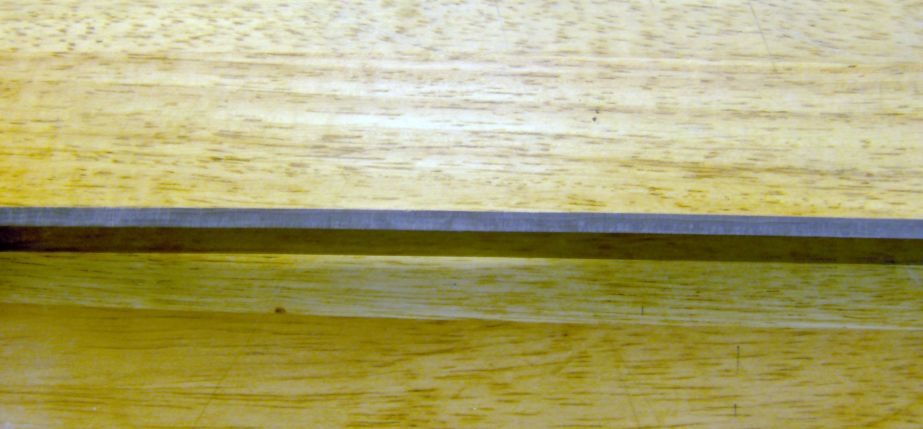

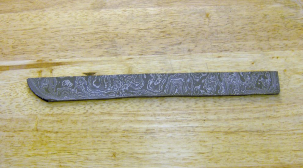

I was at the Parker show today and I trade and got a piece of Damascus that I would like to try and make a knife from. This piece is approximately 12" x 1 1/4" x 3/16". I would like to hand file it and I don't know what kind of file or where I might get a pattern to use for making this knife. I do know I will make a fix blade. I would like to be able to say I can make one of those before tackling a folder.
So question is , what file is best to use and where might I find a patter for blades so I can decide what I want it to look like.

Looks similar to Alabama Damascus, or one of there patterns.BamaFatman wrote:I was at the Parker show today and I trade and got a piece of Damascus that I would like to try and make a knife from. This piece is approximately 12" x 1 1/4" x 3/16". I would like to hand file it and I don't know what kind of file or where I might get a pattern to use for making this knife. I do know I will make a fix blade. I would like to be able to say I can make one of those before tackling a folder.![]()
