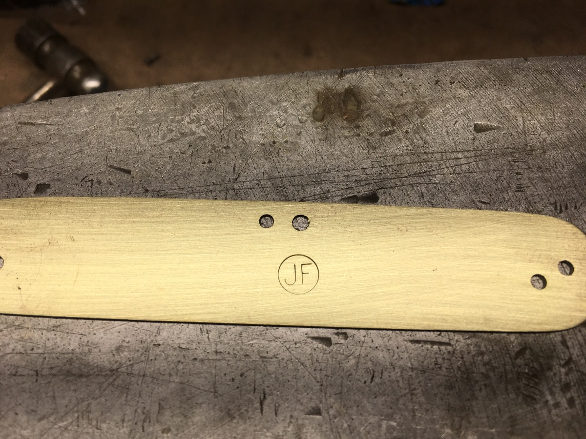

I’ve been using individual letter stamps to mark the liners of the knives I work on and decided to get something a little nicer. It works really well.

I looked at a lot of different ones and ended up ordering one from these guys;
http://columbiamt.com/CMT-Main/index.html
A little pricey and it took a couple of weeks to get it but I’m happy with it.

This particular one was their “off the shelf” sorta thing. You get a circle (available in different sizes) and you tell them what two letters to put in the circle. They do custom stamps as well but I couldn’t tell you how much they cost.

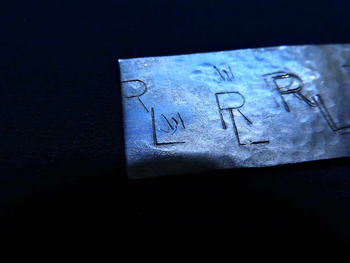

Fortunately, my initials allow me to file mine in a metal bar. No enclosed letters like B or O or D ect.
Mine are JW. My stamp is within the "L" on the left.
This little bar of steel is too mild, I assume, to harden it for stamping on anything harder than this copper.
I don't understand heat treating or tempering or steel in general.

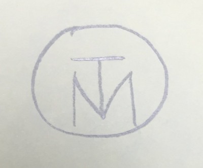

Very interesting Joe. Mine are MT so I might be able to swing a filed out shape. I'll have to think about that.

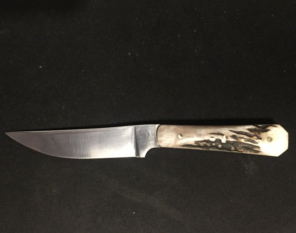

I have a request in for a stamp that looks like this......
I have stamped all my scratch made knives with a stamp set.
BUT... sometimes I cant seem to get the letters like I want 'em....

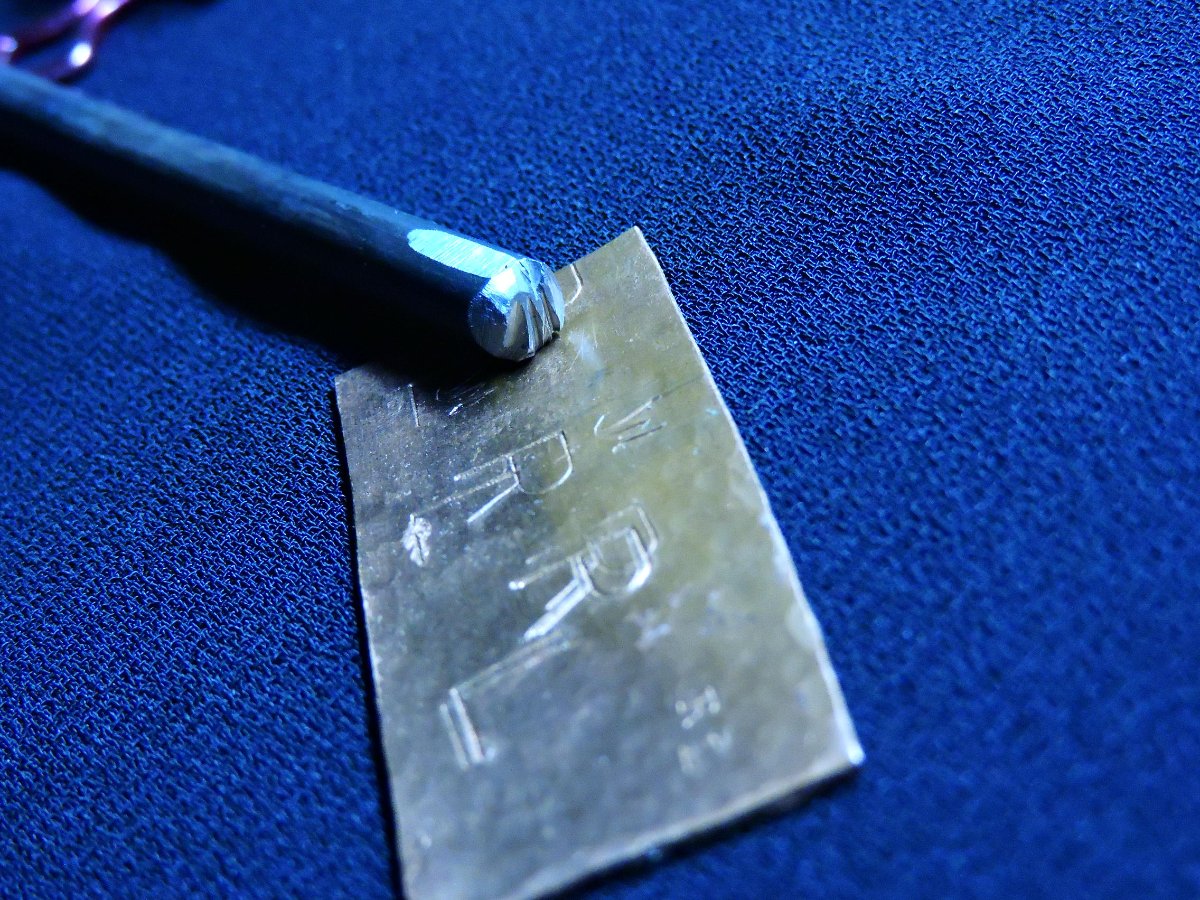

Meridian_Mike wrote: Wed Oct 23, 2019 11:46 am sometimes I cant seem to get the letters like I want 'em....
Thanks Mike.
I have used stamps from sets too for various things. They are not easy to line up.
That is a great looking fixed blade you have there.
Of course the letters have to be in reverse image.
Make your letters in reverse (not an issue with MT, lucky you) in the size you want them to be on paper.
Super glue image to end of prepared stamp and file away all but the letters.

Well.... my stamp is on the way.
I had to pay a little more than the $100 I was hoping for but If I just stamp liners it should last me.
I settled on the MT in a circle.
Thanks for telling me about the people you used for your stamp Jeff.
They are making mine.
::tu::

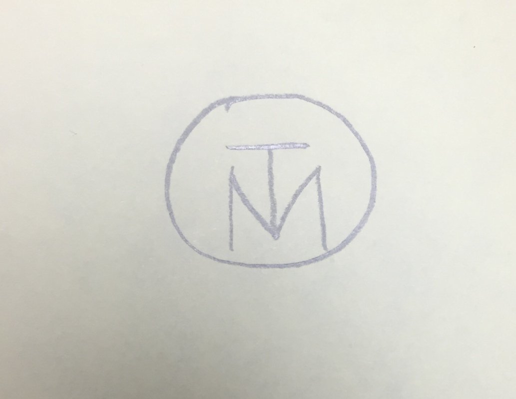

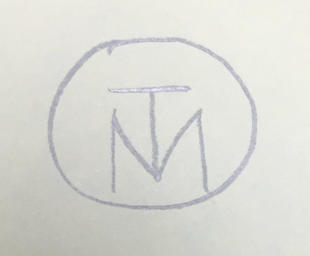

These guys are great Jeff. They just sent me a drawing of what my stamp will look like... For approval....
I wasn't sure if they were going to do that but they actually sent me 3 variations and I could choose one for the actual stamp.
Great people!
