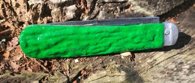

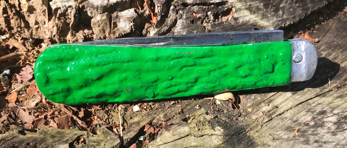

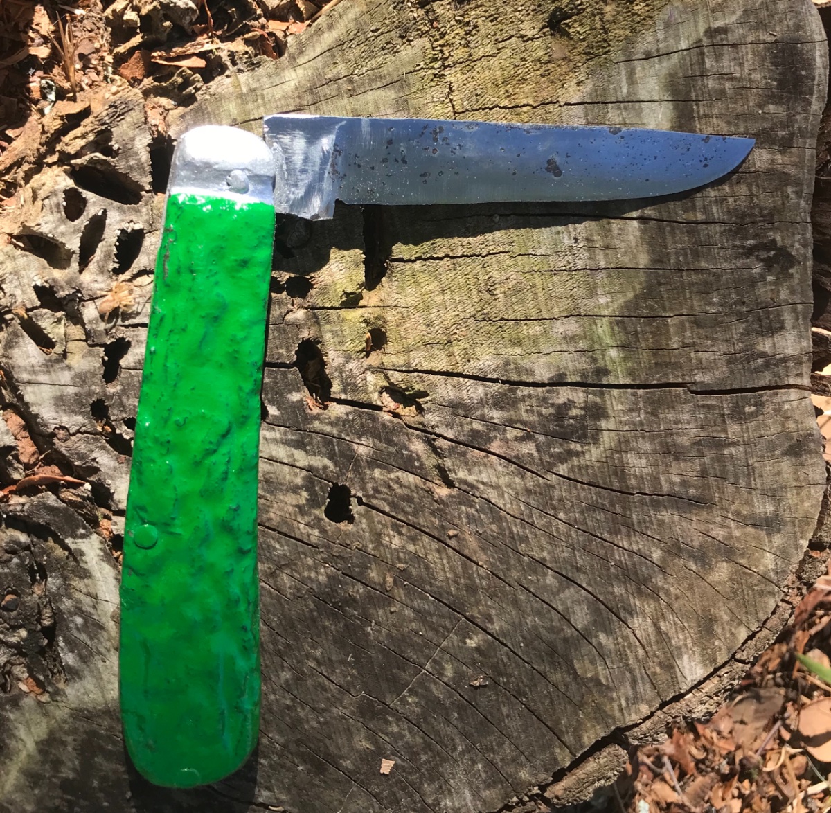

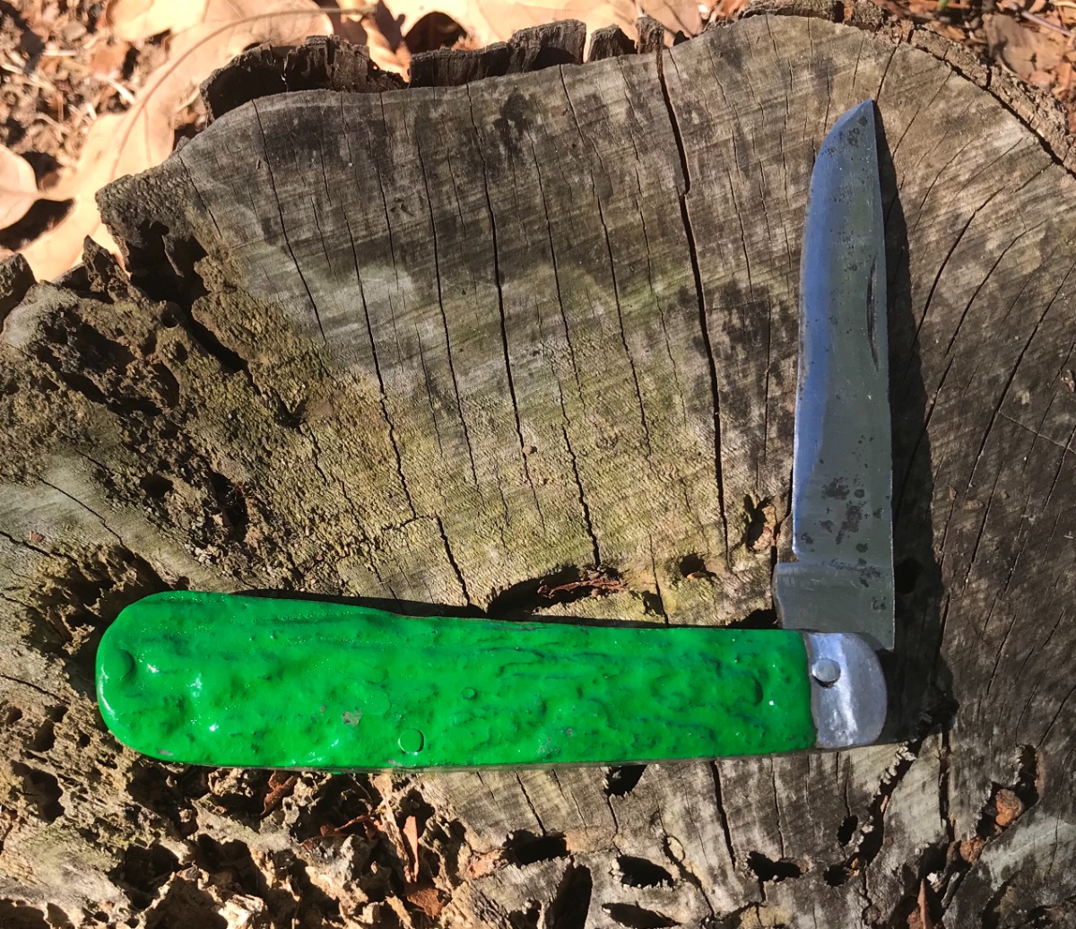

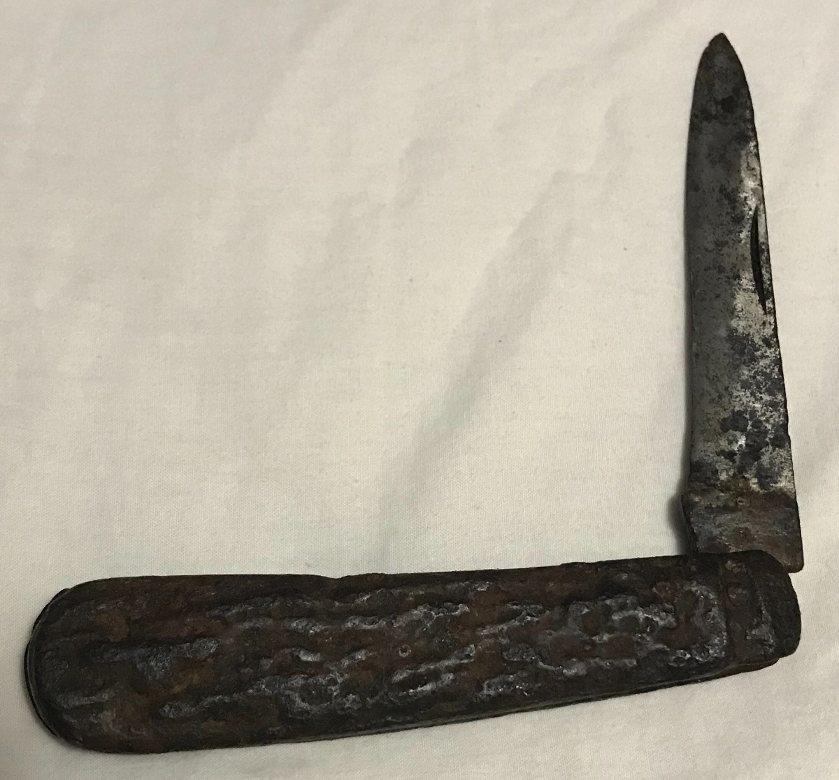

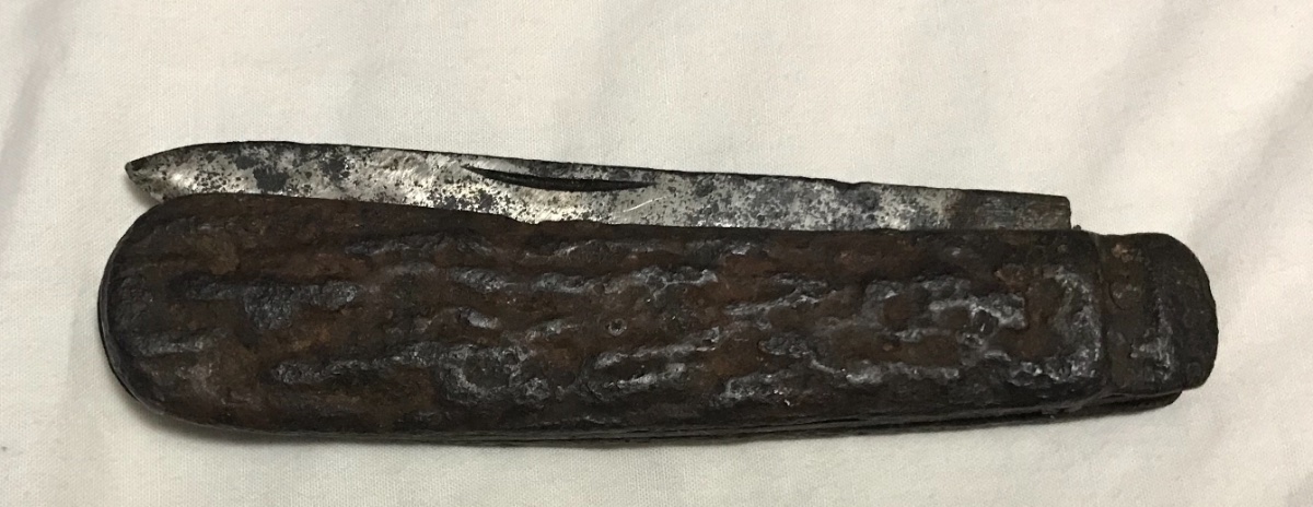

I had LOTS of fun redoing this old cast-iron knife that I found for $5. It looks like a cheap Boy's Knife, except it is 4-1/8" long closed. The blade is obviously not original.

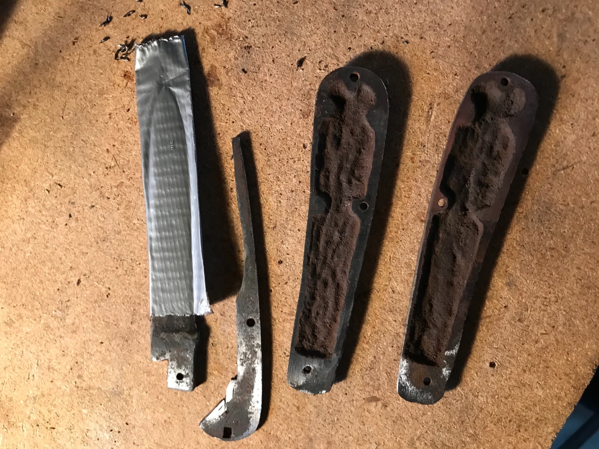

I soaked it in vinegar and used a wire brush to remove the rust. I had to do this three times to get it down to somewhat clean metal.

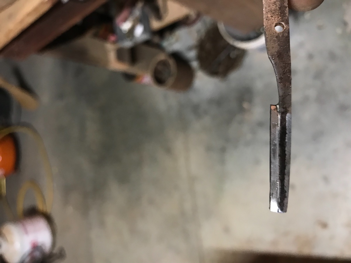

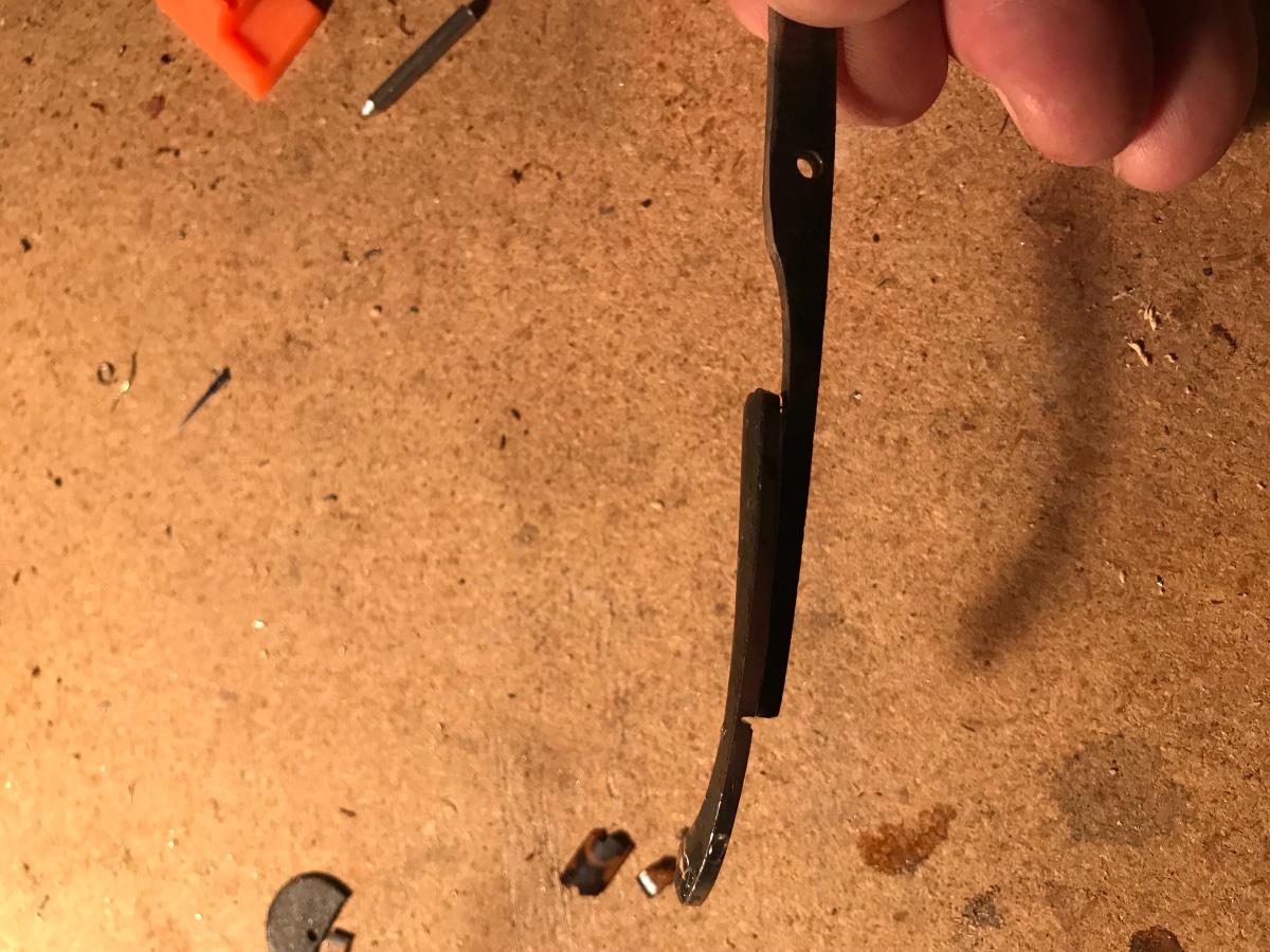

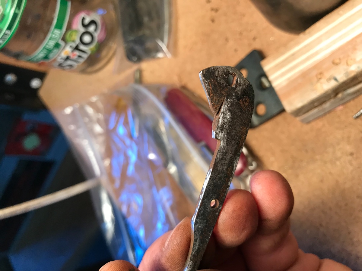

The only surprise when I took it apart is that the spring was not original, either. After re-shaping the blade and the back of the spring, I discovered two things about the homemade spring:
It is much thinner than the blade, and it is too narrow near the end of it. There was no snap, and the blade sat too far into the blade well to even see the nail nick.
I started to make a new spring, but instead decided to silver-solder a broken spring on top of this one, and grind it down to fit. It worked well! And I kind-of enjoyed the end result! I know that painting it might seem kind of tacky, but I am happy with it!

Silver soldering the spring parts is something I haven’t seen before. Nice job with the knife and way to think outside the box!

I have thought of soldering on a thin piece of clock-spring material before, but decided against it because it might wear the tang too badly, being a harder steel.
This only worked because it needed a LOT of build-up!
I also followed Dale's soldering advice and tinned both pieces. It soldered better and the parts stuck right together with no sliding around!
