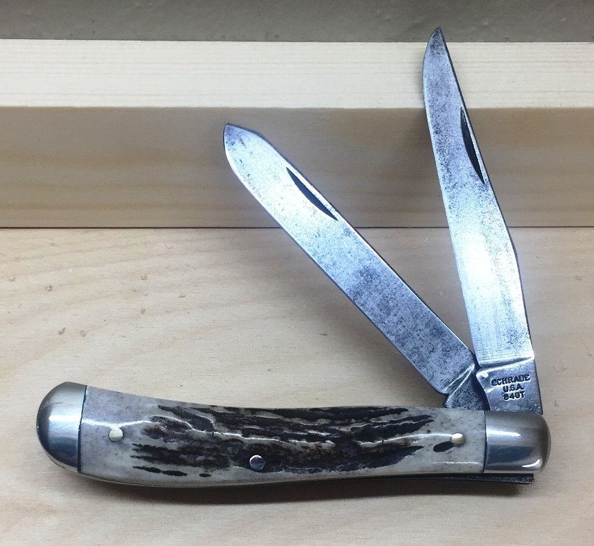

I actually got a few minutes away from my "honey-do" project and got a chance to get in my shop yesterday.

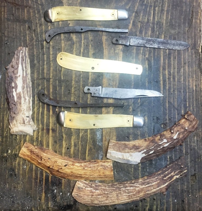

I got this Old Timer a few weeks ago that had a broken swenden pin in front and the main blade had jumped off the track. The blades looked nice and full so I bought it. I figured it needed a new set of scales and a good pinning to get her going again.
Just after I got the knife disassembled and cleaned a bit, I decided I wanted to put some deer antler on it for new scales.
Here she is all broken down and cleaned up a bit. I cut 4 pieces of deer antler as flat as I could so I might have a couple of good ones to choose from.
The lower 2 pieces turned out to be the only ones I could get to fit. I still didn't get as good a fit as I would like but.....Oh well...

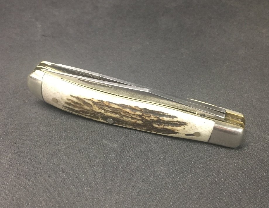

Here is a couple of poor pictures of the end result. She walks and talks once again!
Kinda favors an Uncle Henry now. SO, does that mean it's an Old Henry....

I am not exactly pleased with the out come. The fit of the scales is much less than I wanted. The antler is straight off an old hunter's rack. I have a lot of practice to do to get better at fitting scales between bolsters.
But the usability is back..... full sharp blades and she snaps open and closed real nicely.
She will tote pretty nice!

I would say you did very well with the antler you had to work with.
IMHO, the artistry of working with stag is to make the best handle possible from the piece of antler you are using. That takes a lot of practice even just using precut slabs. There is a whole new level of difficulty involved when you are cutting the slabs as well!
I expect you are like I am, my own worst critic, when it comes to looking at a knife I have worked on. I see flaws no one else sees because I know they're there.
The knife looks better than you think it does!
Great job! ::tu::

What did you cut the antler with?
Meridian_Mike
Posts: 5041
Location: Mississippi
Re: I fixed up a broke 94 OT
Post by Meridian_Mike »
Doc B wrote: Mon Oct 14, 2019 3:53 pm Looks pretty darn good, to me! ::tu:: ::tu:: ::tu::
I zipped some pieces off with my band saw. It's not all that easy, really, with these ole Mississippi white tail antlers. You have to commit yourself early by loping off a piece and then trying to find a sorta straight surface to put against the fence.
I discovered with this attempt that I need to try to get some longer pieces (if I can) to start with. Time you sand the back side to make it flat, you sometimes end up with a piece you can't use.
I wanted to use the more gnarly pieces this time but it just wasn't in the cards. I ruined the first one in a HURRY.... LOL.
You get a bunch of old antler sets and you think you really have something. Then you start looking at where you can cut to get a slab..... then the fun starts.....LOL.
:lol:

Wow, that knife really, really looks sweet Mike! I'm going to have to give antler a try. If I come across any that have been shed in the woods, or maybe off a fresh kill, do I need let them cure for a certain period of time before I try cutting? (I do expect to ruin quite a few in the learning process.) Best regards. Herb

I can't speak with any authority concerning whether the antler needs to cure or not. All that I was given had to be 5 to 8 years old.... maybe older. This guy had a LOAD of antlers from deer he and his kids had harvested. I tried to pick some of what I thought was best. I was looking mostly at the outside "finish" of the antlers for a gnarly, rough and cool look. I probably need to look for some of the straighter pieces if I get a chance to go back.

I feel your pain on trying to get a good slab cut out of Whitetail antler! That stuff is all curves, and it is amazingly hard to get decent scales out of them. I typically waste much more than I use.
