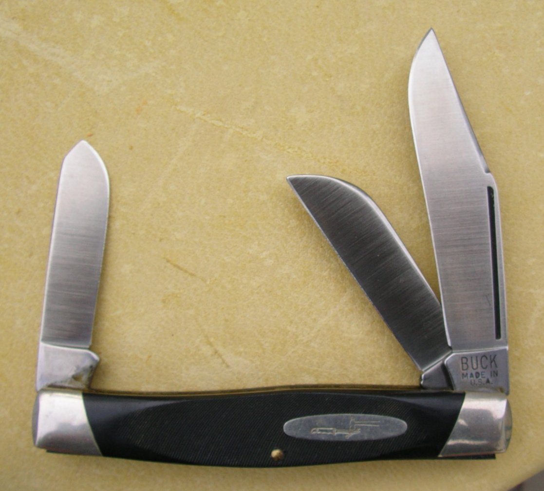

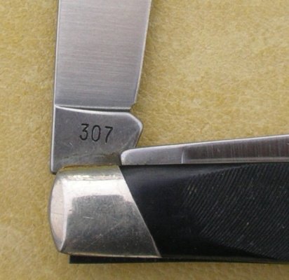

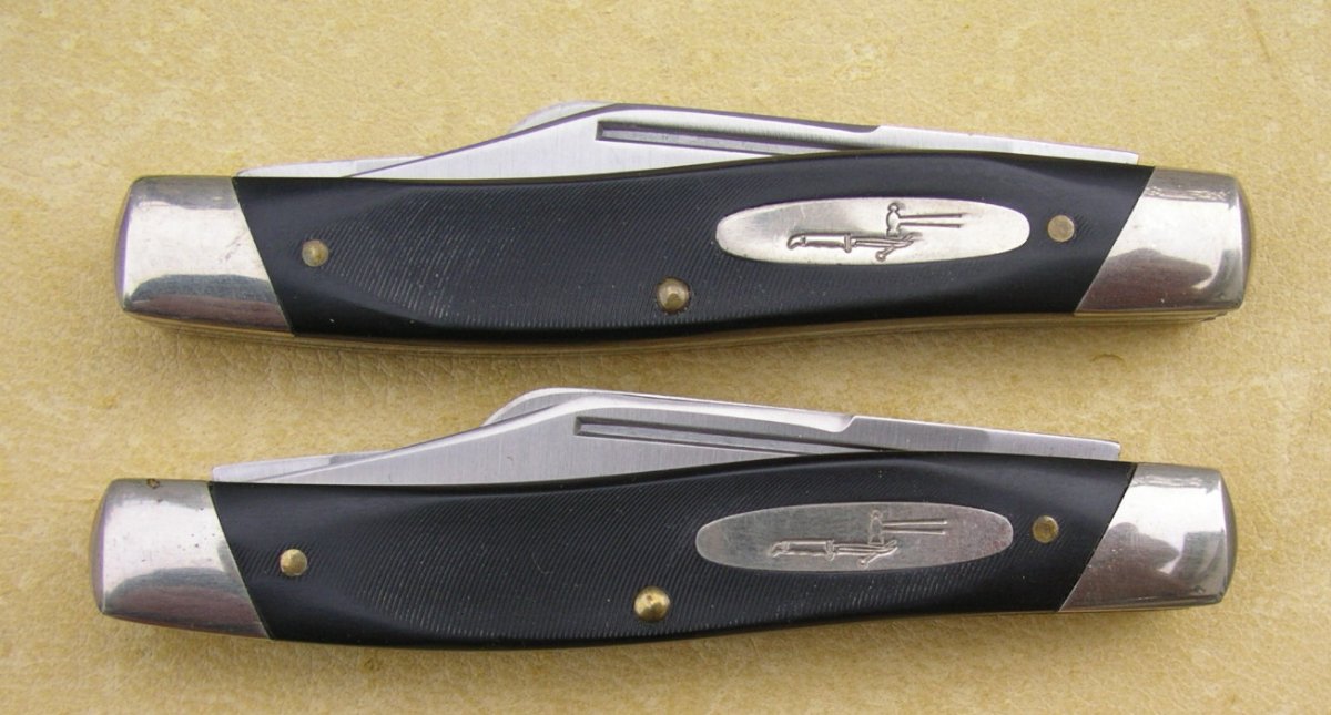

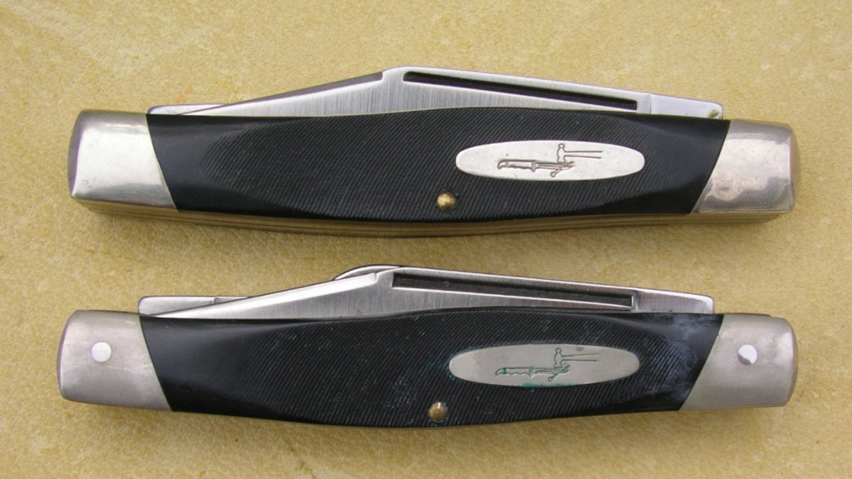

Here are 2 Buck 307 Stockman pattern knives, 4 1/4" closed. Both are marked only on the master tang. One has "BUCK/Made In/U.S.A." on the front side and "307" on the rear. The other is marked only on the front side: "BUCK/307/U.S.A."
The one marked only on front tang has clearly visible blade pivot pins. On the other ones the pivot pins are not visible.
Are these both all original, not altered after leaving the factory ?
And what please are the date ranges for these ? Made by Buck ? or Camillus ?
thanks for the help in understanding these 2 knives.
kj

I can't provide any solid facts but I think the one with stamps on both sides of the tang is 1971-1974 production. I'm only making that assumption because I have a friend whose looking for one just like it. Check your PM's please, Roland.
Rick T.
TwoFlowersLuggage
Posts: 3113
Joined: Sun Nov 26, 2017 8:18 pm
Location: Stuck in traffic on a highway in Southern California
Re: Two Buck 307; Both All Original ?
Post by TwoFlowersLuggage »
According to this: https://www.allaboutpocketknives.com/kn ... 15#p386840
The two-line Buck/U.S.A was used from 1967-1971, then the model number was added in 1971. The date marks started in 1986, so the three-line stamp would be 1971-1986.

The knife with 307 on the pile side of the tang is the first version of the 307 dating 1971-1974. The other knife dates 1974-1998. No Camillus contract knives had date codes—even those from 1986 until the end of production in about 1998. The 307 was always a Camillus contract knife. There is a third version made 1985-1987, which has "BUCK" spelled out on the shield, instead of the traditional hammer, knife, bolt shield.The shape of the shield for that version was a racetrack oval instead of the traditional ellipse.
The blade rivets of all 307s are visible, but sometimes they are hard to see, especially if the bolsters have been polished. Try rubbing the bolster against your pant leg and then breathing on it. That may help seeing the rivet.

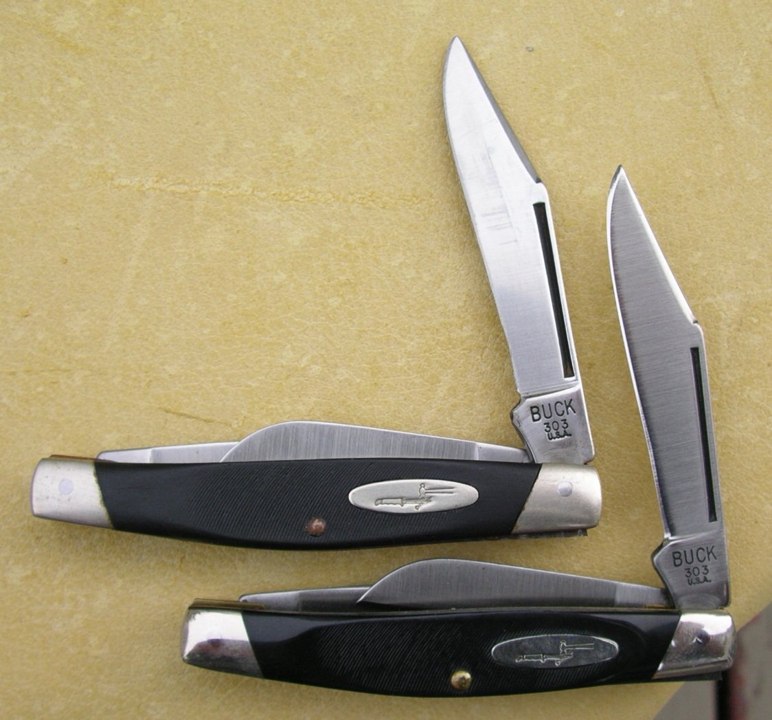

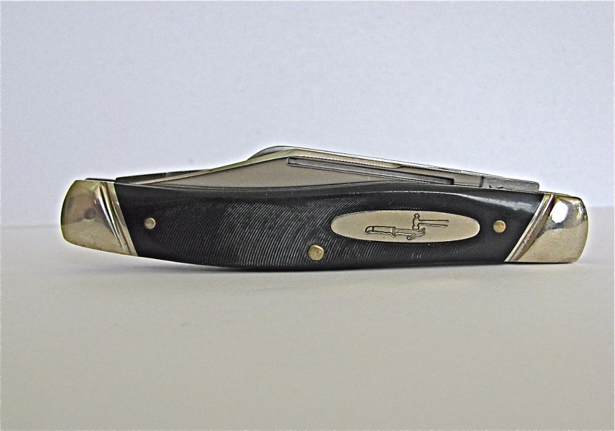

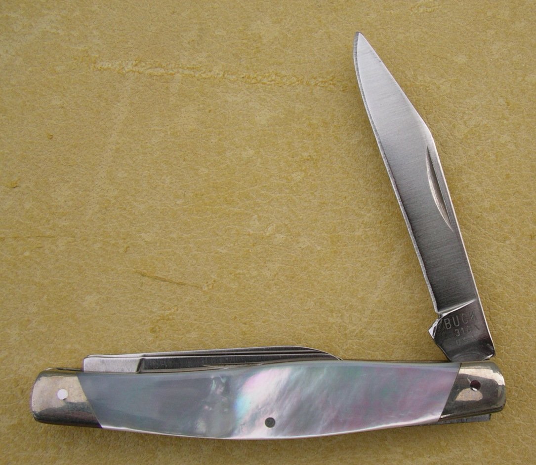

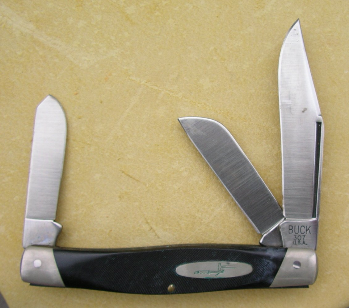

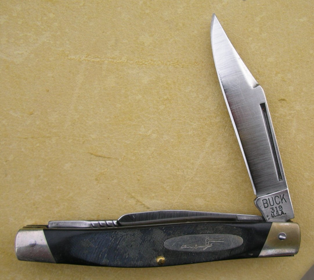

Well, i can answer my own question because i just found the last of my Buck knives. Turns out visible pivot pins are the norm for Buck folding knives.
Here is a 310 Whittler with pearl handles: pivot pins visible.
319: pivot pins visible
two 303's: pivot pins visible

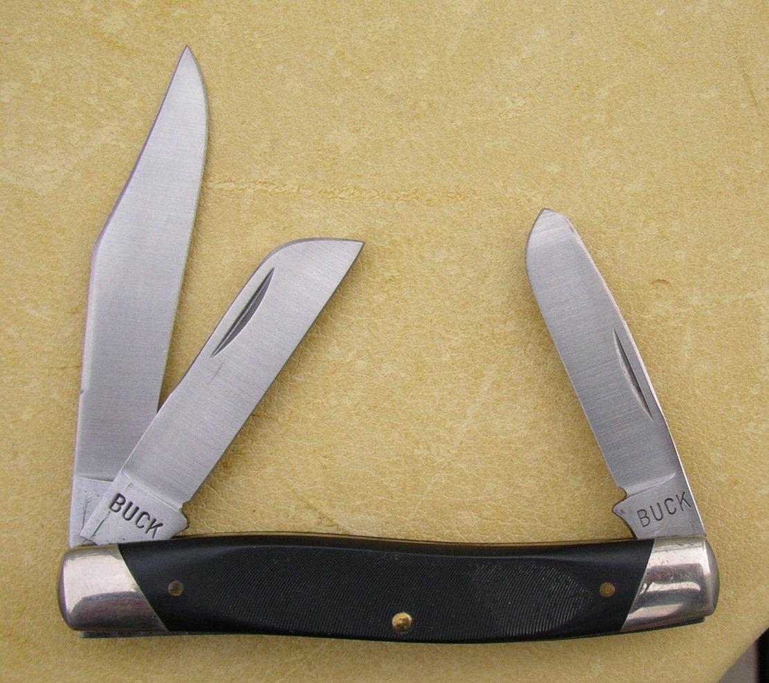

But these two folders 3 15/16"closed, 301 ? pivot pins not visible. H'mm, maybe Schrade Swinden ?
kj

They all have visible pivot pins, but sometimes they aren't easily visible. The only knives in the 300 series with hidden pivot pins are the knives made by Schrade. That's the main reason Buck switched from Schrade to Camillus—the hidden pins on the Schrade knives made them impossible to repair and when there is a lifetime warranty that's not a good thing.

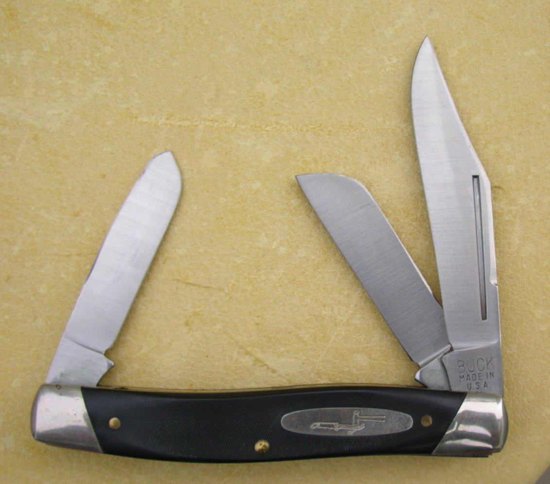

This knife is likely a Schrade built knife, circa 1966-67 ?
kj
Old Hunter
Posts: 8409
Location: Beaufort County, NC
Post by Old Hunter »
KJ, your last one is a Schrade built Buck. The Schrade 301’s have a long Blade Swedge making them easy to spot. OH
kootenay joe
Posts: 13373
Post by kootenay joe »
Thanks OH. Good tip. I can see that the swage goes to near the tang end of the long pull.
kj

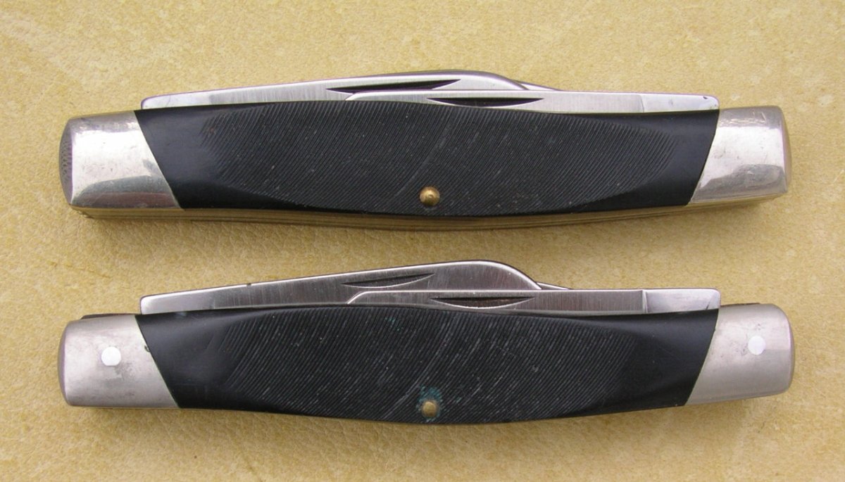

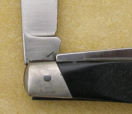

Here is one you don't find often. It is a 1st Version Schrade 301, which was repaired with visible blade rivets. Joe Houser told me Buck only did a dozen or so of these before stopping the repair of them. It was a time consuming process and a weak repair.
Bert
kootenay joe
Posts: 13373
That early version has grooved bolsters. Is it marked only on the master blade ? If so, according to Levine, it is the earliest of the early Schrade made 301's.
kj

Post by bertl »
kootenay joe wrote: Sun Oct 13, 2019 2:49 pm That early version has grooved bolsters. Is it marked only on the master blade ? If so, according to Levine, it is the earliest of the early Schrade made 301's.
kj
It is. This version was made 1966-1967.

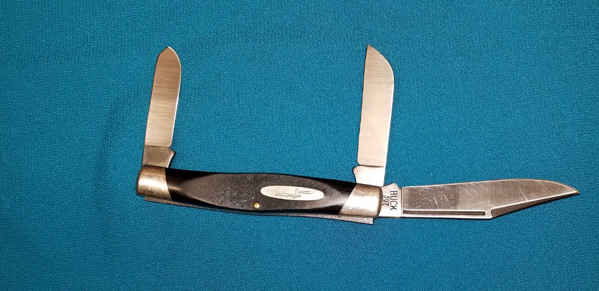

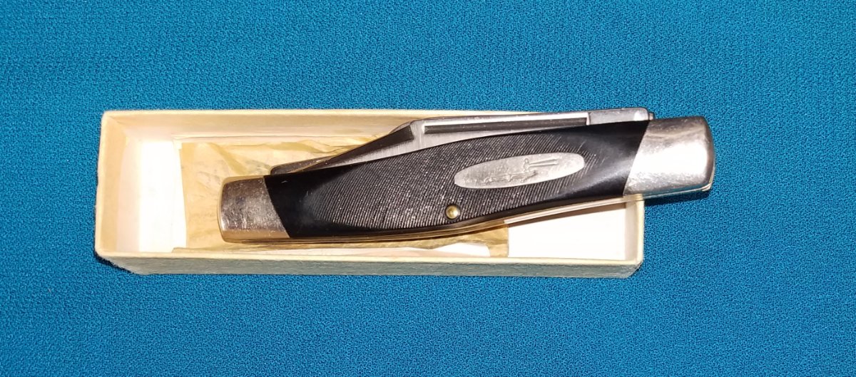

Here is one I bought about a year ago. It matches my 301 perfectly.
Have a blessed day,
Leon
Yeah, I learned how to post photos!

Very nice Leon - good pictures too! OH

Wow! A 307 without box and papers, which I have with mine, just sold on the "bay" for over 90 bucks. But, a 301, no box etc, sold for less than 25.00. As I learned a long time ago, the price of anything is what the market will bear.
