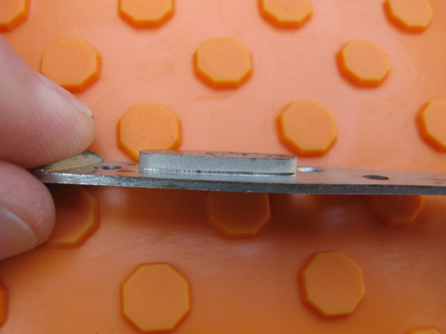

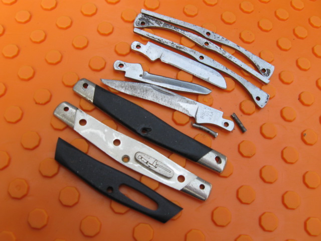

I disassembled this Buck 303 recently and I was pretty impressed with the way these are constructed. The disassembled knife was manufactured in the year 2000.

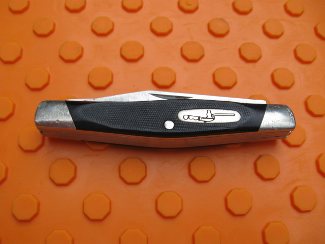

Here’s a picture of another 303 that I have. I had assumed that the handle slabs would be glued onto the liners considering there is only one pin attaching the slabs in the center. I discovered upon disassembly that this is not the case. I encountered no glue whatsoever on the handle or anywhere else on the knife.

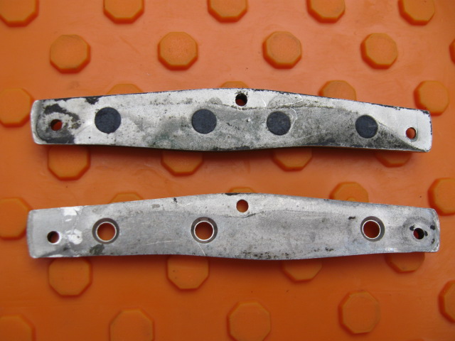

The handles slabs are attached using what I would call a plastic “rivet”. I thought I could simply push those round black circles outward and the slab would pop off but that was not the case. Instead, I had to break those round circles off to get the slab off. I read up on this and I found out that prior to installation, the slabs have a post on them that goes through the large holes in the liners.
The post is then melted and sanded smooth. Those little ridges in the holes keep the melted rivets securely in place. The handle slabs cannot come loose unless those rivets break which is virtually impossible unless done intentionally. I know that Buck has literally made tens of thousands of these knives since this type of construction began and many people own a Buck 303 Cadet. I thought owners might like to know how your knife is constructed if you didn’t know already.

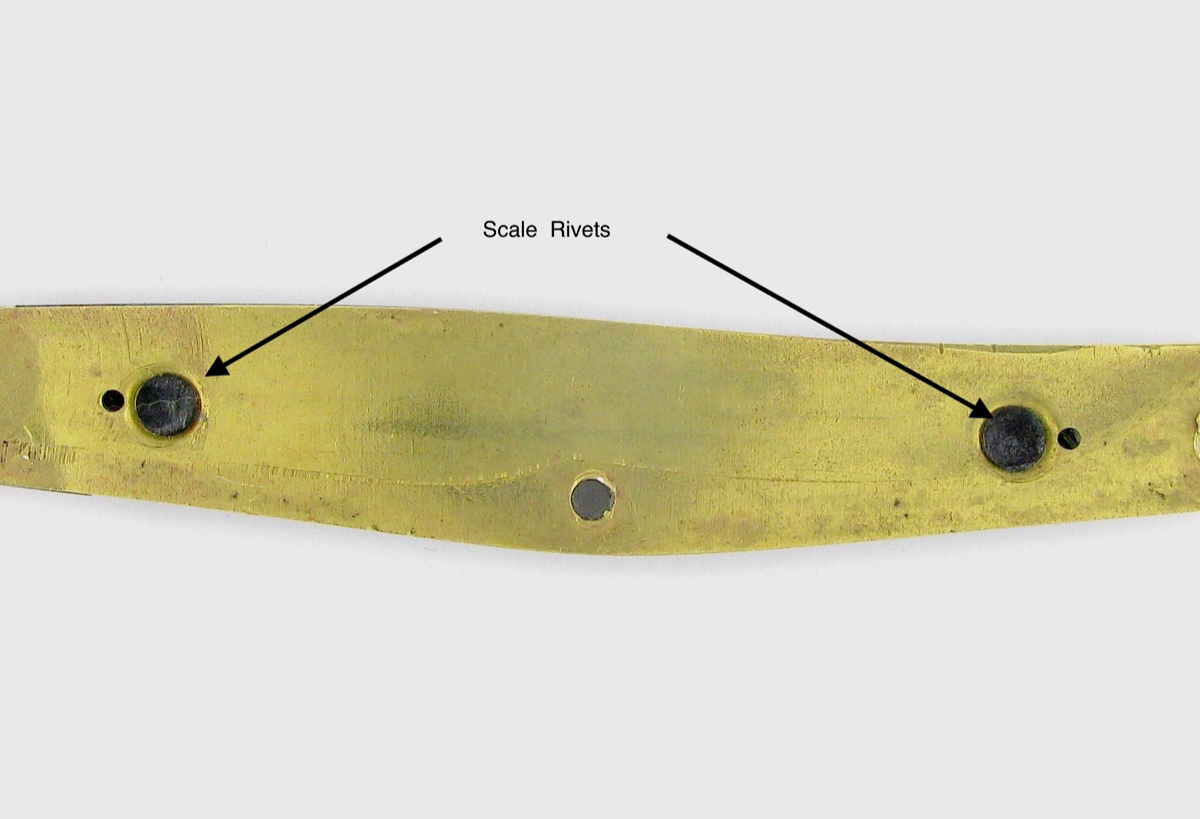

“That method of attaching the handles is called the post method. Basically a post of Delrin, or whatever the handle material happens to be, is injected through the hole in the liner and then melted off flush on the inside.
Camillus used this process a great deal. I know that Camillus made a lot of knives for M Klein back in the fifties and early sixties, but after seeing those liners for the Post method I'm thinking that M Klein must have gone back to Camillus at some point in the last few years before they closed.
I always flatten out the liner and then drill new holes for the pins. It's not hard, just be sure you get the pins in line front to rear and also from side to side. “

Thank you, Jeff. This is all new stuff to me. It hadn't occurred to me that this method might be used on other knives. I automatically think "glue" when I only see one pin or no pins.Jeffinn wrote:Hey Rick,

This was my first time taking apart a slip joint. I have no plans for re-assembly. I just wanted to see how it was constructed.

I had read in the past that this is the method Buck has used since adopting VALOX as the handle material. The rosewood and yellow Delrin knives are attached differently (rivets). OH

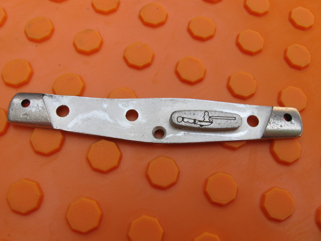

For example, the shield on the 303 that I disassembled is supposed to be an integrated part of the frame. The liner, bolsters, and shield should all be one solid piece of steel but my shield appears to have a solder line. I've been trying to find out why but I'm at a stalemate.

Both Delrin and Valox are thermoplastic polymer resins. A few years ago Joe Houser told me that BUCK does not have "injection molding technology in house"; therefore, the plastic scales are attached to the frame by an outside contractor. The "saw cut" pattern is pressed onto the scales at the same time. The plastic rivets have been used for a long time, even on the Camillus contract knives. The holes in the frame for the rivets is slightly dished to capture the pressed plastic.

"For example, the shield on the 303 that I disassembled is supposed to be an integrated part of the frame. The liner, bolsters, and shield should all be one solid piece of steel but my shield appears to have a solder line. I've been trying to find out why but I'm at a stalemate."
The shield tower, liner, and bolsters are all one piece. Since the shield tower started when using sintered nickel silver for the integrated frame began, it's the easiest way to do it. I had the same question, so I sliced through the tower and frame to check. It is not soldered.

Bert, I hope you know how helpful that was. I've been trying to get an answer on that for a week. THANK YOU!bertl wrote:_________
