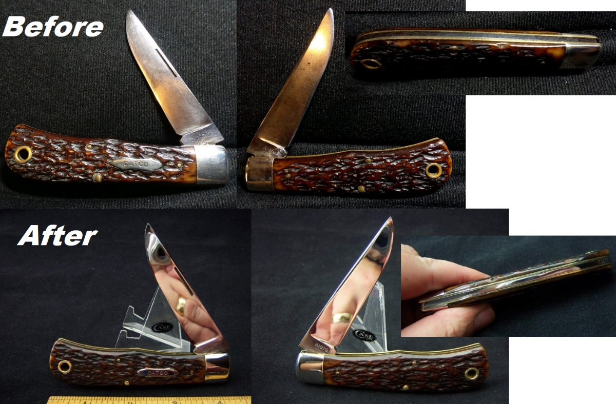

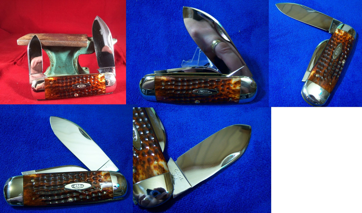

I did this Case model 64 earlier this year. I was very proud of it & I should have gotten LARGER Pics but oh well. I spent about 3-Days on this knife & took it to 5,000 grit. It sure was pretty too me & a Super sharp clear image.
Kindest Regards,
Mark
Kindest Regards,
Mark

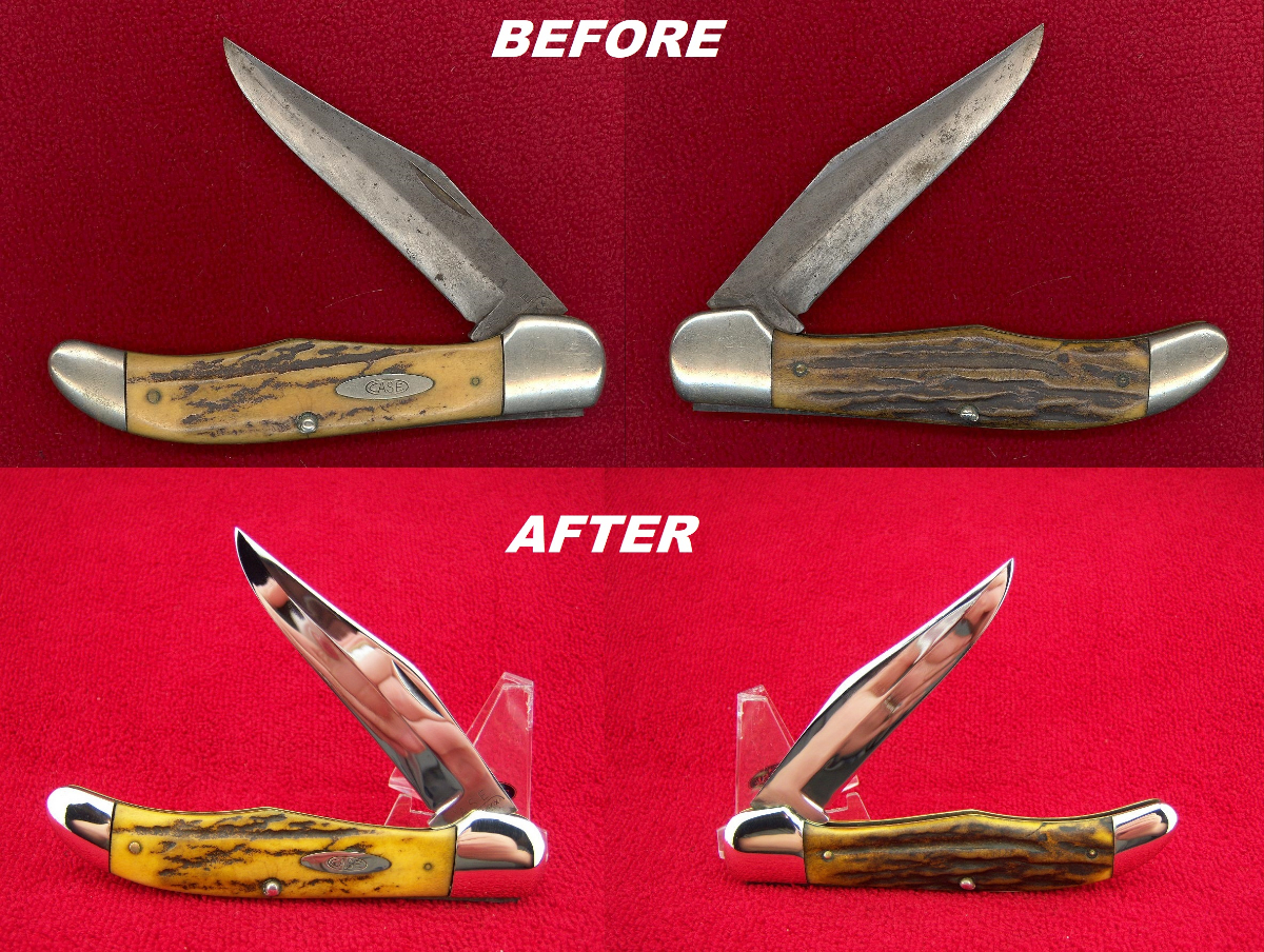

This Catco came from the Tulsa show in April of this year. It was a Tuff knife to clean because of the deep pitting in a few spots. I did very well to preserve the knife & its thickness. This one took me about 3-days also.
Kindest Regards,
mark
Kindest Regards,
mark

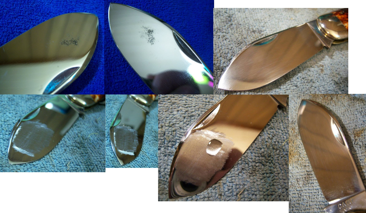

A real shame about the Case 64. It was a fine full bladed example with some scratches in the chrome plated blade. Now there is a knife with all original chrome removed. Sorry, the shine of polished steel does not have the same color as chrome and in the eyes of many Case fixed blade collectors the knife has been ruined.

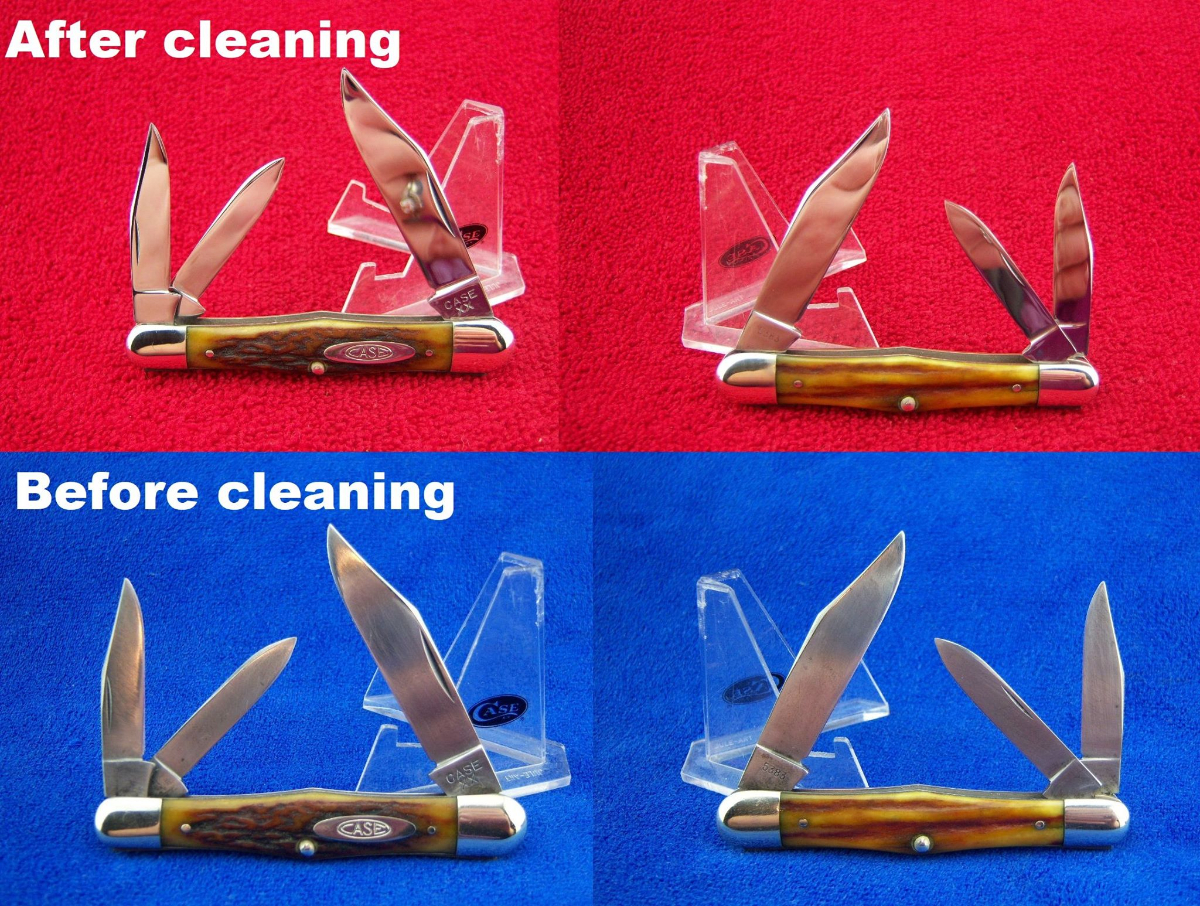

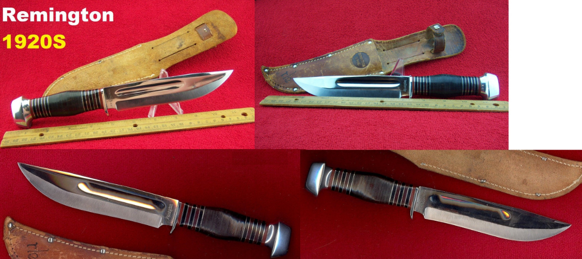

I forgot to keep the before pics of this Rem knife. This knife had no original finish at all w/ some pitting. I have only did 2 fixed blades so far.
I put 2 different finishes on this Rem Knife as it came from the factory that way. Top part I put a "Mirror" finish & the bottom next to the blade edge I put a Satin/Glazed finish.
Kindest Regards,
Mark
Kindest Regards,
Mark

Yes Sir you speak the truth!! Many guys dislike "Knife cleaning" completely in its entirety.Gunsil wrote:A real shame about the Case 64. It was a fine full bladed example with some scratches in the chrome plated blade. Now there is a knife with all original chrome removed. Sorry, the shine of polished steel does not have the same color as chrome and in the eyes of many Case fixed blade collectors the knife has been ruined.
When I was sanding on this knife, I personally didnt notice any chrome plating on the blade whatsoever. I have owned a bunch of chrome plated knives & this particular example was not plated from what I could tell. I wouldnt have taken the chrome plating off because I agree with you.

Gunsil, I didnt touch the tangs of this knife either. Matter of fact, Some of the original factory finish on the blade, I left on it Sir. All I did was remove the scratches & I blended it in with the original finish. I do know most of these did have "chrome plated" blades, But I dont believe this one was made that way.

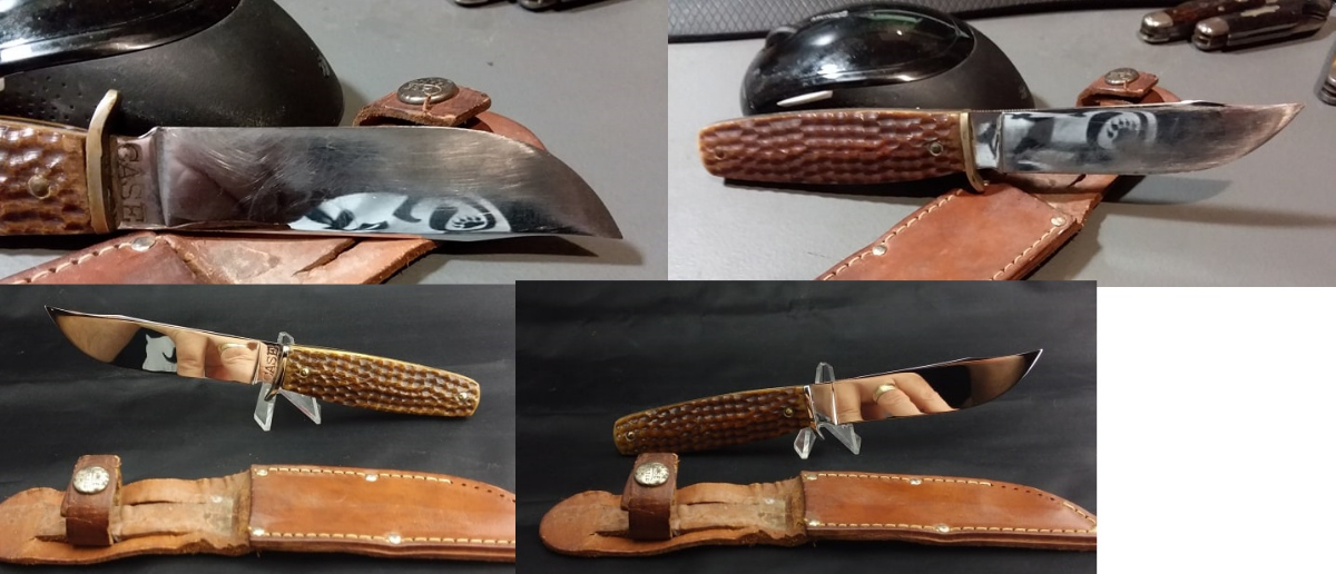

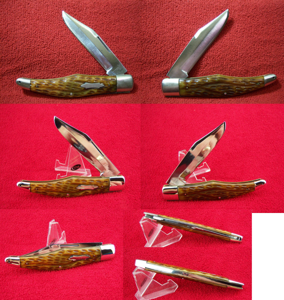

Here was another different type of piece that I was proud of. I blended in my sanding w/ original factory finish. Turned out great considering how deep the rust was.
In order to get better & better,,,,at ANYTHING,,,,is PRACTICE PRACTICE PRACTICE!!! These results did NOT just happen Immediately. I ruined a lot of knives LEARNING the LEARNING Curves of What to do & What NOT to do. Yes I tried a belt sander from harbor freight w/ 1000grit sandpaper & it didnt take 5-seconds & I had a half a blade left in my hands, lol
. I chunked that knife in the trash & kept going..
Thats where I started,,lmao
Kindest Regards,
Mark

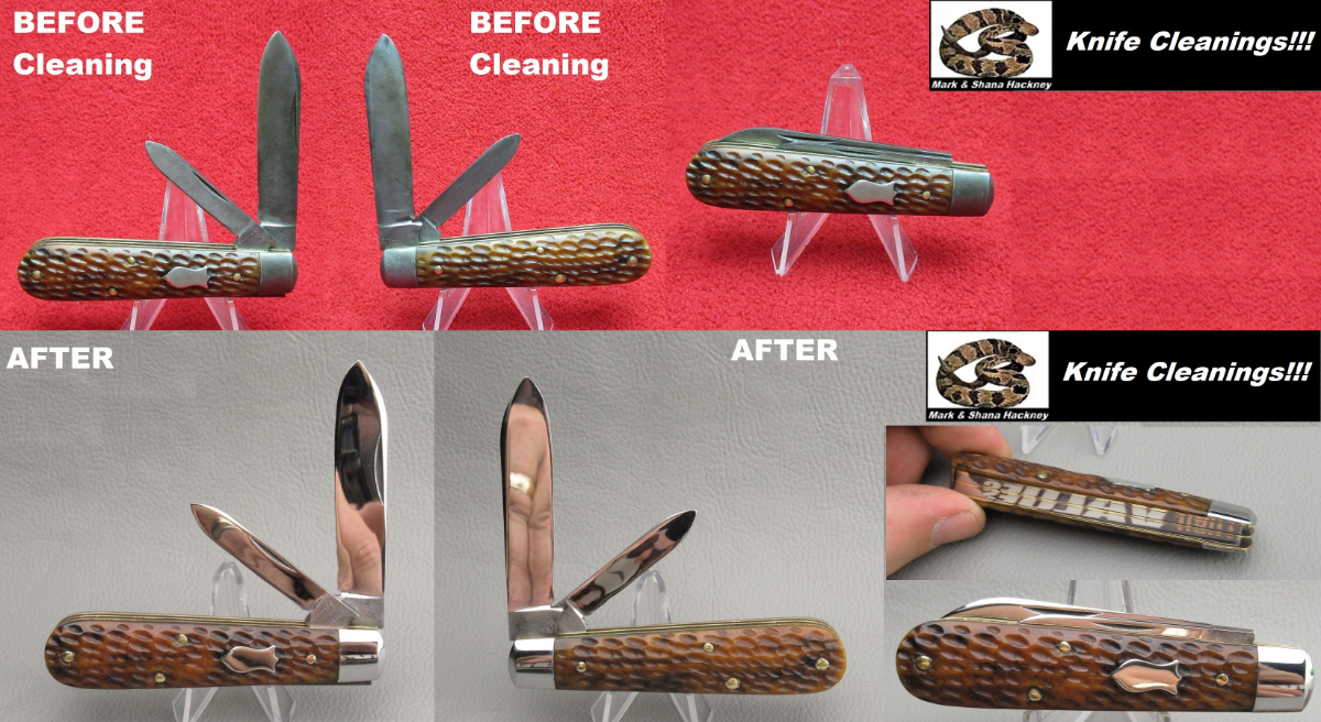

Hey Guys, Here is another one I did last year sometime
Kind Regards,
Mark
Kind Regards,
Mark

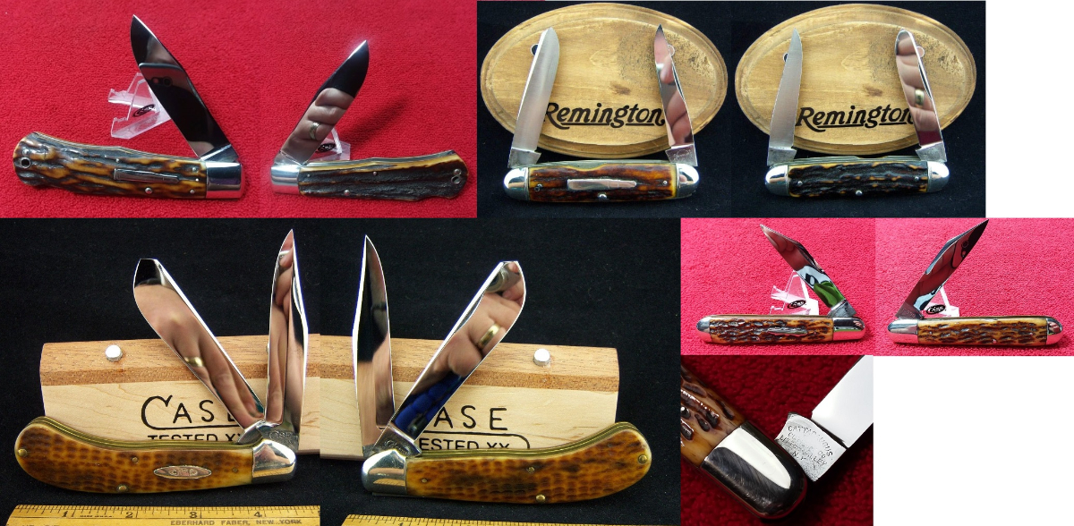

Hey Guys, I found a few extra pics last night that I want to share with you guys. These knives in particular came from a Long time Collector(were talking back in the 90s ok). The Gentleman was a knife lover & would have his knives personally cleaned by Mr. Herb Aycock. He couldnt remember if he had them done in the 80s or 90s but he thought it was early 90s. Nevertheless, They were wonderful knives & so is the Gentleman. I am posting these because there maybe some of you guys who dont know what Mr. Herbs knife cleanings looked like.
Kindest Regards,
Mark
Kindest Regards,
Mark
