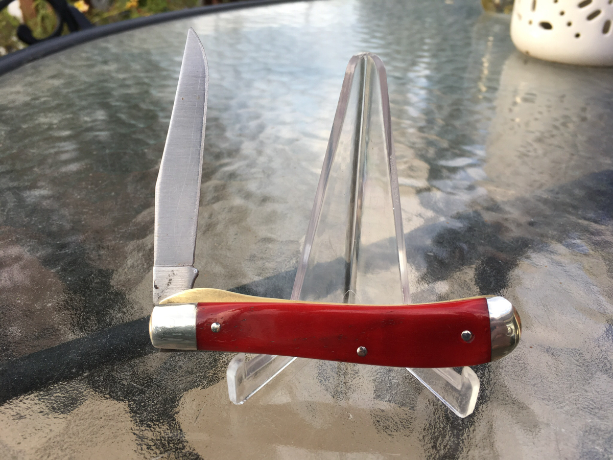

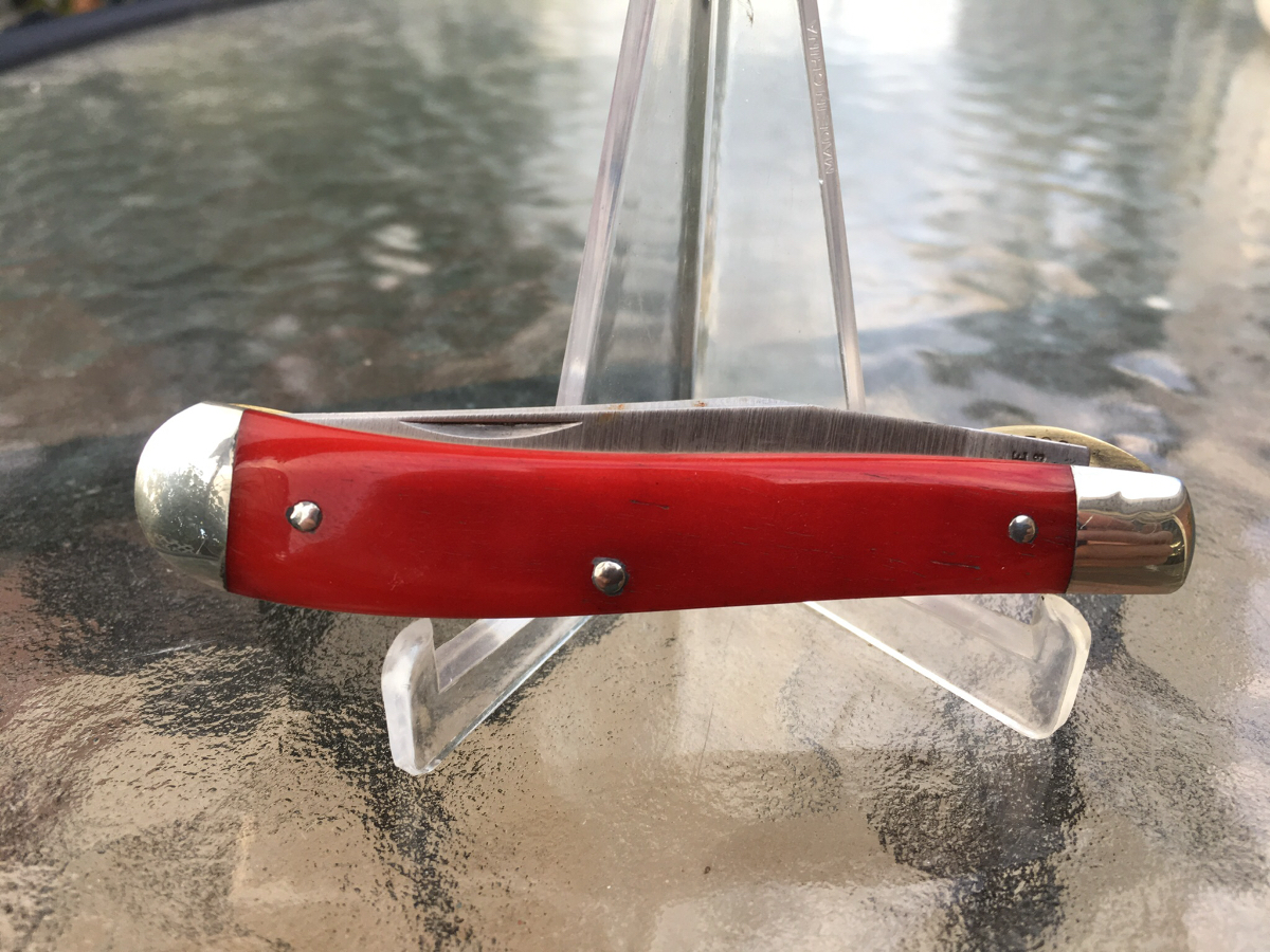

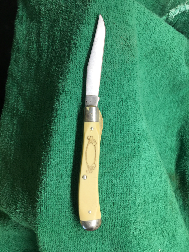

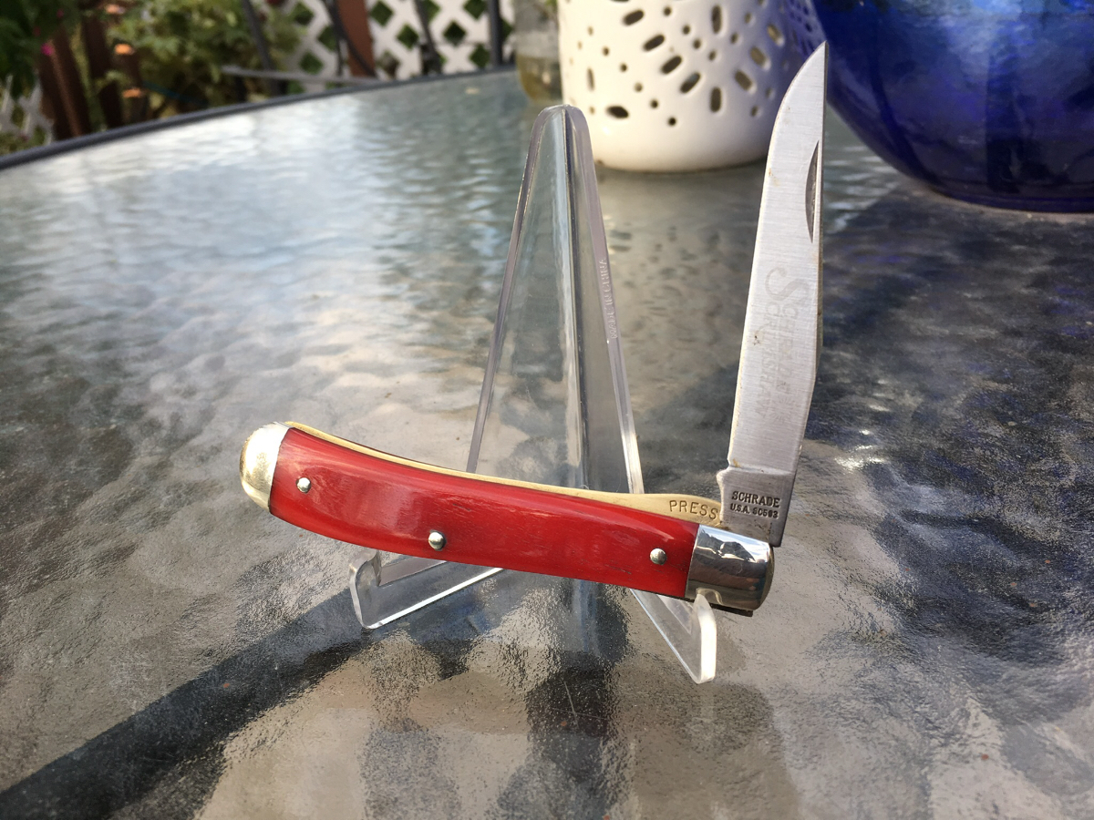

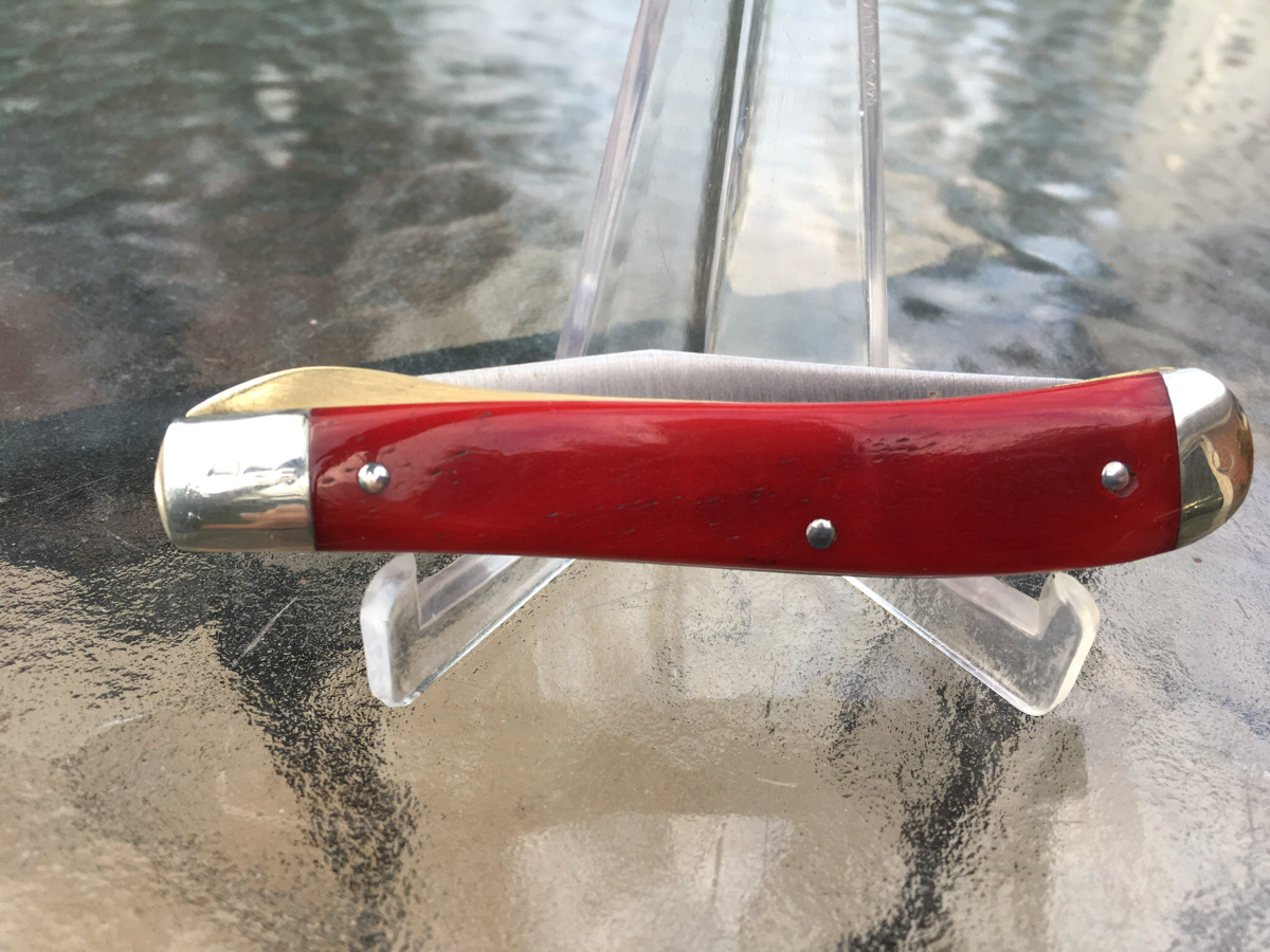

A regular old Schrade Scrimshaw knife. I can appreciate the whole scrimshaw thing but I’m partial to the real hand done scrimshaw art form. I had the good luck of seeing real scrimshaw work being done years ago by a young artisan down in the coastal North Carolina area. After seeing it done by hand the laser generated “scrimshaw” loses some of its appeal.

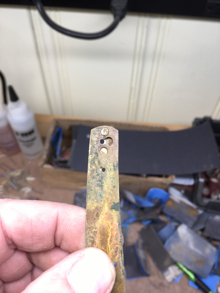

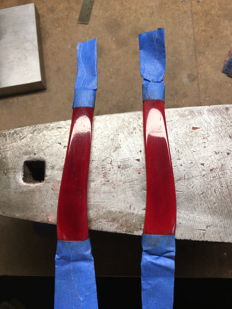

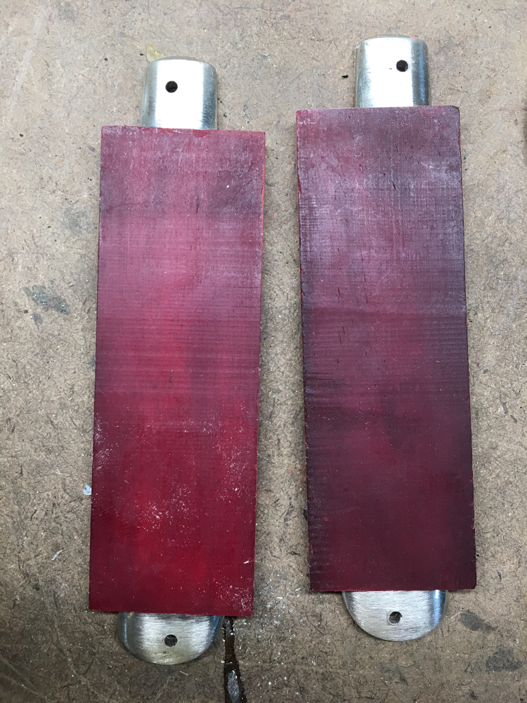

This was my first swinden key knife but I didn’t realize it until after I cut the pins. Fortunately Muskrat Man had posted a video on how to install pins in a Swinden key knife. For my first swinden key knife it turned out pretty darn good!
I had to drill the bolsters for the new pins and you can see that I drilled the bolster in the small section of the “keyhole”; I found some smooth red bone slabs in the bone box so I decided to use them for this knife. Here’s the slabs glued in place; And here they are in their pre-polished state; And here’s the final knife with the new bone handles;
Hey … it’s a pocketknife for gosh sakes. I’m not selling the Mona Lisa….Bullitt4001

Wow ! Very nicely done, and i think you have improved the knife by replacing the synthetic handles with lovely rich red bone and by putting in a standard blade pivot pin. This knife is now ready to last a lifetime of 'good cutting'.

Jeff you make me repeat my self. I think your choice of handle colors really set your knives apart. Excellent (again).

Great job Jeff! I like that smooth red bone too! It sure does polish out real nice! Much better than having plastic or cell for sure!
I have a couple of 8 OTs I need to put some new scales on. They have the swinden rivets and I am thinking I might drill and pin them back together.
Very nice looking knife.... (as usual)

Herman Williams told me that re-assembling a knife with a Swinden key is difficult. Unless the pieces are perfectly positioned there will be some blade play.

She looks great! You are making me jealous with all these beautiful knives you are churning out!
The smooth bone really fits the character of that knife. Good choice.

That sure is pretty! Nice job, Jeff. You're getting to the point where these are looking factory. Have you been involved in our past discussions about marking your work in some way? That way, if it gets into hands that aren't as knowledgeable, they won't think they have an original.

I haven’t been marking mine yet. I’ll need to look a possibly marking the inner liner in some way.

For myself, I just use letter stamps, and punch my initials and the year into the inner liner. Dale sometimes uses his cool etch on the blade. Whatever method works for you, it also lets the owner know who did the great work!Jeffinn wrote:Thanks!glennbad wrote:That sure is pretty! Nice job, Jeff. You're getting to the point where these are looking factory. Have you been involved in our past discussions about marking your work in some way? That way, if it gets into hands that aren't as knowledgeable, they won't think they have an original.

I have it and great to see the build, nice knife got a compliment at knife store today.Jeffinn wrote:A regular old Schrade Scrimshaw knife. I can appreciate the whole scrimshaw thing but I’m partial to the real hand done scrimshaw art form. I had the good luck of seeing real scrimshaw work being done years ago by a young artisan down in the coastal North Carolina area. After seeing it done by hand the laser generated “scrimshaw” loses some of its appeal.
