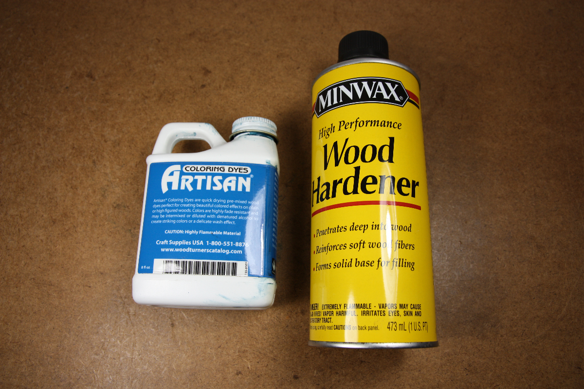

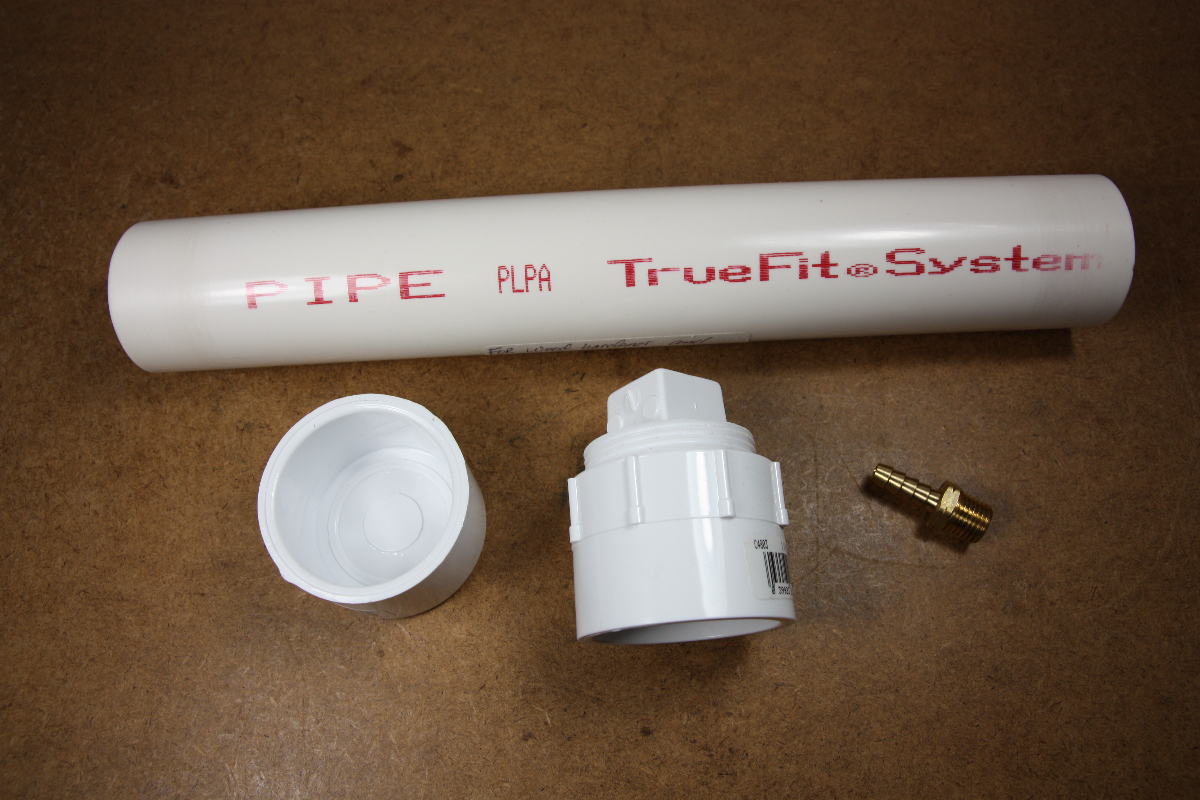

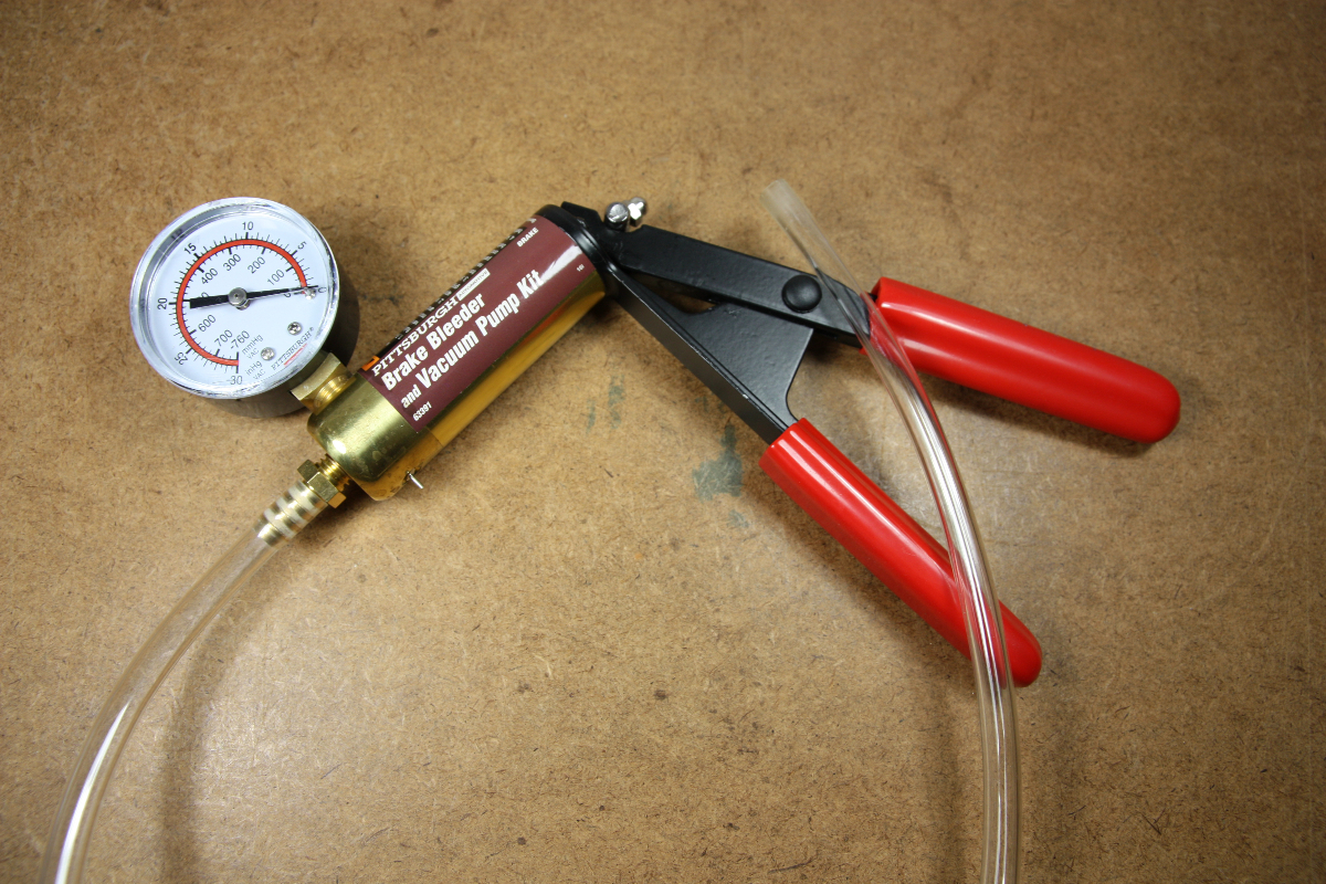

Over the past few days I have been gathering up some parts to try to make an experimental device for stabilizing handle materials. There was some mention of this recently in another thread "Ugly TL29". This chamber will be used for infusing Wood Hardener and analine dyes into knife handle material. Actually, one should have a separate chamber for each solution to prevent cross contamination. The vacuum hand pump is a Harbor Freight $20 unit and the pipe fittings are 1 1/2" schedule 40. An end cap will be glued onto one end of the tubing, and a threaded adapter to the other. The brass barb fitting will be drilled and tapped into the threaded plug. In use the hose must always be facing straight up to prevent the vacuum sucking the solution into the pump and ruining it. I plan to try using this on bone, wood, and would like to try to make stabilized corncob slabs also. I always wondered which works the best, vacuum to draw all the air out of the material to be replaced with solution, or air pressure, to force the solution into the material and push out the air? Anybody done this one way or the other?
