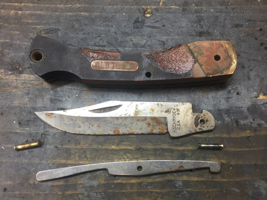

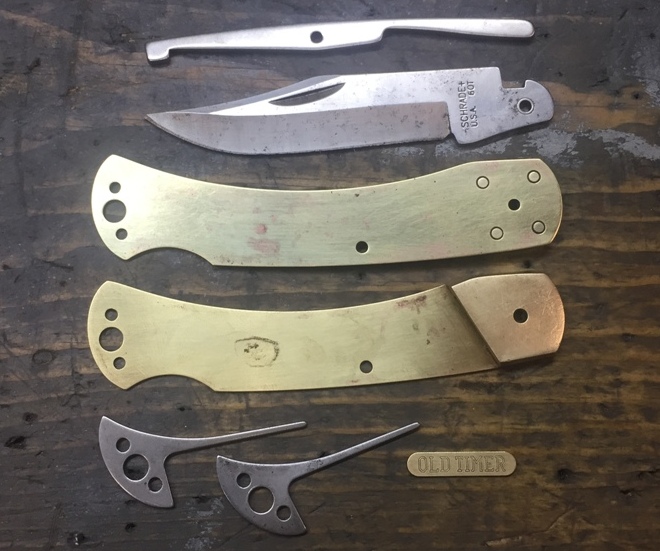

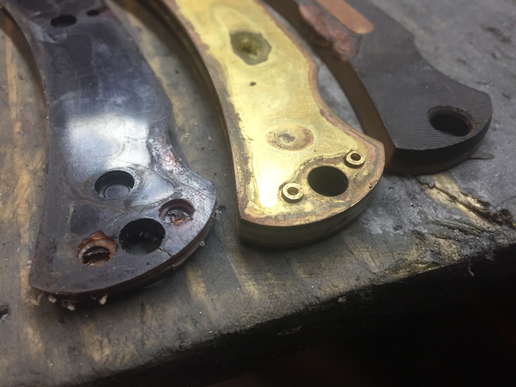

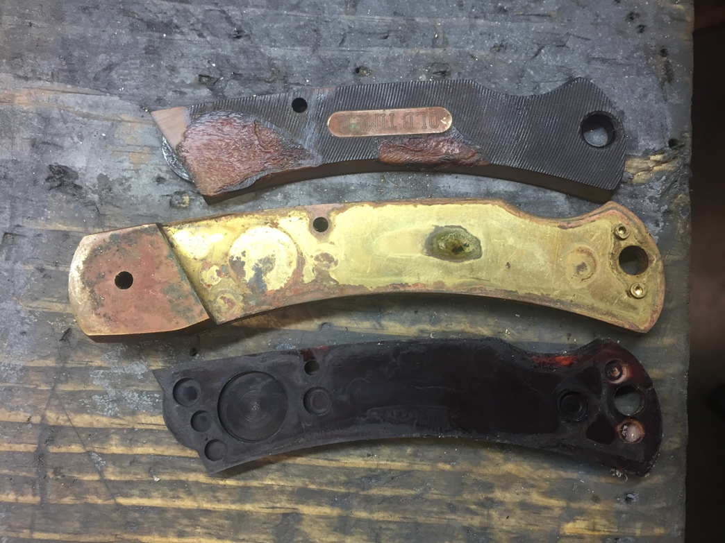

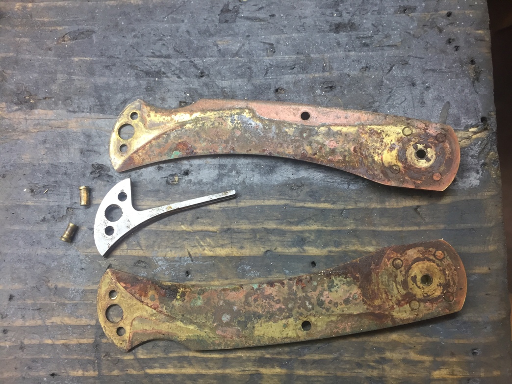

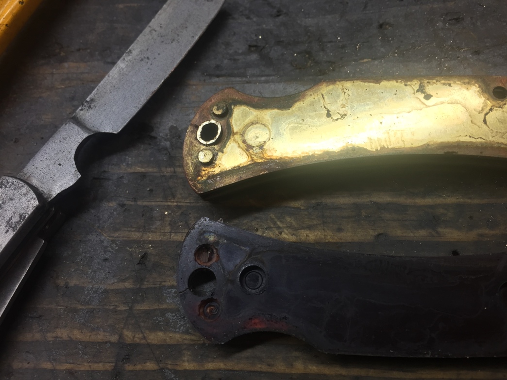

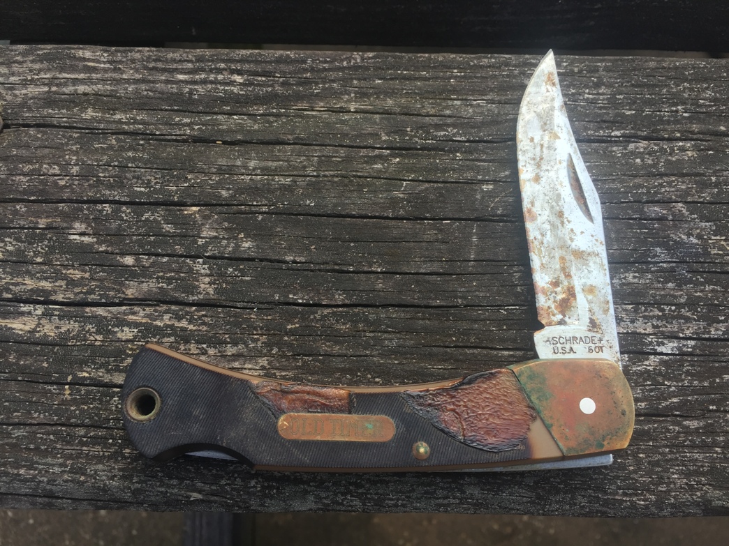

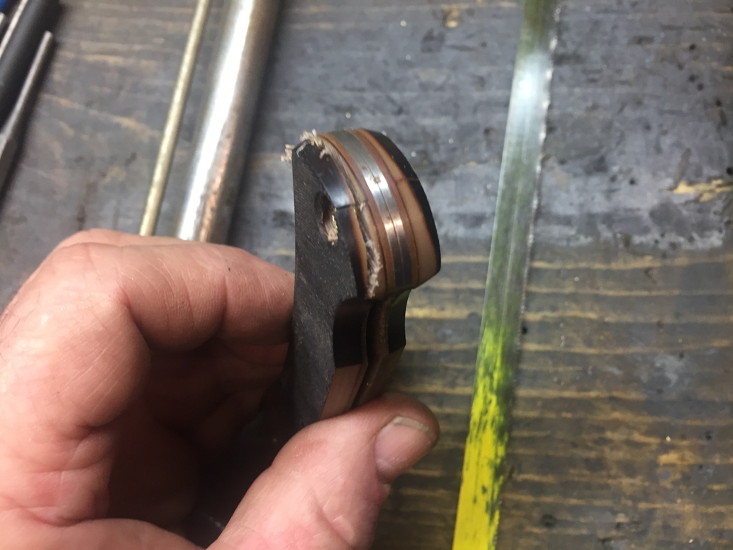

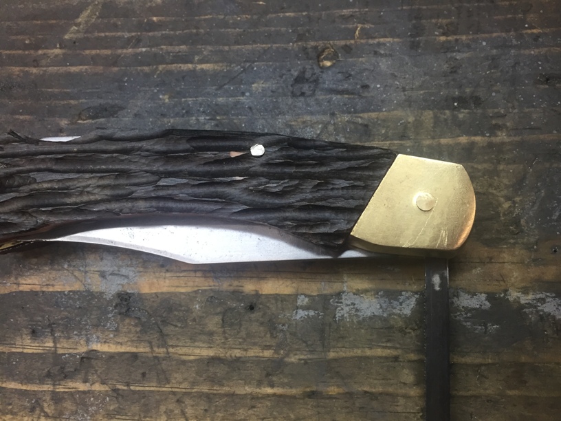

I saw this 6 OT that had a bad case of melted scales. It looked like it had some good bones so I bought it. Sure 'nuff, the blade looks unused. It didn't open or close very good due to some sticky crap on the inside. Well, I went in and took it apart and cleaned it up.
This is as it was when it arrived in my hands... I am posting the following pics to let others see how I took it apart.... I hope this helps you....

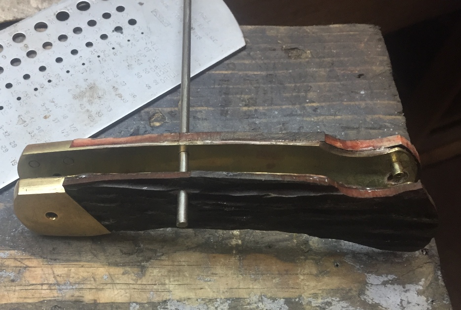

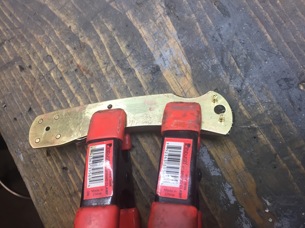

I drilled out the bolster pivot pin and the lever lock pivot pin...... Then out came the blade and lock lever..... The lanyard hole liner at the rear was holding the scales together so I took a hack saw and cut the hole liner..... After this... the scales came off the liners...... Then I was able to punch the lanyard hole liner out and the scales came off easily.... There was a set of 2 rivets that held the inner liners together and also held the blade lock springs in. After I ground and filed these down I could punch them out and the liners and springs came apart. Then came clean-up.... I have all the metal all clean and ready for the new scales....
This is the result of the first cleaning of the blade.... I think I will probably clean it a little better before I call it done. Well, looks like I ran out of picture space....
See continuation below.

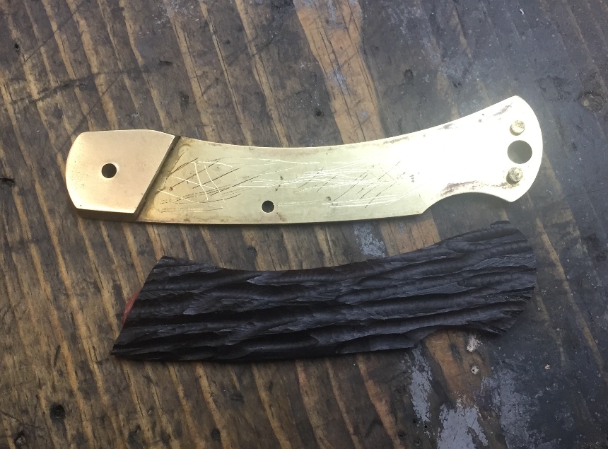

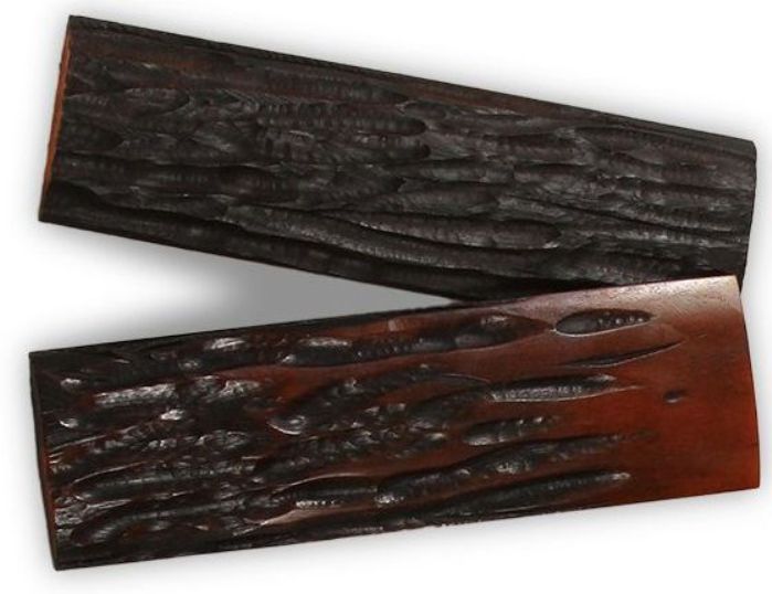

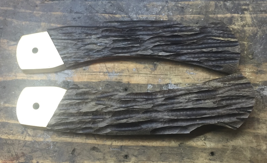

I searched around a bit and settled on this for my scale material. I like me some BLOOD RED stag bone scales.....
I just ordered this material so I will be a few days before I can get back on the finish of this project. To be continued.....

Looking good!
Where did you find those scales?

I got them from Midwest Knifemakers Supply..... (or maybe USAknifemakers?? seems they have 2 names)Doc B wrote:Where did you find those scales?
https://usaknifemaker.com/stag-bone-blo ... cales.html
They were the only source I could find that had the size I needed in the color I wanted. Culpepper was my first choice but everytime I found a color and style I liked, the size was too small for my needs.
Yep, I want that shield on my knife because I guess I was an Old Timer Collector first. SO, I just can't have an official Old Timer without an OT shield. I have learned a lot about inletting shields in bone from others here on the forum. I have a Foredom rotary tool so I am going to "give it a go".Byrd wrote:Are you gonna inlet the Old Timer shield?
Well, I hate to disappoint you Dale but.... my plan from the start was to eliminate the lanyard hole all together. I am not a big fan of then anyway so I saw my chance to let this one go away. I could see how there could be a degree of difficulty to getting another one fitted. I think I could get the hole drilled but getting another liner to fit like the old one is something I don't care to try.....LOLorvet wrote: I'm watching with great interest Mike to see how you handle the lanyard tube.

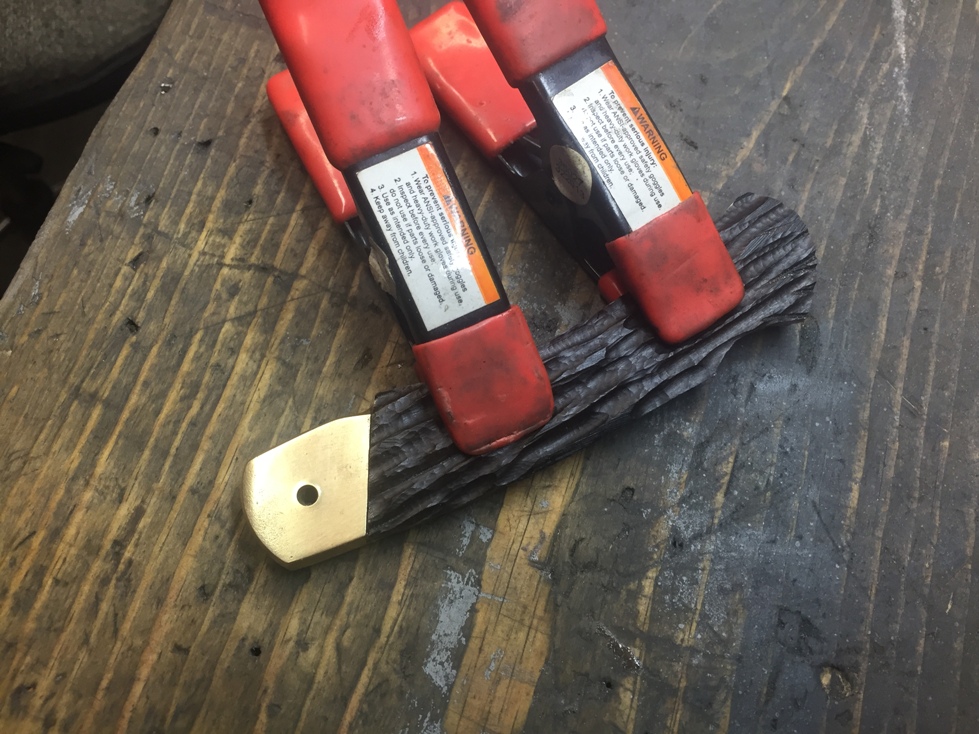

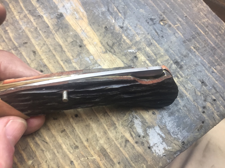

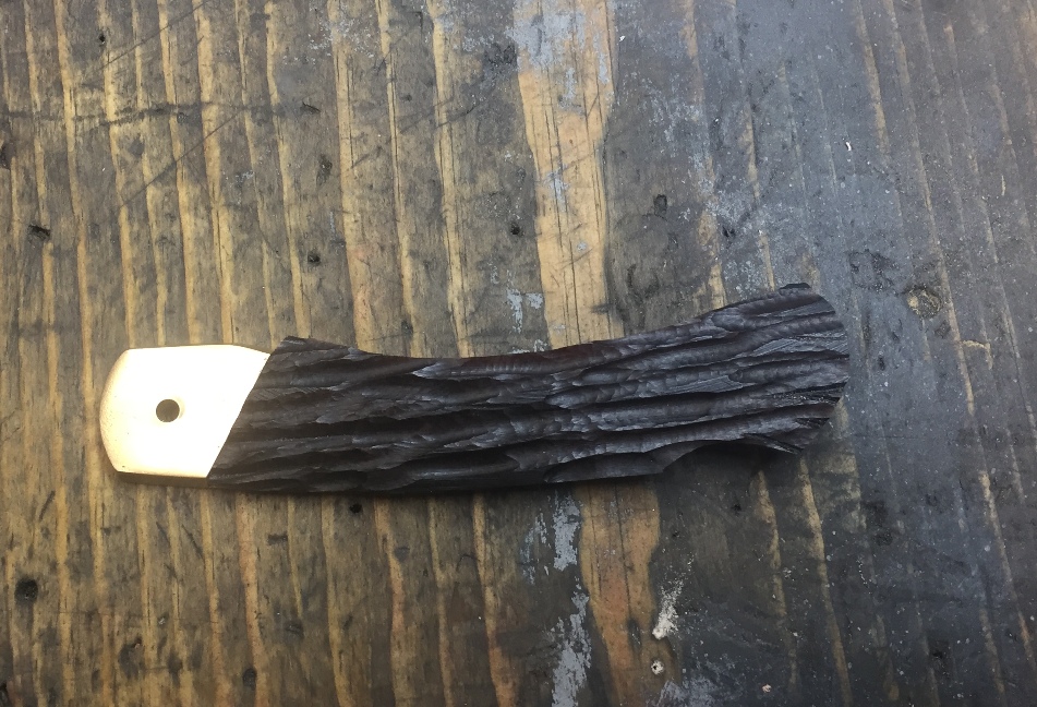

Well, I didn't get a lot of shop time in this weekend. We had a constant reminder that there was a tropical disturbance about 200 miles south of us.
I did get a chance to get out there yesterday afternoon for a few minutes.
Here is my progress......

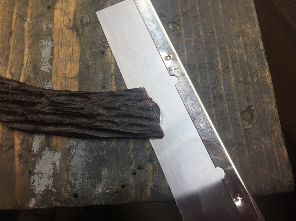

I got the scales cut to the rough shape on my band saw. Then I started to fit the scale to the bolster since there is a tab that fits in under the bolster at the front. I did a lot of filing to get this first one to fit. Then on the second one I thought I would try a different method. I got out my Exacto saw and cut the edge straight down to where the tab thickness should be and then cut in from the end. Then with minimal filing, I got #2 to fit. Then came the glue-up. This is only a 5 minute epoxy SO, I am not going to be depending on it to hold the scales on. I am going to add a pin where to old lanyard hole was. (I don't care for lanyard holes).... I did a little bit of filing and sanding on a scrap to see what this scales material was going to look like when finished. Looks pretty good.
The one complaint I have is that this scale material was not the thickness I expected. The old material is 3/16" thick.... so I figured 1/4" would be what I need to be able to finish the handles out like I wanted. Well... one of them seems to be even less than the 3/16" of the original. Now, the 3/16" is true at the TOP of the ridges. SO... the grooves are much less than 3/16".... I guess since I got lemons, I will have to make some lemonade.
More to come.
More to come.

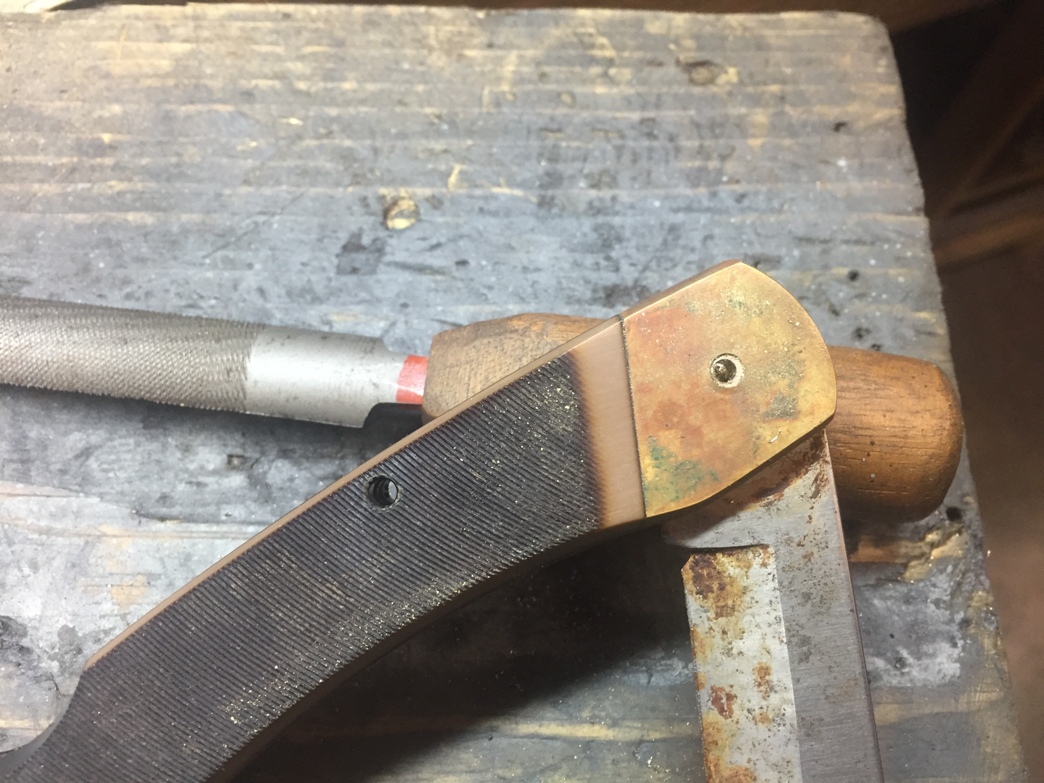

Re: Next up on the repair list.... a 6 OT

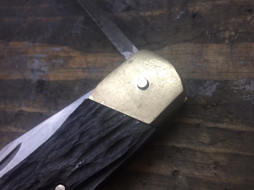

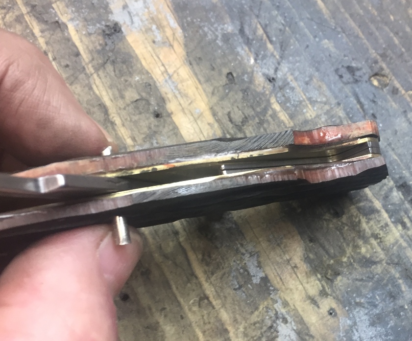

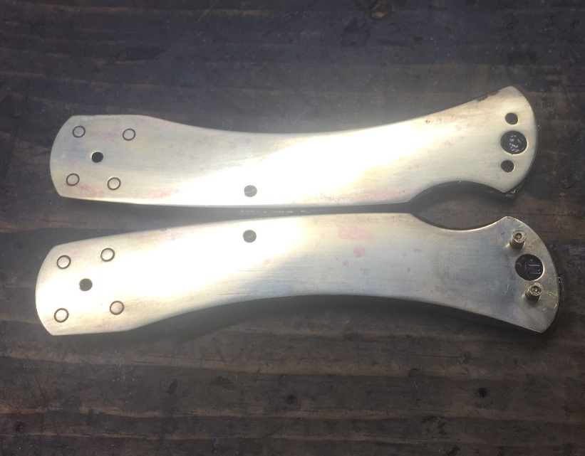

OK.... here goes....
Part 2 of my 6 OT repair....
I got the sales cut to the rough shape and fit to the bolsters to my satisfaction. Then I glue them on.... The inside surface of the scales were cleaned up and ready for reassembly...... I drilled my holes from the inside with a bit that matched the holes in the liners. Then, I found a nickel pivot rod that was the size of the holes.... I put the springs in, the lever and blade for a mock up fit..... The hole on this side was a LOT bigger that the hole on the opposite side so I started peening here first so the brass rod would fill the hole..... After the pins were tightened in, then came the shaping and thinning of the scales. A lot of filing and sanding got the scales to this point. Then it was time to put in the shield.

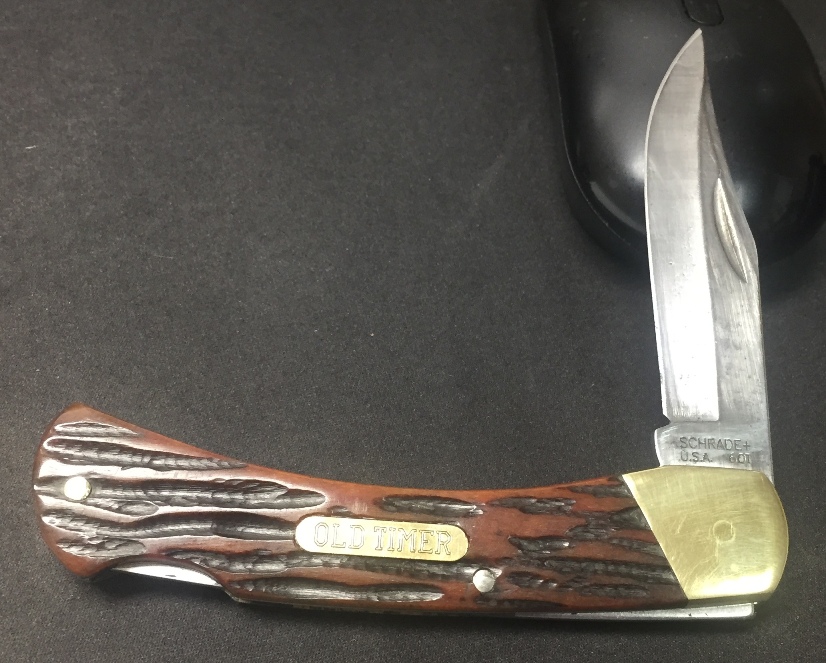

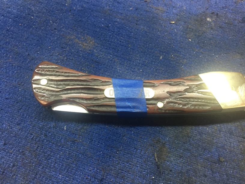

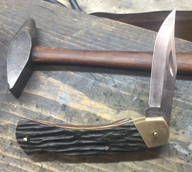

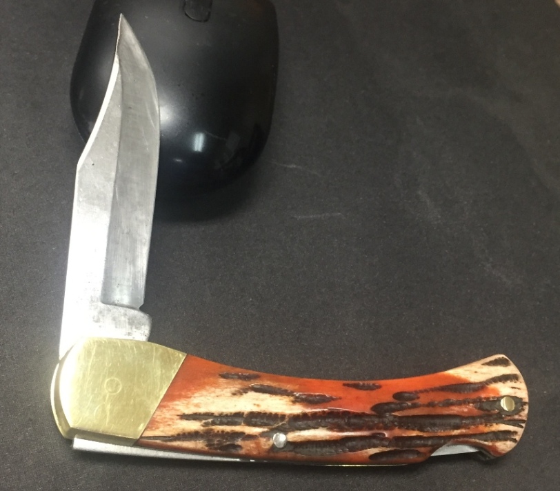

So here she is....
My referb of this 6 OT...

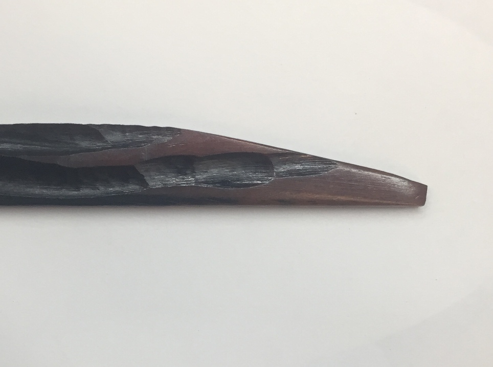

Before..... After..... Pile side..... I am NOT happy with the scales I got from......... Midwest Knifemakers Supply..... (or maybe USAknifemakers?? seems they have 2 names)
The dying process was not as thorough as I would expect and the thickness check / control was poor.
Thanks for looking everyone!

Sweet! 100% better than you original meltdown. Too bad about the poor dye hid in the bone, but that's part of the character of the knife now. I like it better without the lanyard hold. You did good!

Thanks so much....Byrd wrote:Sweet! 100% better than you original meltdown. Too bad about the poor dye hid in the bone, but that's part of the character of the knife now. I like it better without the lanyard hold. You did good!
I am so OCD that it bothers me that both sides are not the same. I would have been happy if both sides would have looked like the pile side. OH WELL..... onward!
I don't like lanyard holes so mine had to go. I know it doesn't have all the characteristics of a 6 OT but the scales aren't original either.... LOL... (Justification...LOL)

Outstanding work! That knife turned out great!

You can probably even the handle color up with some potassium permanganate or even some leather dye.
