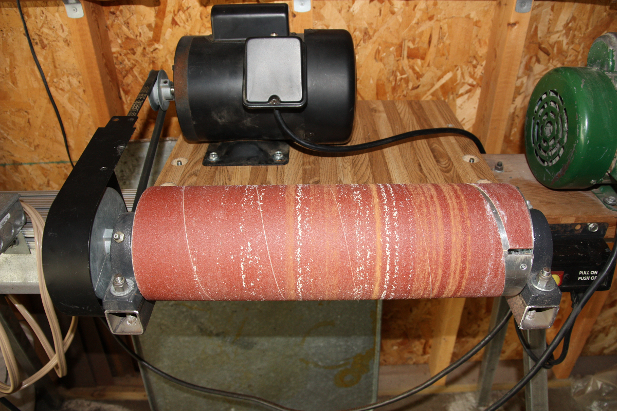

Awhile back when I was still working, I salvaged this drum from a Performax 16-32 drum sander that the customer decided he didnt want to fix. It is an aluminum drum 5 inches in diameter and 16 inches wide. These sanders were used to thickness sand boards with a power feed system that carried the board thru under this drum. Anyway, I decided to see if I had enough parts to throw something together. I ended up with this drum sander with a 1 1/2 HP motor from a junk contractors saw and it actually works good. Just the thing for hafting knives and sanding those serpentine stockman that are getting rehandled. The abrasive is a 3 inch wide strip tapered at the ends and spiral wrapped around the drum. There are spring loaded clips on the ends to grip the sandpaper and keep it taut. One thing that would be nice would be if it had more than one grit on the drum at once. Maybe I can rig something up.

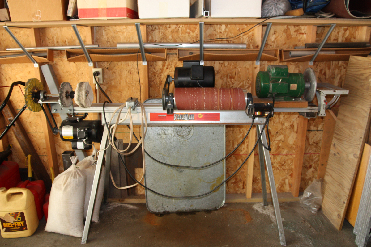

I mounted this drum sander along with my other knife working tools on kind of a "sanding center" that I made. I bought a folding metal saw horse (yeah, I actually bought one), and I had salvaged an aluminum t-slot rail left over from an old multi spindle drilling machine. The aluminum rail held a set of air operated hold down clamps that held the workpiece while the multi spindle drill came down and drilled umpteen holes at once. The rail has t-slots all around to mount things on.

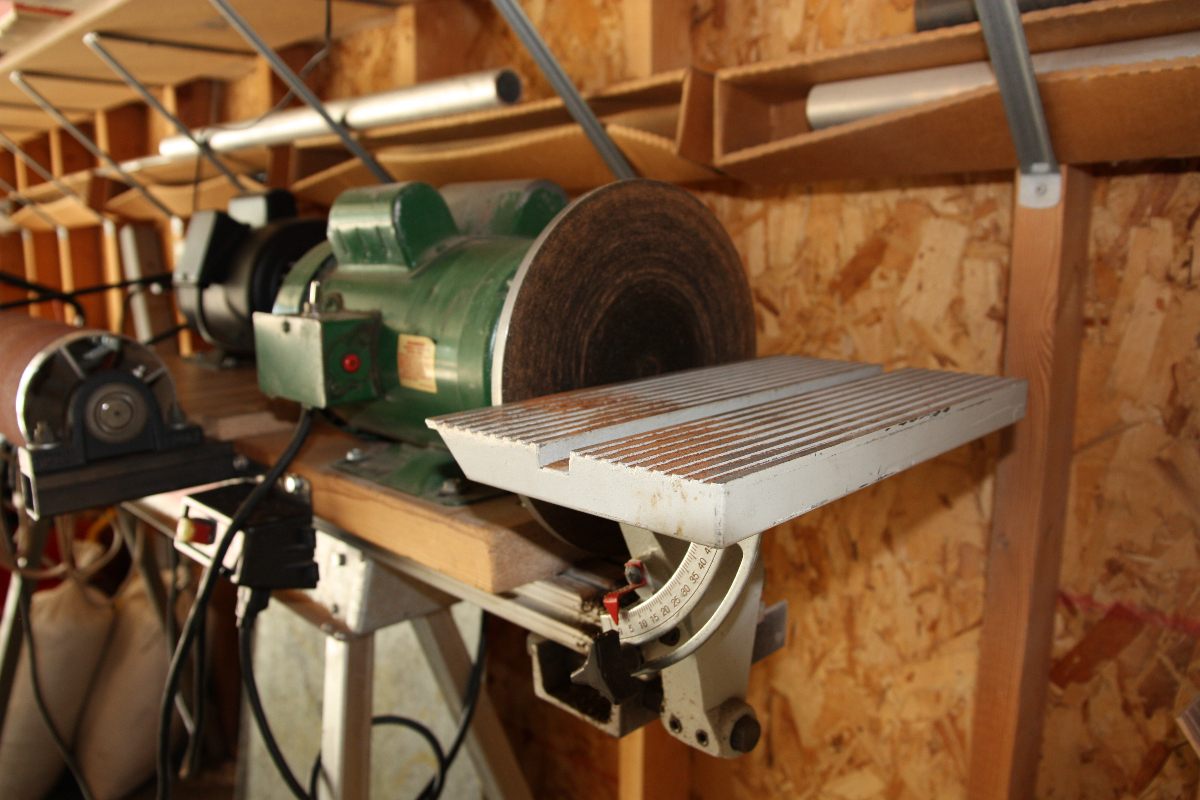

A 9 inch disc sander for flattening with a 1 1/2 HP motor.

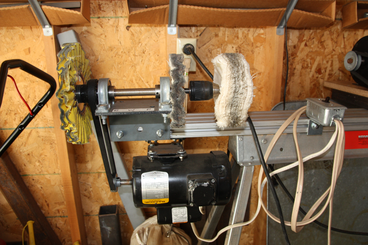

The buffing wheels are on the left end with a 3/4 HP motor.

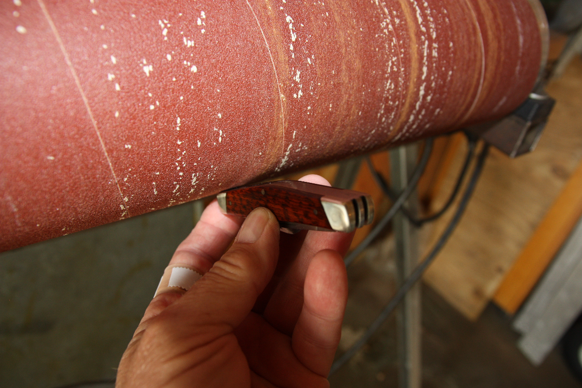

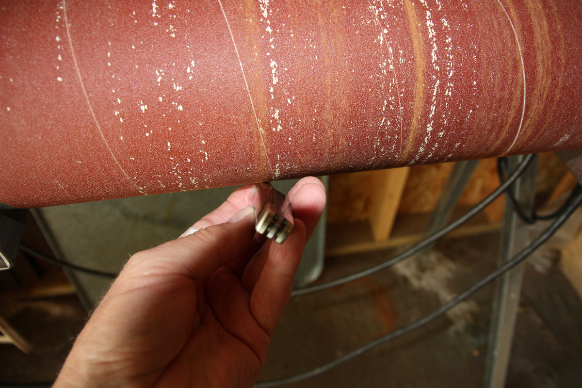

The 5 inch sanding drum works great for bringing the handle material down to the liners, especially on serpentine and other non-flat back knives. I have 80 grit on it now, and go from there to a finer rubber backed drum turned by a mini lathe with a drill chuck for finishing. For the last project which included making new bolsters and liners, I used the 5 inch drum to put a 45 degree bevel all around the knife to break the edges. Hand sanding blocks with progressively finer paper turn the 45 degree bevel into a rounded edge.
I don't have much in this as most of the parts are salvaged from something else, all 3 of the motors were salvaged from junked tools. As Dale mentioned, there is a book "The $50 knife shop" showing how to make many things that are useful. I ended up with this unit being the way it is because of the salvaged parts I had to start with.
