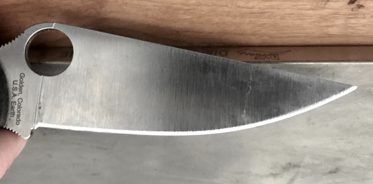

This is a Spyderco Military in S30V, a very hard steel that some folks have trouble sharpening. I had totally destroyed the edge stripping double coated wire and doing general farm chores. So today it was time for its first real sharpening. Three or four light passes on a 150 grit belt on my 1x30 belt sander followed by polishing it up for a few strokes on a DMT diamond hone 8k grit just to remove the wire edge and polish it up a might. It’s toothy, as in it’ll grab your finger when you test it, and it’ll shave hair with out pulling. No assorted series of complicated stones needed. And the total time including walking from my shop to the house to finish on the hone was about 10 minutes. If my hone were in the shop, maybe 5 if I hurried.Woody's Workshop wrote:I figured about $1 per inch on straight edged blades if you don't need to remove chip, dents (like someone used it as a screw driver) and other defects.

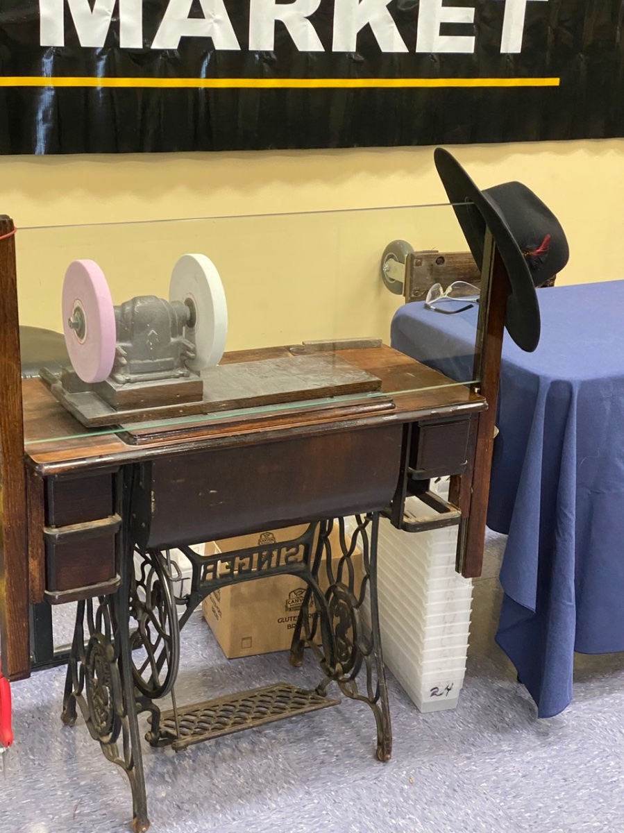

I make a living sharpening things, knives, scissors, axes, mower blades, nearly anything with a dull edge.
It can be done BUT you have to be mindful of the customer’s mindset. You also need to rethink what is sharp. If you are going to spend 30 or more minutes to sharpen one blade you will not make out in this business.
I sharpen using slow rpm wheels for knives and scissors, a slow belt sander for some scissors and garden tools and various hand tools for other things. I do not have a brick and mortar storefront but was fortunate enough to be invited into a local grocery chain after the owner saw me in a farmers’ market. I still do fm’s and other events. I also sharpen salon tools on a different machine specific to salon shears. My schedule in 2019 included about 480 events. Next year there are a few more.
To be successful in this business you need the right mindset and a steady flow of customers. I am constantly on the lookout for new venues.
It may be a labor of love but it is still a labor. We will celebrate 10 full time years on 31 October.

Sorry for the slow response. For kitchen knives, I charge $1.00 per inch for straight edges, $1.50 per inch for serrated edges. Each blade is tested before returning it to the customer, for sharpness, I use cash register tape. Flimsy and tough to get a cut started, it shows if the edge is sharp and if there are nicks present. There is also a visual inspection of the edge. Sharp is great, BUT customers expect pretty also. No wavy lines, no wheel excursions into the flat of the blade, you get the idea.
It rarely takes longer than 2 minutes to complete an edge.
Kevin

Thank you for that information Kevin. I’ve often thought of setting up a sharpening booth myself. You mentioned the slow wheel set up, is that a Tormek or similar set up?StrawHat wrote: ↑Wed Sep 16, 2020 10:59 amSorry for the slow response. For kitchen knives, I charge $1.00 per inch for straight edges, $1.50 per inch for serrated edges. Each blade is tested before returning it to the customer, for sharpness, I use cash register tape. Flimsy and tough to get a cut started, it shows if the edge is sharp and if there are nicks present. There is also a visual inspection of the edge. Sharp is great, BUT customers expect pretty also. No wavy lines, no wheel excursions into the flat of the blade, you get the idea.

Well, let say it is an Amish Tormek. I took an old (1913) Singer sewing machine base and adapted an old belt driven pedestal to it. My wheels turn about 85-90 rpm.

Pictures??
StrawHat
- Posts: 65
- Joined: Tue Sep 24, 2019 1:16 pm
- Location: NE Ohio
Re: How much to charge to sharpen knives?
Pictures??
[/quote]
Here is an old one but it will give you an idea of what I devised and use.
