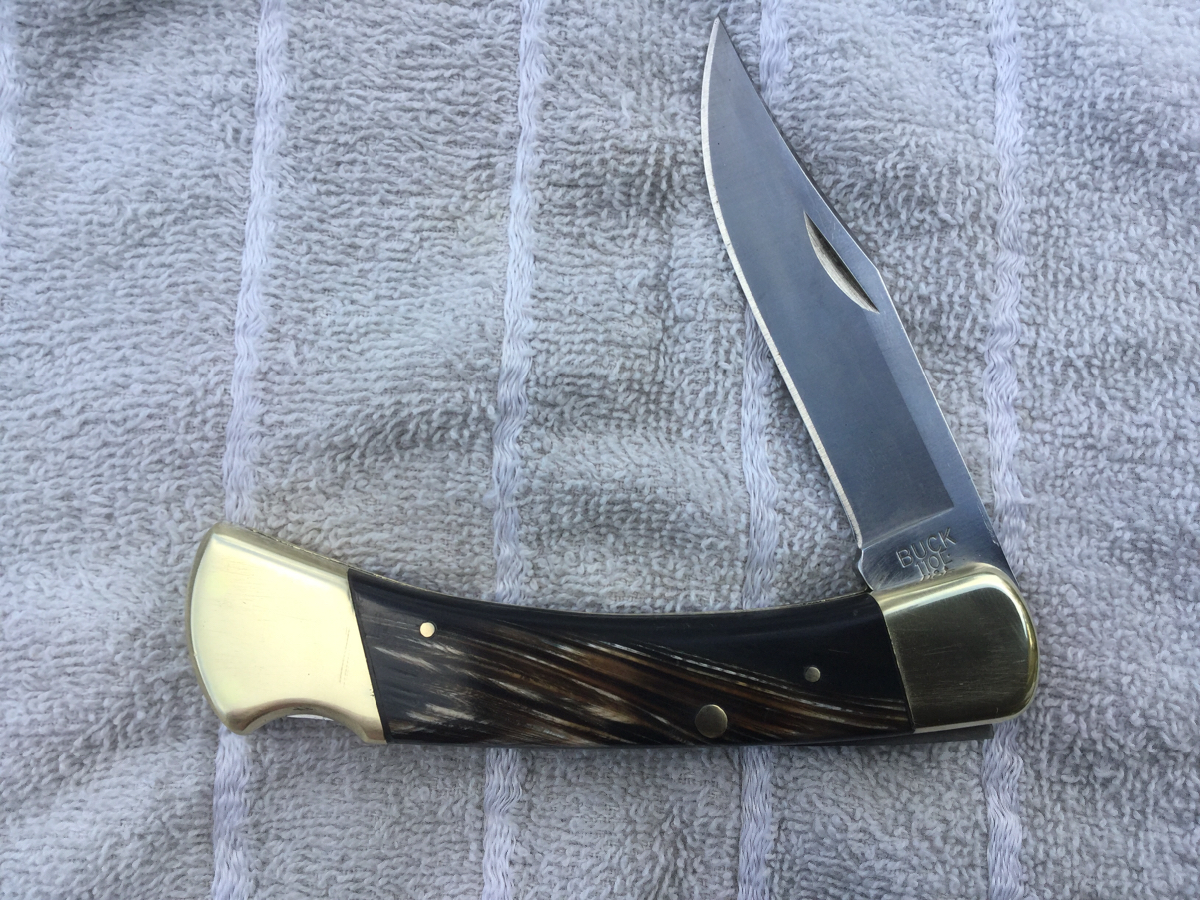

I modified/customized a Buck 110 that I have. I removed the wooden scales, replaces the center pin and made new scales from buffalo horn. I attached the buffalo horn scales by roughing up the mating surfaces and gluing with slow cure epoxy that I have used for years with no problem. The center pin is covered by the horn scales, and no pins were through the scales. Only epoxy held them on. Well, a week into carrying it and showing it off (it is a beauty) one of the scales came off. So I cleaned, re-scuffed, and re epoxied with a new epoxy. Held great for a few more days. Then popped off again. ::shrug:: Any ideas? I have seen YT videos of them just being epoxied. Are those safe queens? Should it hold? Am I not holding my mouth right? .......What? where? I'm confused......as usual....

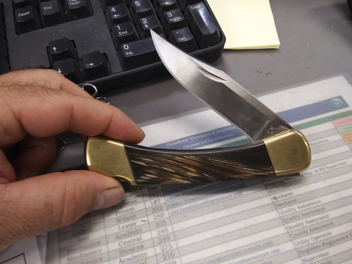

This is the one I was having problems with, but the scales are pinned now. I am at work and don't have any pics of it now.
As everybody can see, Buck 110, I made buffalo horn scales. Beautiful, but didn't last in my pocket.
Tom

The horn does make it look nice! ::tu:: ::tu:: ::tu::
