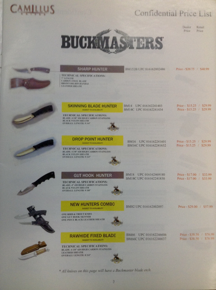

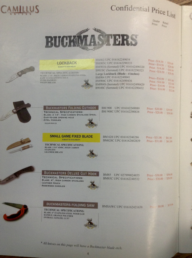

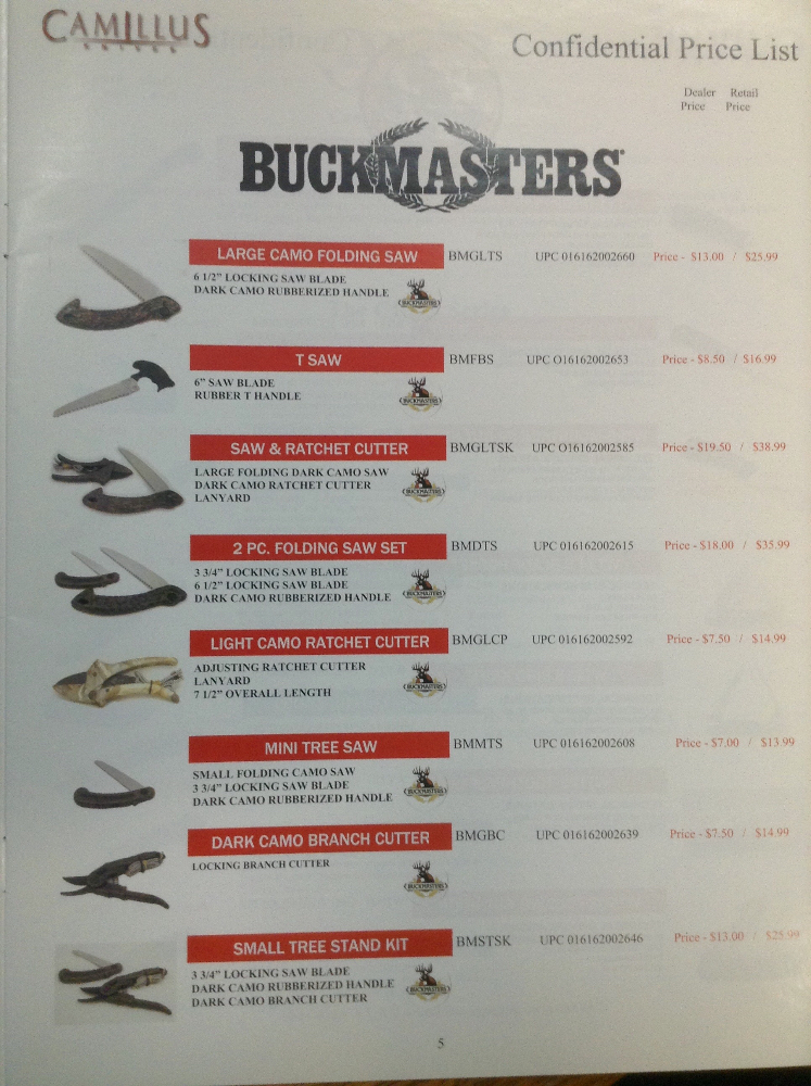

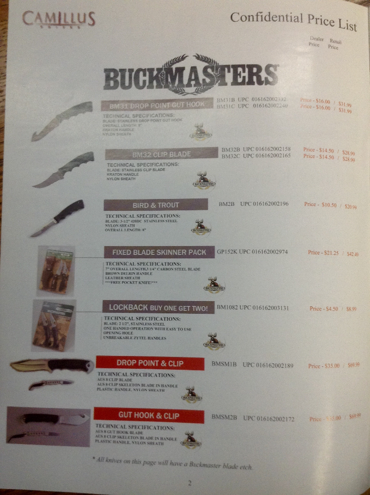

Re: Camillus made Buck’s
This is all the info I could find. From my 2006 Camillus dealer catalog.OSCAR wrote:Is there any way to tell if Camillus made a knife under contract for Buck? Not all the Buck I have has the symbol to show what year it was made. While the exact year is good to know, I’d be more interested in finding out which may have been made by Camillus. I’m a fan of both Bucks and Camillus’. Thanks.
Click the picture to enlarge.

Pretty sure the Millennium Trapper c.2000 was the last knife Camillus made for Buck.New_Windsor_NY wrote:This is all the info I could find. From my 2006 Camillus dealer catalog.
