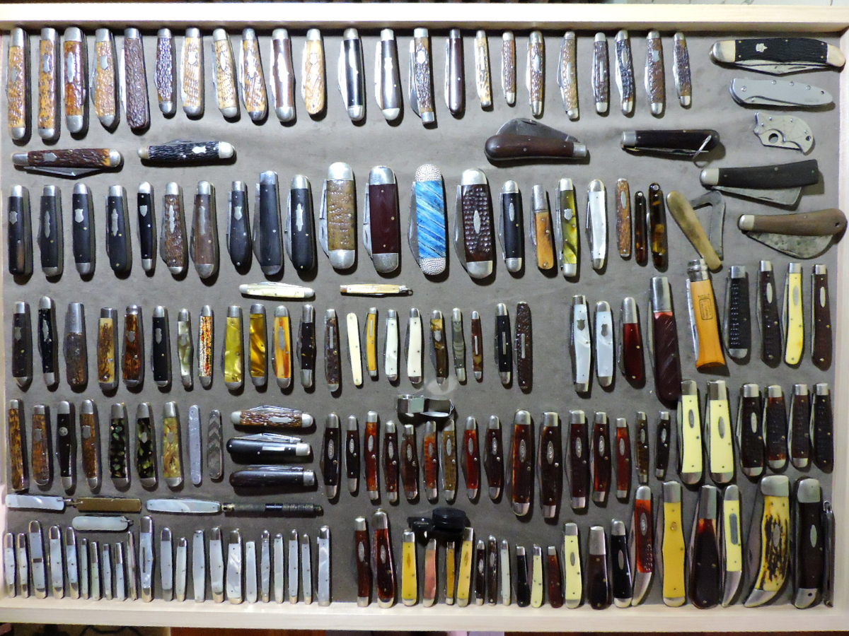

treefarmer wrote: it seems everyone agrees we should keep them away from anything resembling a collectible.
Treefarmer
Ha! It's true.
Pick out a knife here and tell me you want to run it on a belt sander.
Just the word "sander" gives me the shivers.

My, my!
Great pile of knives, FRJ! I can see why you don't want to grind on any of them with a Work Sharp.
Treefarmer

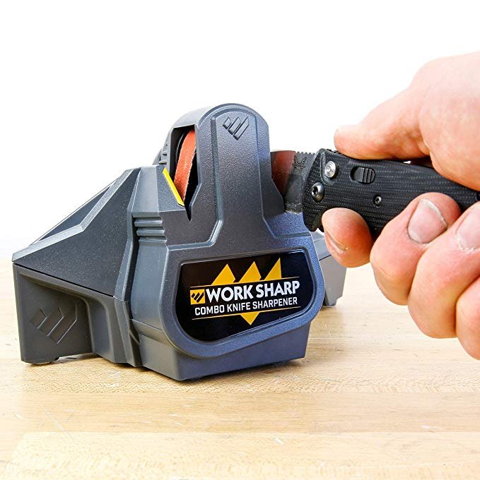

BatJak
- Posts: 137
- Joined: Thu Nov 02, 2017 12:59 pm
Re: Work Sharp
Mine is a different model than the original.
The belts for the original don't fit.
I did find some from a 3rd party that fit, though.
Here's a little better pic of it.
It's smaller than the original model.
