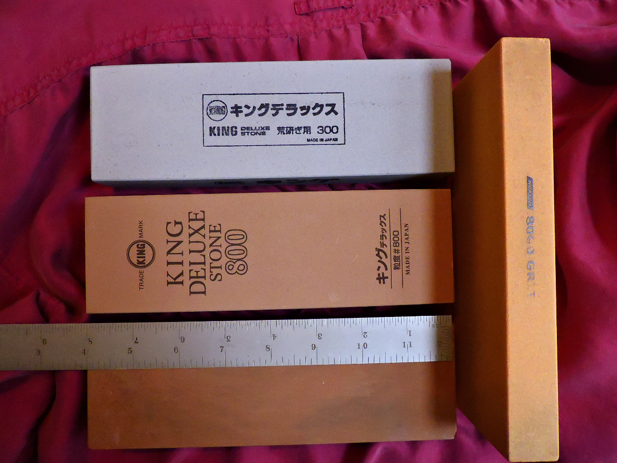

Art, if you are new to water stones and have used stones before you are in for a nice surprise.
They work very efficiently and very quickly. Especially the low grit stones. They are soft.
If you are not careful you can actually cut into them, slightly, when your edge gets sharp. I have little scares on mine.
The lower grits, as you know, are great for creating an edge quickly and the higher grits keep the edge refined.
Same as other stones but they do it faster. If you try one you will get a feel for it.
I have a 300 grit that I haven't used very much. Don't need it much. Not sure how much I like it.
I have a 800 grit that is the cats pajamas. My using knives, Pocket/kitchen, are usually in pretty good shape and this stone
brings them back to life quite nicely.
I have a 1200 stone that I like as much as the 800. Basically for the same reasons.
I have a 8000 grit stone that I bought for sharpening my wood working chisels initially. I polish an edge with it when I feel the need.
I have a combination stone with a soft/hard grit. I don't remember what they are nor do I care. I just like the grits and use it as well.
The thing is, combination stones leave a lot to be desired in terms of usefulness. You can use only one side and you can't use the edges. They cost less up front but you loose a lot. The edges are great for small folding blades.
My stones are 8" x 2 1/2" x 1 or 1 5/16". I always recommend buying the largest stone you can buy. You won't regret it.

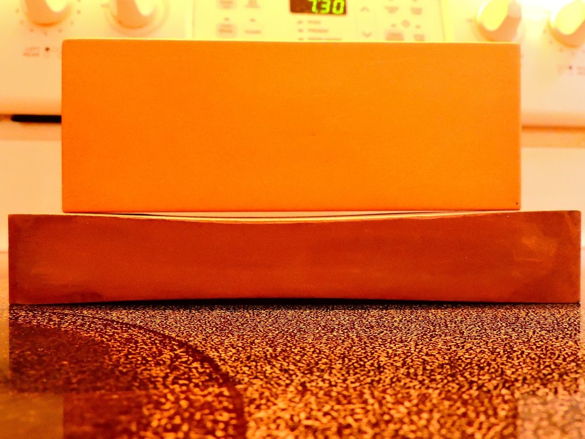

Art, the water stones are interesting, especially if they're flat.
I have this 800 stone that is dished because I didn't keep up with rubbing it flat which is easy to do if you have some rather thick glass and abrasive paper, which I do. Or you can rub the stones together to keep them flat. I haven't done that but I see where it can be done. The rubbing together must be done probably after each use with another similar stone.
Anyway ...... I gladly use that dished stone and if the stones you mentioned are anywhere near decent it might be a pretty good deal.
Using water stones is a great way to sharpen. I have many other kinds of stones and I like using them too but I keep the water stones
quite handy.
Your Smith (novaculite?) and India combo sound like great stones. Especially at 8". I can see how they would serve you well.
I probably have stones quite like them. I use water on all my stones.
Honestly, if a guy had just a 8 inch Carborundum stone, coarse/fine grit he could get by just fine. ..... but what fun is that?
