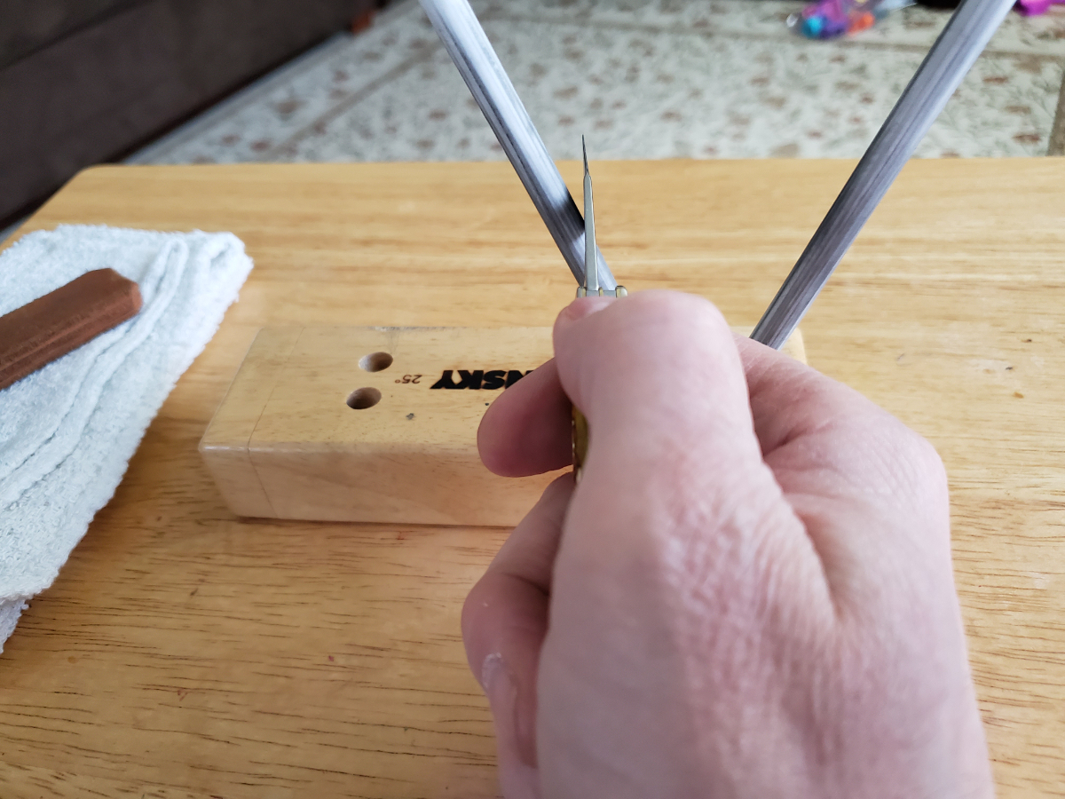

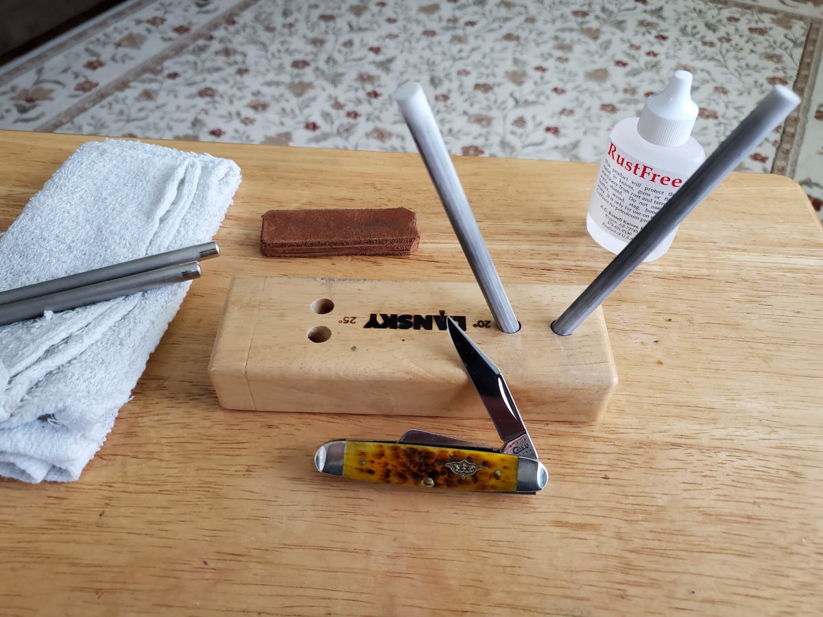

I use a Lansky Turnbox 2D2C. Super easy and gets me an edge I'm very pleased with.

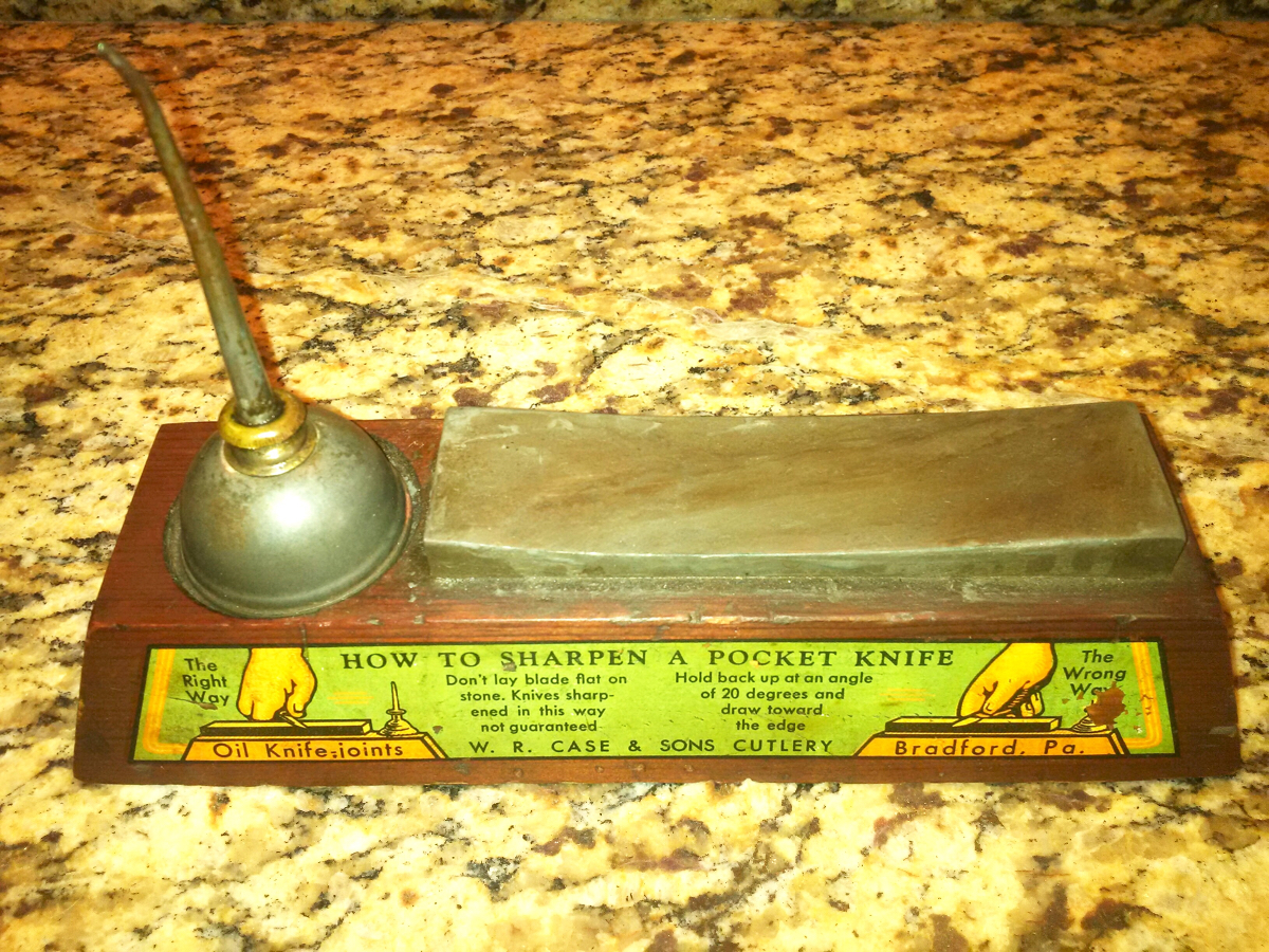

Case counter hone

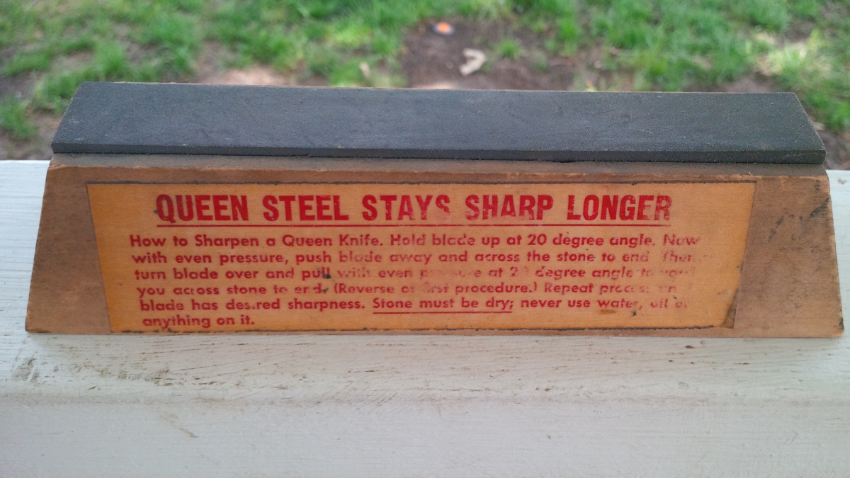

Queen counter hone
Other advice i have seen is to NOT apply excessive pressure as you move the blade edge over the stone. The expression is: "let the stone do the work".
Really there is no one single way to sharpen. Firm pressure or light pressure, both work, but keep in mind you want to remove as little steel as possible that will result in a sharp edge. When using coarse stones it is easy to remove more steel than is necessary.
As Ken has said, 10 degrees per side on a pocket knife blade would take a lot of sharpening to achieve and the resultant edge would be a bit flimsy for cutting sticks, plastic, etc. The edge would likely roll over and then seem dull until you stropped it straight. 20-25 degrees per side has long been considered optimal for pocket knife.

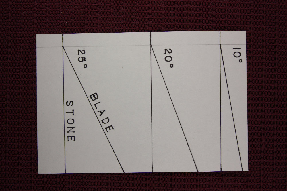

I do measure the angle using little wedges that I cut to 10 degrees using my bandsaw and a jig I made. My students put the wedge at the end of the stone and lay the blade on it with the edge on the stone. It helps the learners have a reference as to what the 10 degree angle is when learning freehand sharpening.
If the angle they actually sharpen at is a bit steeper, say 15 degrees, it is no big deal. It will still work.
It occurs to me that since almost all blades have an angle round in already, and since my procedure is to lie the flat side of the knife on the wedge, the total angle on that side of the knife is likely closer to 15 degrees.
I do not measure the angle from the center of the blade.

Have you bought any new traditional style knives lately ? If so, some of them can be 40 degrees per side (e.g. Queen). It must take a very long time to free hand sharpen these blades to 10 degrees per side ?

thickskinner54 wrote:I'm going to go check eBay for one of those Lansky turnbox 2D2C's Steve. Thanks for the tip. I do want to learn freehand though.
Hi, if you are still looking at the Lansky Turnbox, have a look at Idahone website. They have a V angle sharpener, which i think is just as good as the Lansky, better if you have larger knives. Check out the learning center on their website, it is really helpfull.
