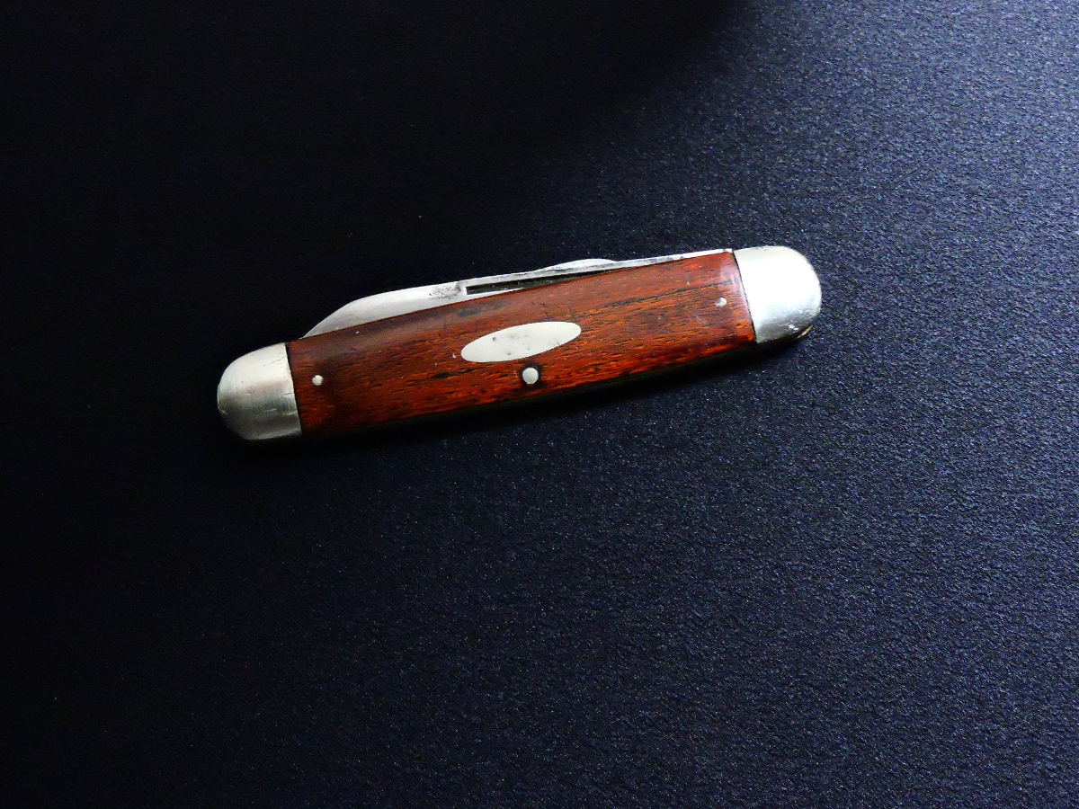

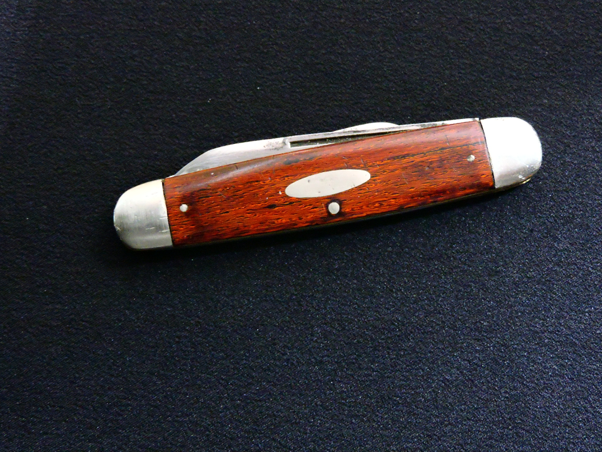

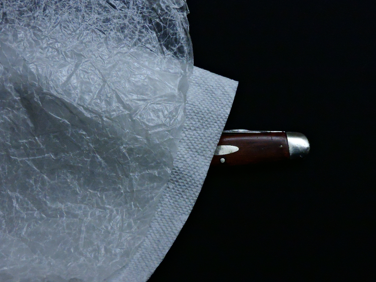

Hi Mark.knife-nut wrote:I’m wanting to get some recommendations on which scanner is the best to use for really good images of pocketknives. I heard of several people that use scanners instead of a camera. I can’t seem to get great pictures without light reflections or shadows.etc. When using a camera. Any ideas? I’m wanting to start selling some knives in a member store here on AAPK. Thanks in advance,Mark.
If you have a recently purchased camera it probably has settings for what kind of light you're taking pictures in.
Florescent, day light, sun, shade ect. It will probably auto focus for you too if need be. It may have an option that will allow you to reduce or increase light coming in to the camera. These can be helpful settings.
As to light reflections and shadows; these can be the easiest and least expensive to over come. I took these pictures in an undercounter florescent light area. Camera adjusted. Look what I used to reduce glare and shadow.
A paper towel and wrinkled wax paper.
I wrinkled the wax paper to diffuse light but It's not necessary. I could have used two or three layers of paper towel.
The paper towel is rigid enough to let me hold it under the light with one hand and use the camera in the other hand. Be steady.
I laid down a black piece of cloth. Usually I do this at a window in daylight. Same same.
Most of my pictures of late have been taken this way.
It's just controlling light and doesn't need to be costly.
Pictures 1 and 2: Dark and light exposure.
Picture 3: Shaded on left and reflection and shadow on right.
Picture 4: The magic shield. (the cheap magic shield)
I know it's not for everybody but I just thought I'd throw it out there.

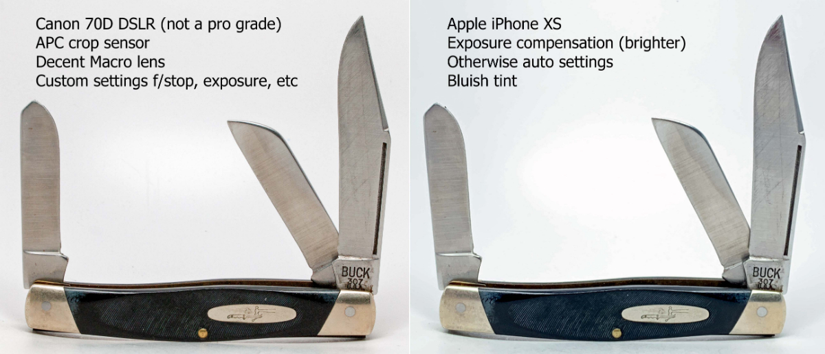

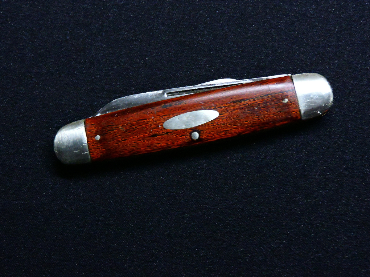

For what its worth, I agree with the opinions advocating for a camera instead of a scanner. If you have a mobile phone made after about 2016 such as an iPhone 7 or newer they have nice cameras. I don't know what the equivalent Android phone models would be, although I have read that the google Pixel 3 has a very nice camera. My experience echos what other have said with regard to lighting being the most important factor in getting a good result in a knife image.
Below is a comparison picture where the lighting was held constant for the same knife with a picture from a DSLR camera and an iPhone XS. I have a slight preference for the DSLR, but could probably fix what I don't like in the iPhone photo (bluish tint) in Photoshop. In my experience I am happier with my results when the camera is not straight-on facing the knife. This causes reflections from the shiny parts of the knife straight back to the camera. I like to have a white background that gets reflected back to the camera. The second picture below *might* communicate the point I'm trying to explain.
I have a cheap scanner built in to my printer and have never been able to achieve a result that I was happy with.

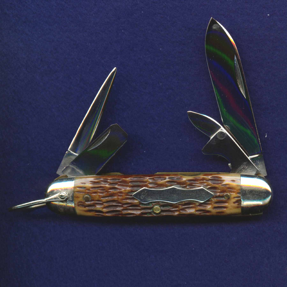

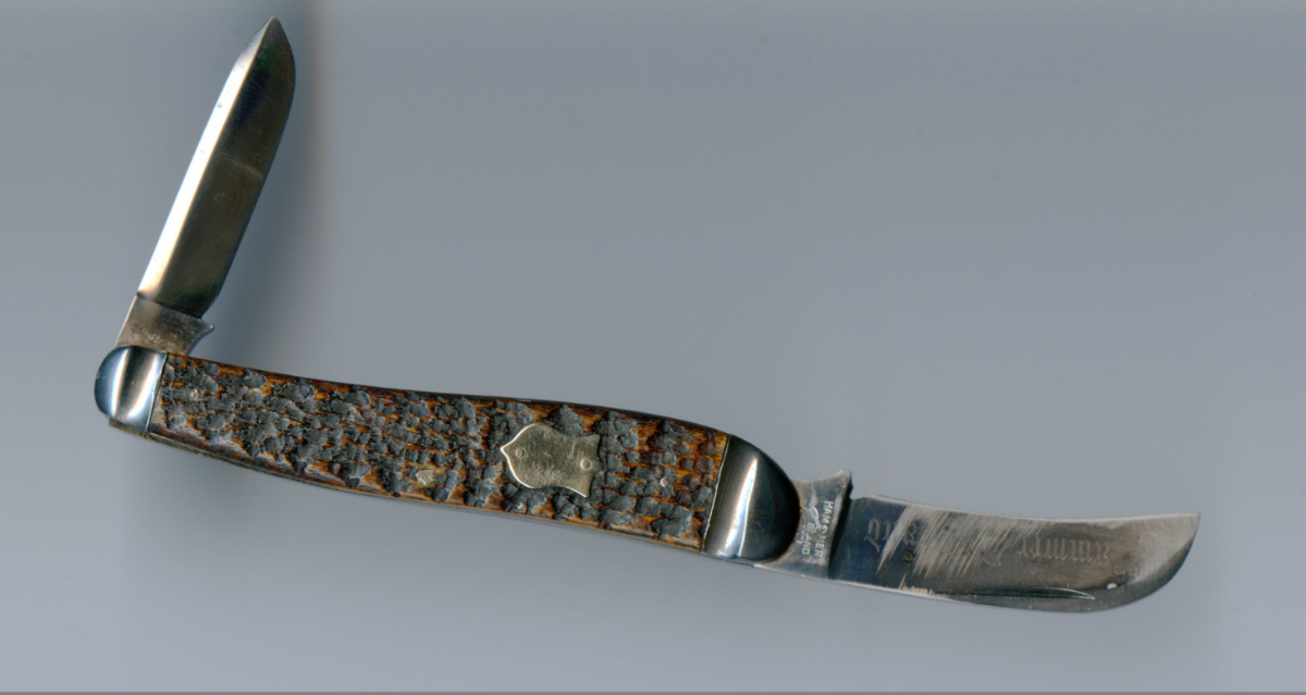

I made all my initial Robeson scans using an Olympus scanner and a shallow inverted tray lined with blue felt atop the knives and scanner bed.
Problem was that as PC's died and were upgraded and Windows Operating Systems changed, Olympus declined to create compatible software for the scanner I had.
I replaced it with an Epson that doesn't do nearly the quality of three dimensional scans.
A scanner's depth of field is critical to its ability to properly depict 3-D objects. I'm not so well informed as to address that in technical terms. We need someone more computer savvy that I to address that.
An example from the old Olympus, a four blade scout/utility, probably the highest profile knife one might own.
Do two left mouse clicks on the scan.

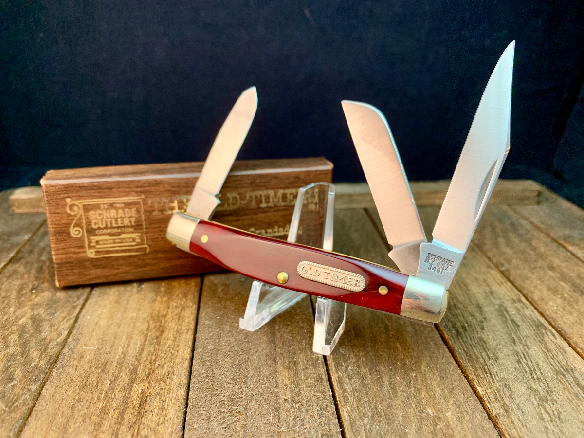

tongueriver wrote:I have propped them up with dinasaur gizzard stones, fishing weights, another knife, etc. It is frustrating and sometimes they do fall over. Conversely, when shooting the spring side of the knife with a camera, it is the same problem. I have seen sellers setting the knife into the bristles of a shoe brush to shoot the spring side of the knife.
You can get these knife stands from several dealers, I bought mine at SMKW. They don’t cost much and it makes photography a whole lot easier. Included a picture of a Schrade on a stand. I think I paid a couple of dollars or less for a pack of 3 of these.
