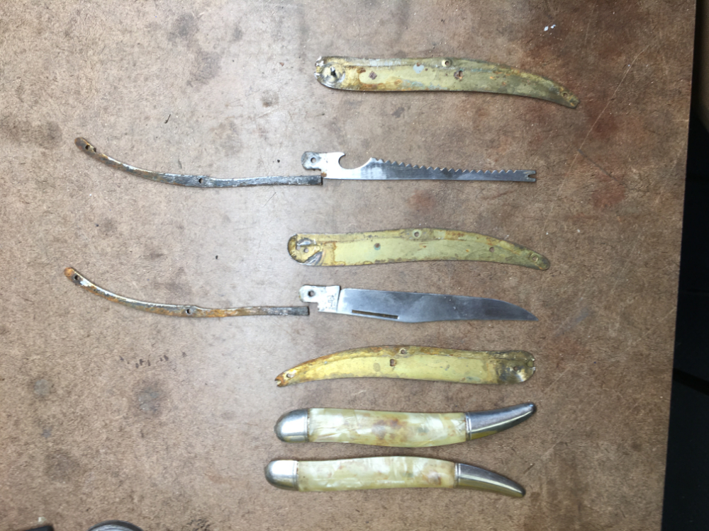

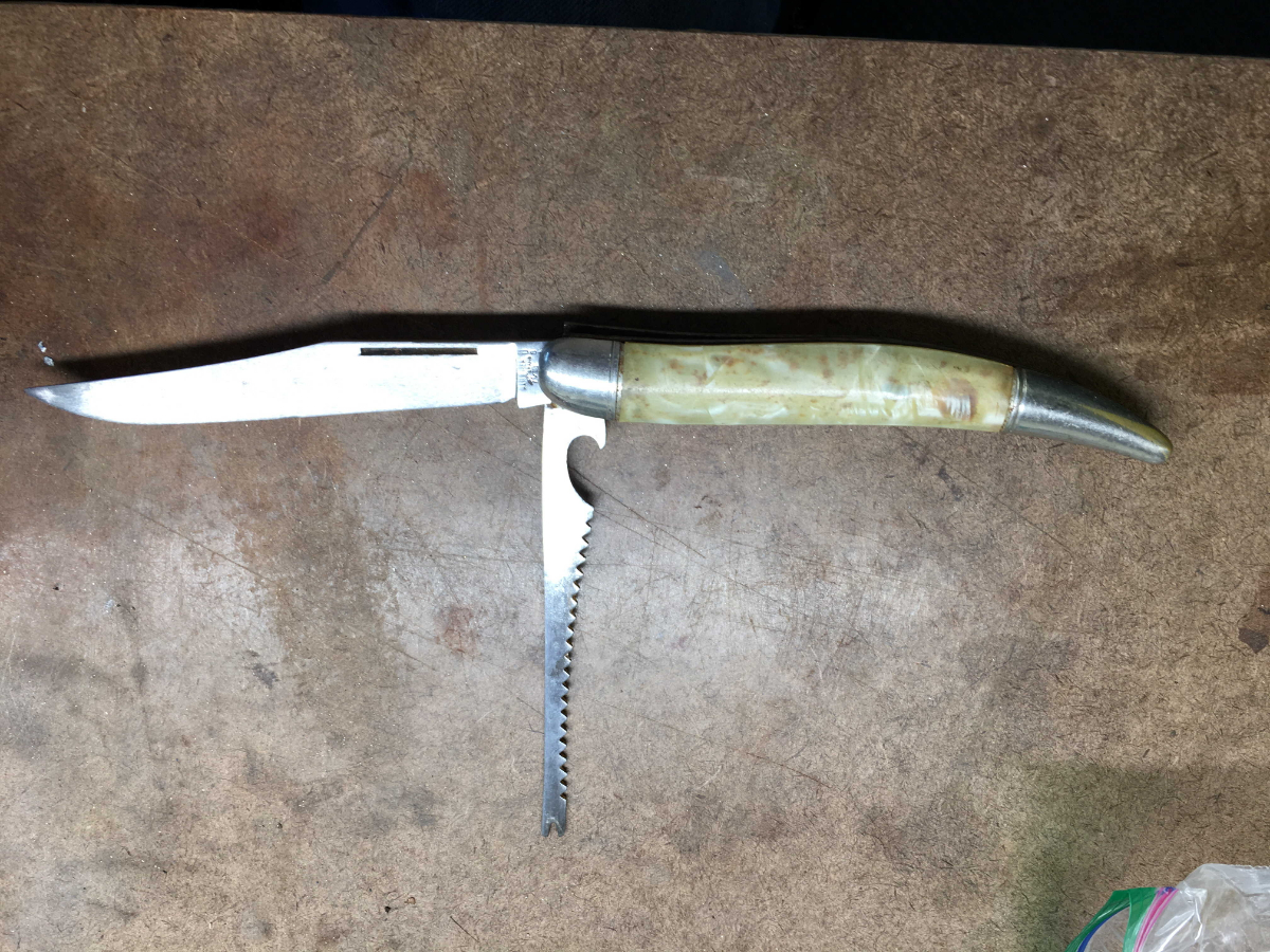

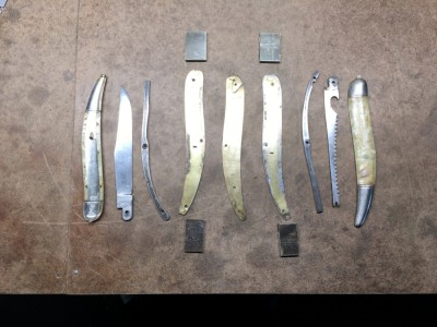

At some point I purchased a Hammer Brand fishing knife;
I didn't know at the time that they used the shell style handle construction. I pulled it out a few days ago and decided to disassemble it. It was a little rusty but not too bad considering its intended use;

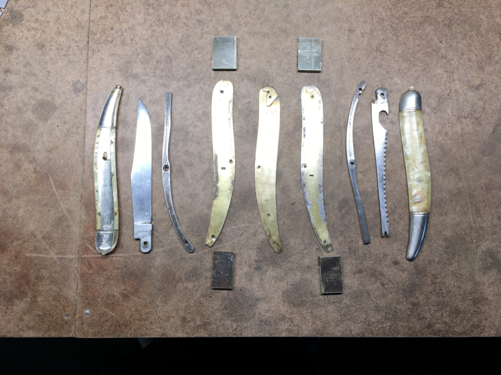

Then I cut the appropriate size pieces for the upper and lower bolsters:

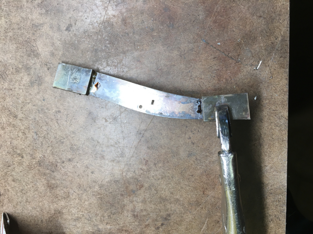

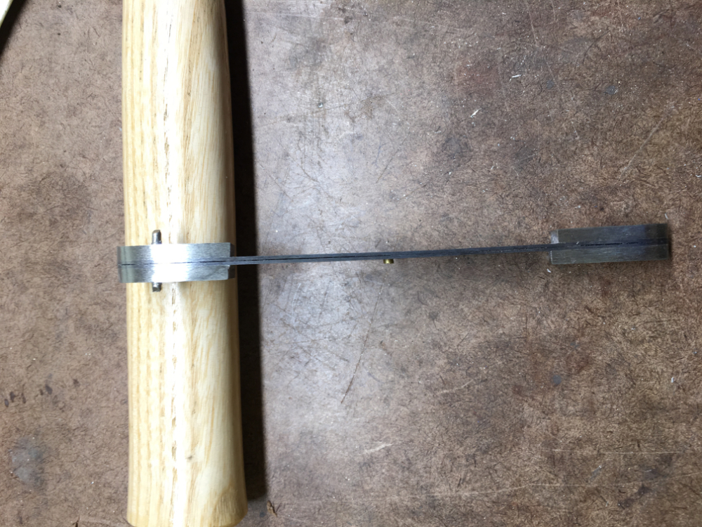

Once that was done I started the process of soldering the bolsters to the liners. I hammered the little raised portion out (where the original handle connected to the liner), sanded the liners and got them ready for soldering. The liners looked like brass but the were actually stamped steel with a gold/bronze coloring;

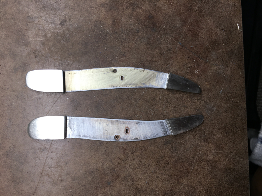

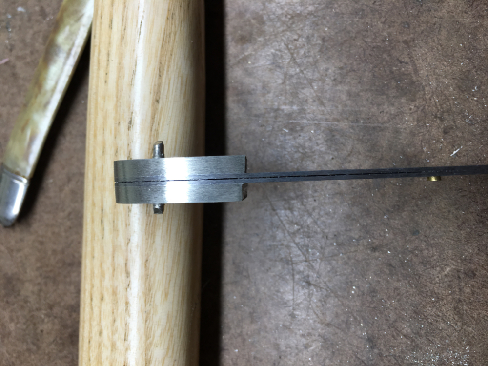

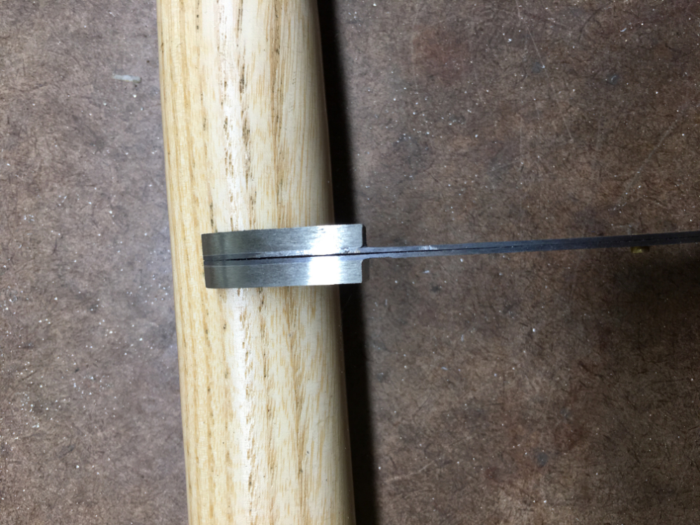

After all of the bolsters were soldered in place it was time for some preliminary grinding to get the nickel silver pieces formed to the liners;

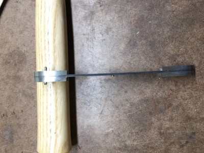

They look good except one of the lower bolsters is slightly longer than the other (I temporarily pinned the liners together so I could get the bolsters looking the same);
Some judicious filing work and the bolsters are pretty much equal;

One thing I’ve learned so far is that the belt grinder will actually heat up the bolsters enough to melt the solder (at least when grinding with 120 grit). Silver solder melts at about 400 degrees so it doesn’t take a lot to get it flowing. A small container of cold water next to the grinder to dip the bolsters in while grinding and a softer touch solved that problem.
I guess a heavier grit might have cut quicker and with a little less heat but 120 grit was the coarsest I had at the time (made a mental note to order a few coarser grit belts).
