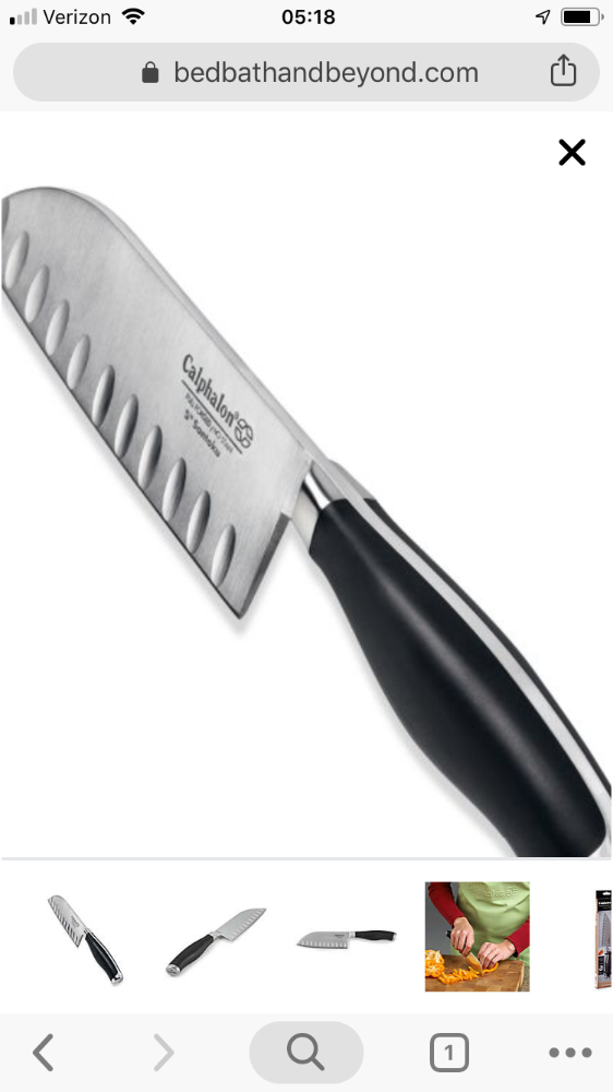

Dimpled blades on kitchen knives?
What purpose do these dimples serve? More importantly what happens when the edge gets past a few sharpening s and is into the dimples? Seems to me this knife has a very short life span. Am I missing something?

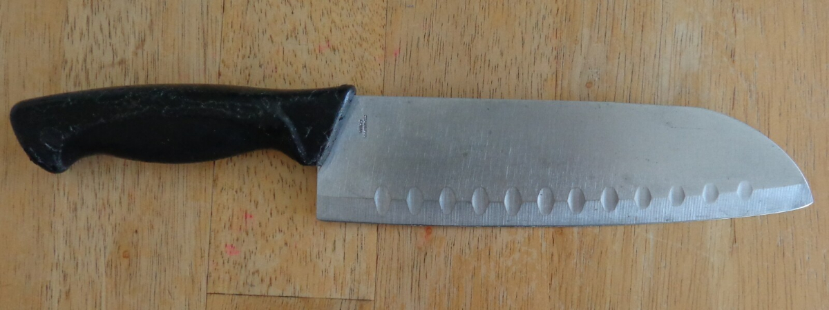

Re: Dimpled blades on kitchen knives?
I believe that style blade, or knife, is called a Santoku. It seems to me that it does help some with the sticking, but not a lot. On most Santoku knives the dimples are far enough from the edge that a normal lifetime of sharpening is not going to get into the Grantons. Unless you use a machine to sharpen, anyway. Here is one that is my wife's favorite kitchen knife. It is a Chefmate: not an expensive knife to begin with, and the handle is chipping away where it hit the knife block. I have kept it sharp with various whetstones for twenty years and not hit the Grantons yet.

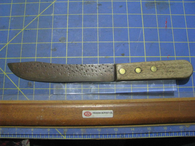

Here's an old Remington with a LOT of dimples........
