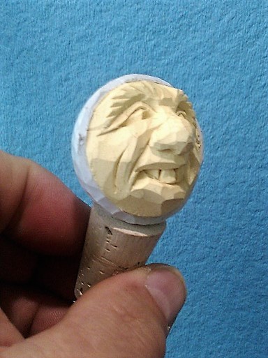

Here are a couple of golf ball "trolls" that I made.
One has been mounted on a cork - with a dowel through it, and the other one is still on the handle.
Most golf balls these days are of two piece construction - the outer cover and the rubber inner core. (some are made differently)
There are lots of different colors in the inner part depending on the brand and compression and ??? of the balls. They take acrylic paint well too.

OK
I am obviously not good at posting pictures etc. I see after posting that what I thought were three different pics were actually all the same!
I don't know what went wrong

clicking on the links will get the other pics.

Those are cool! Thanks for sharing them. I’ll have to give it a try sometime. But I’m not very good at faces.

After drilling the hole and jamming in the handle (it is best if you make that handle a little oversize so that it is necessary to force it into place), draw a line around the ball, and then using a hacksaw, carefully cut all the way around the ball along the line. You will feel the saw go through the cover.
Then using a screw driver (hopefully a worn one without sharp corners) pry off the half of the cover. After a bit of fiddling it will pop off.
Then whittle away!
Then whittle away!

Actually, the rubber insides of most golf balls is easier to carve than basswood. No grain to contend with either.
One thing that is a bit of a concern is that when a cut is made and the knife removed, there is no visible line left! The cut is there, it is just almost impossible to see.
