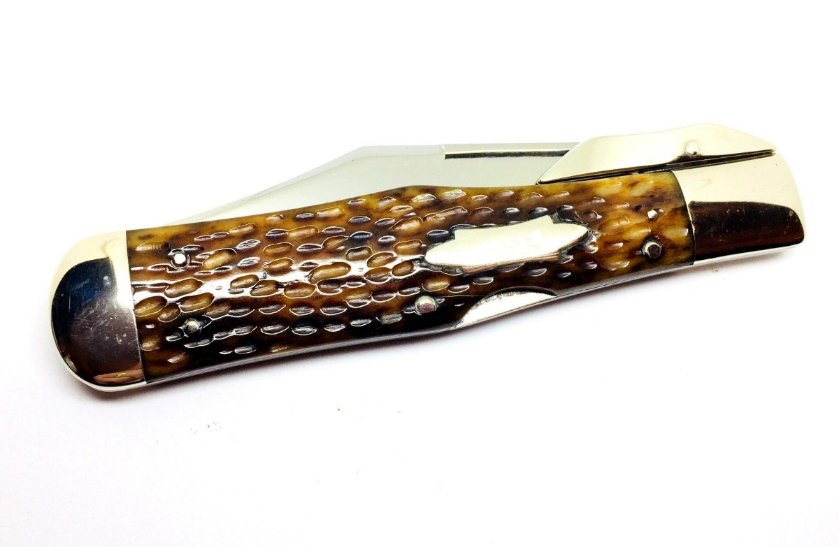

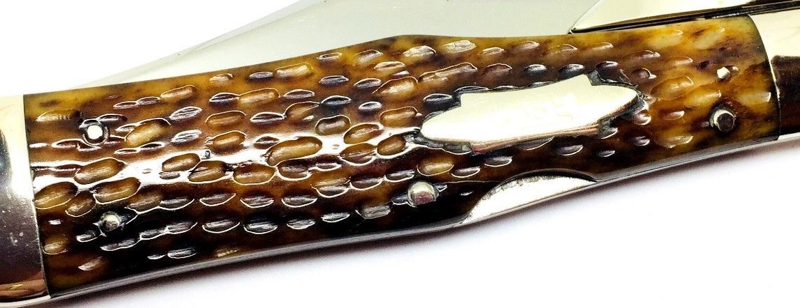

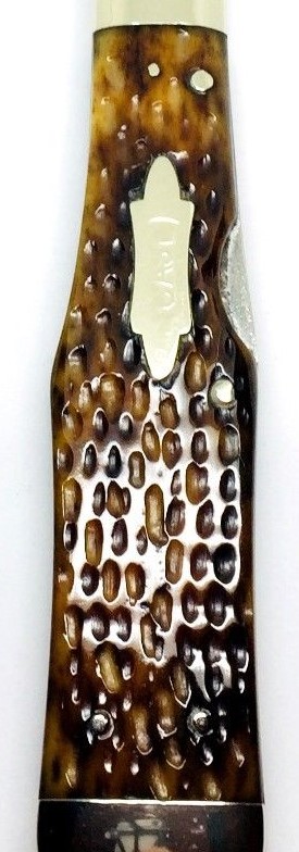

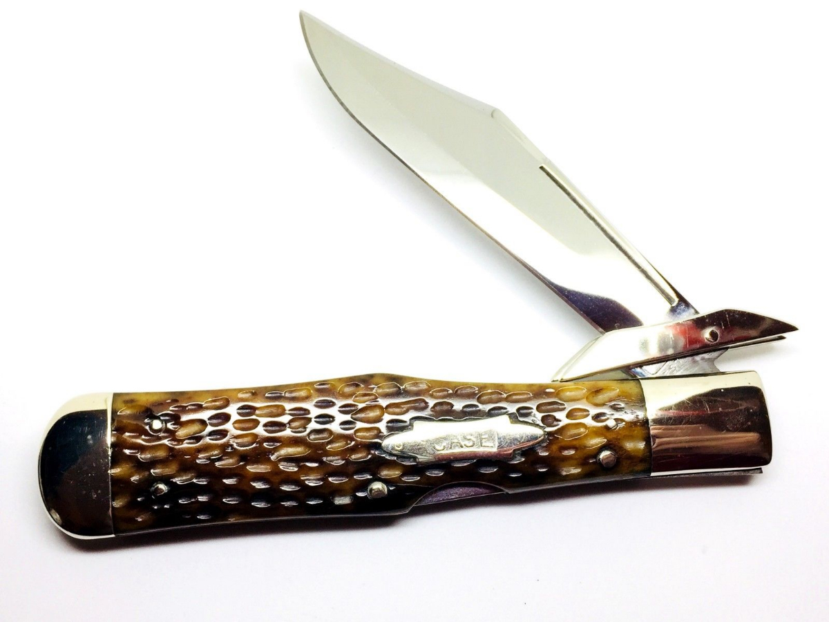

I came across this eBay sale and immediately thought the bone handles looked to be hand jigged with a dremel type rotary tool. I notified the seller of the same and the sale was immediately taken down and that he said he would check it out. The seller later replied and informed me that he had verified the handles were correct and the sale was reposted.
The overall color of the bone is not in question but I have never seen factory jigging on a Case knife like this before regardless of age. Other than the large oval dremel type cuts it is highly unusual for any dyed and jigged bone to be of lighter color in the cut out recessed jigging than on the surface. If understand the process correctly the bone is first jigged and then dyed. After the knife is hafted any additional shaping tends to remove the outer surfaces that have absorbed more dye and consequently expose lighter colored bone.
To me the handles almost look like they could be original but that for some unknown reason someone at sometime decided to go over the original jigging and hand jig the bone with a rotary tool. Notice that it is the large deep oval jigs that have the light color recesses. Not sure exactly what is going on with the handles but they certainly don't look right to me.
I am not posting the knife in the counterfeit section but would like to see some comments as to what other members think about these handles.

I have never seen any jigging like this from the factory. I agree with you it looks as if it has been done with some kind of rotary tool. It’s not even close to the tested era jigging in my opinion. Don’t really understand why one would go through such lengths to do their own style of jigging. It’s not even close to the original style jigging of that era. Good eye Wayne.

The jigging does not look right to me. The “rejig” idea sounds plausible to me. The shield looks to show significant pocket wear. Maybe the handles were worn smooth and someone decided to enhance the depth of the jigs. The handles in their current condition look artificial to me.

I think Jerry is right on someone trying to enhance the original jigging.

The whole knife is just so overly cleaned messed with. Seems to be somewhat typical on many older Case knives.

In my opinion, it looks like newly jigged old bone.

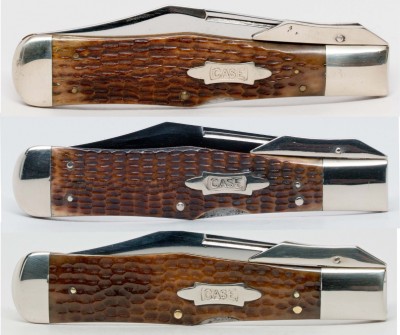

Here are some examples of what I think the bone should look like on a Case Tested XX C61050L. There is variation in the jigging across these 3 examples, but none of them resemble the original post knife.
Re: Case Tested Jigging
Looks like 3 good examples from various years of the tested era. Not one looks like the jigging on the knife in question. I agree, I think someone has decided to redo the jigging after handles were worn smooth..?
Going back and looking though my 180+ Greenbone Knives there not one with jigging like the one shown

That’s the only explanation that makes sense to me. Wayne’s OP is right on - Case dyed the bone slabs AFTER jigging. Then during the halting process after assembly, bone is removed in the high spots, not in the bottoms of the jigging. The jigging marks should be darker than the surrounding bone, not lighter.1967redrider wrote:In my opinion, it looks like newly jigged old bone.

I agree that the jigging looks odd at least for Tested era jigging.
However, photos are not that great, appear to have too much flash. I would have liked to see the knife in hand. As others have stated, the basic knife looks to be an original Tested.
One possibility is that the bone and jigging are original and correct, but the odd appearance is due to pocket wear and/or perhaps buffing/polishing of the bone itself. Just a possibility.

The authenticity of the knife doesn't seem to be in question. To destroy the knife is silly. Doing work on a knife isn't wrong either. When selling a knife they just need to be disclosed. Someone wanted a fresher jigging on the knife. That's fine but you can't say the knife is factory original. No matter who is selling it. I get knives repaired just like others do here. Jmo.

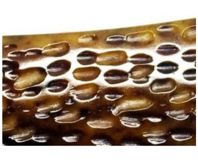

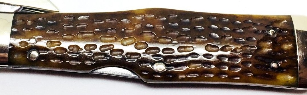

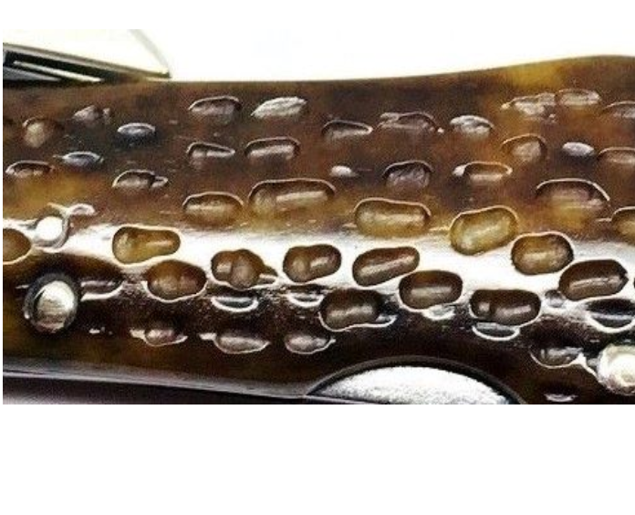

I've seen enough bad hand rotary tool jigging to recognize it when I see it. Not that it can't be done well but this is not well done in my opinion. Buffing or pocket wear would not selectively remove the color from some of the jigging and it would not leave a round or oval depression.
Here are a couple of close ups of the jigging. You can actually see where some of what may be the original jigging has been gone over or run into with a rotary tool. Jigging on top of jigging. Notice the nearly round holes inside some of the oval jigging and round holes at the end of some of the large oval holes in the bottom picture? Never seen anything like this on any original jigged bone factory knife Case or otherwise.
