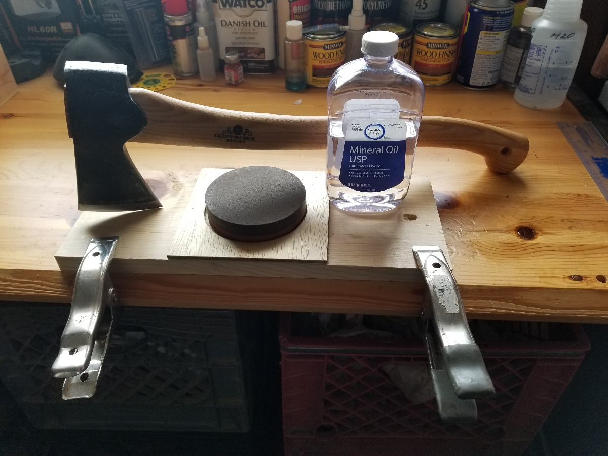

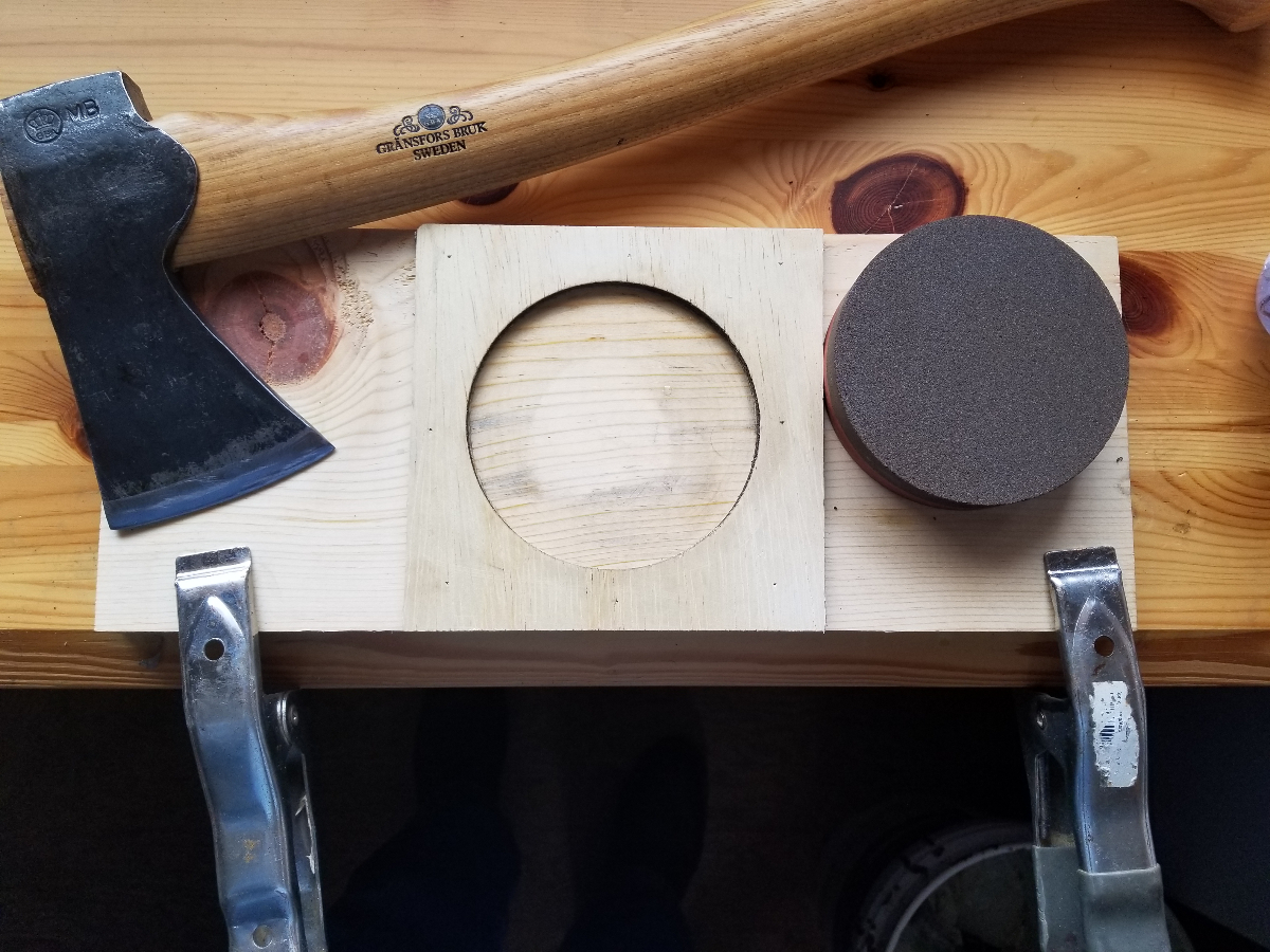

I use a Norton India stone with mineral oil for all of my axe sharping. The challenge for me when using the stone freehand was not cutting my fingers or hand. So I made a simple stone holder to keep the stone in place while clamped to the work bench. By using alternating circular strokes with one hand on the axe head and the other on the handle I can now safely sharpen the axe. The holder is a piece of 1/4 inch ply drilled with a 4 inch hole saw that's pin nailed to a 1x6 pine board. This holder accommodates the 1x4 inch India stone perfectly. Aside from having a sharp axe there's no bloody mess to clean up.

When it comes to sharpening, any and all safety and convenience aids are allowed. That one is great!

KK, I always appreciate the simple problem solver. That is genius.

That is a great safety idea; thanks for sharing! What is the approximate grit range on the stone you are using for SHARPENING?

Thanks for the idea. I usually set up the axe in a vice to hold it steady. Depending on how dull it is I start with a bastard file, then a course or medium grit stone. If it’s not too dull I skip the file. Your method is a lot safer, although I can’t recall ever cutting myself with an axe (but too many times with a pocket knife
). Never used a round stone either.

I put my head in a vice too, as mentioned by Ken. And I will use a file or large coarse stone to get the edge I want.
I have a round stone too but I have never used it. I'm afraid I'll cut myself.

The Norton India stone grits are 150 (dark side) and 400 (light orange side).tongueriver wrote:That is a great safety idea; thanks for sharing! What is the approximate grit range on the stone you are using for SHARPENING?
