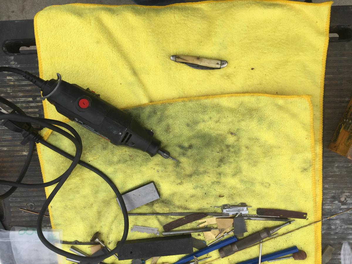

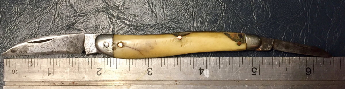

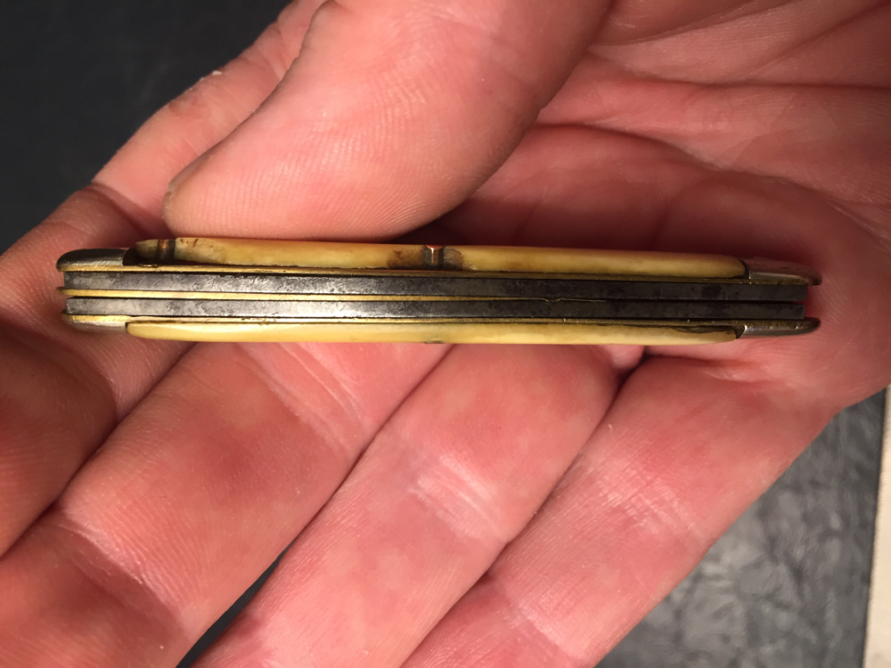

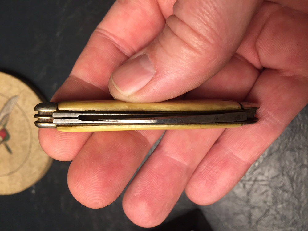

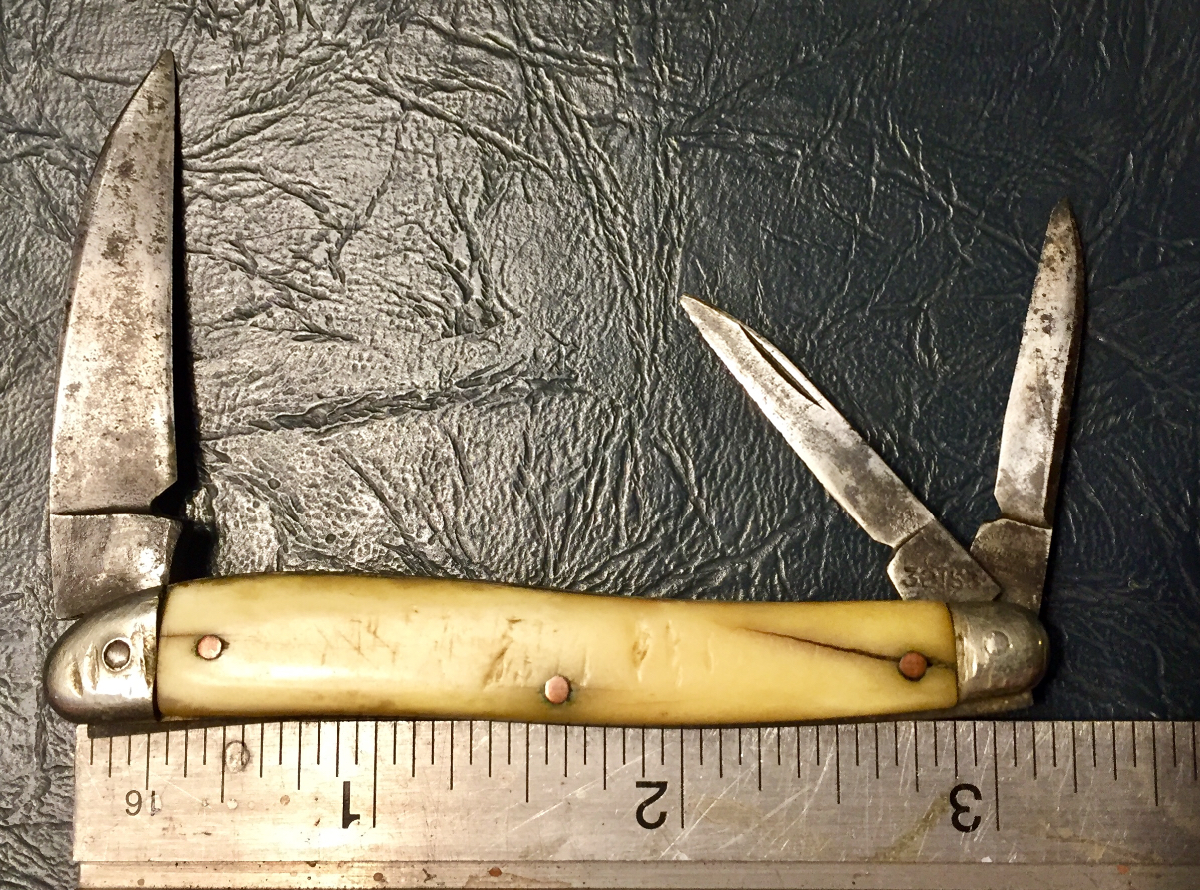

I picked up this Catt for my next endeavor. It will be quite ambitious. All 3 blades are in servisable condition. The biggest thing is finding out if this originally came with MOP. As it has bone now. Decent snap on all blades. They are not loose.
I will get the blades cleaned and polished up first. I will document my journey.
Tom

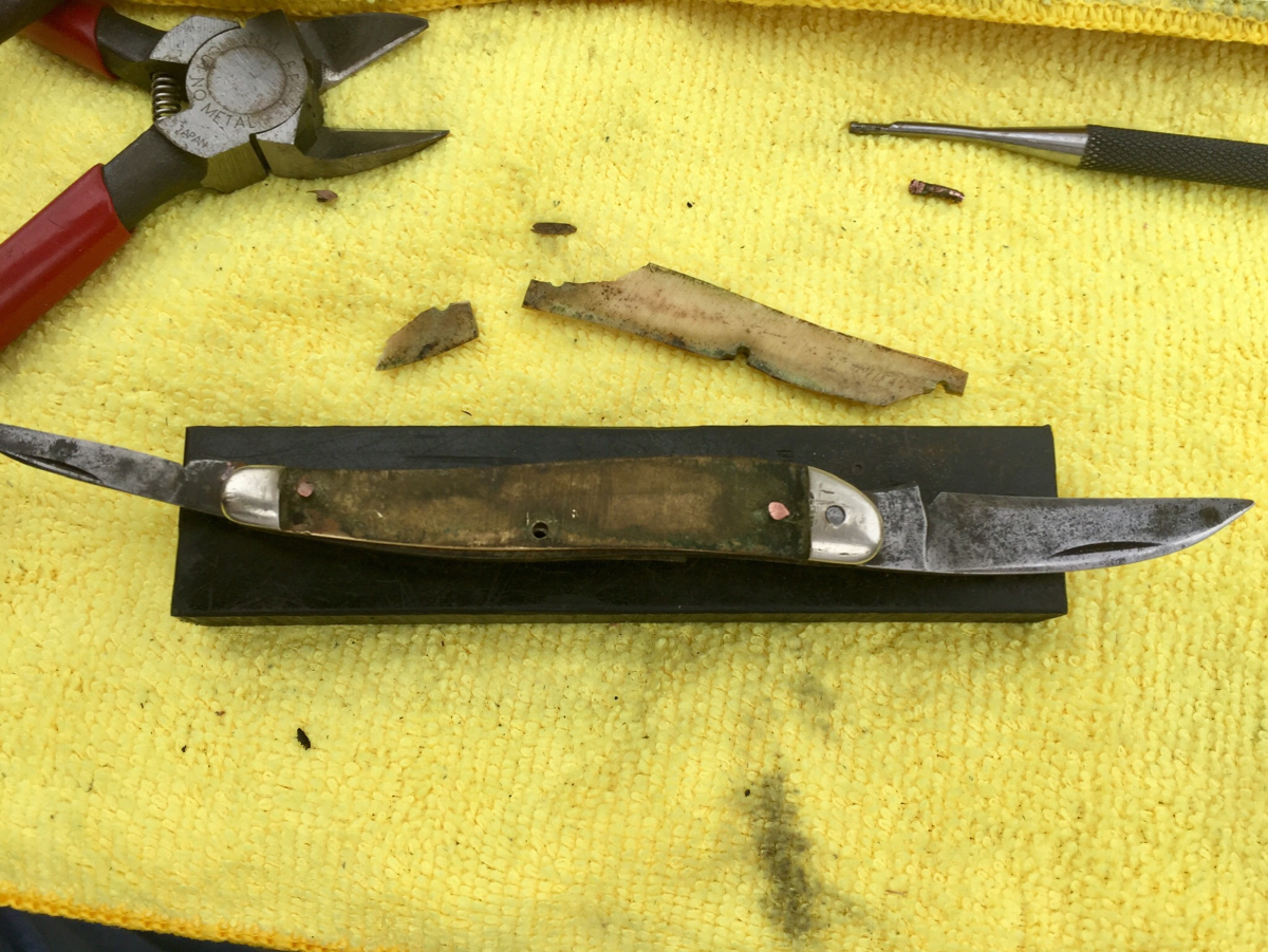

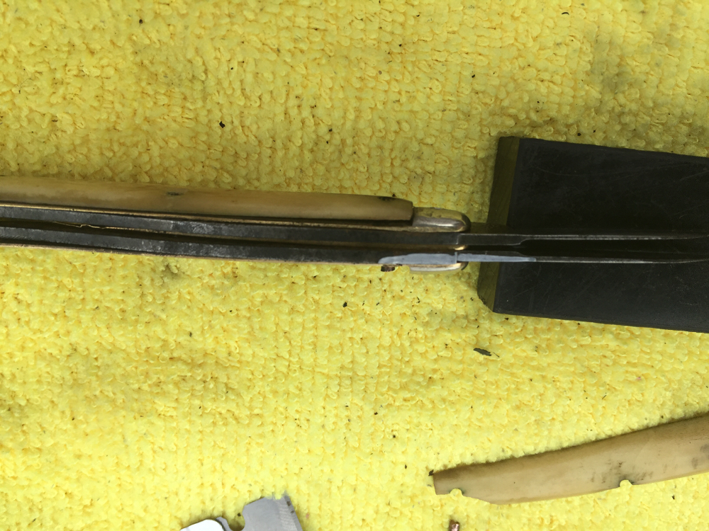

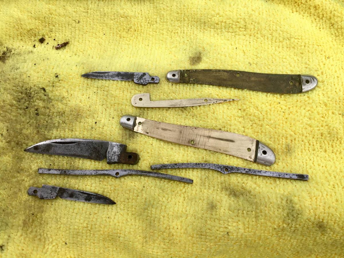

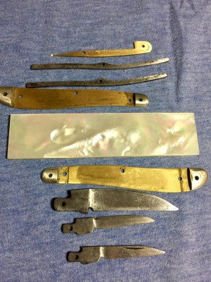

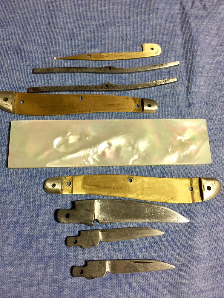

Got everything apart and started rough cleaning to see what I have to work with. Blades and springs look really good. The liners will need a bit of loving.
After getting everything apart, it is obvious that it has been re-scaled. The pins were copper.
Tomorrow I will work on the liners and get the deep gouges out of the bolsters. I may start cleaning the blades. I will leave the tangs alone as much as possible. As the stamping is super light.
When I rescale I will epoxy the MOP on so O do not have to do any unnecessary drilling and pinning.
Anyhow, here are a few shots.

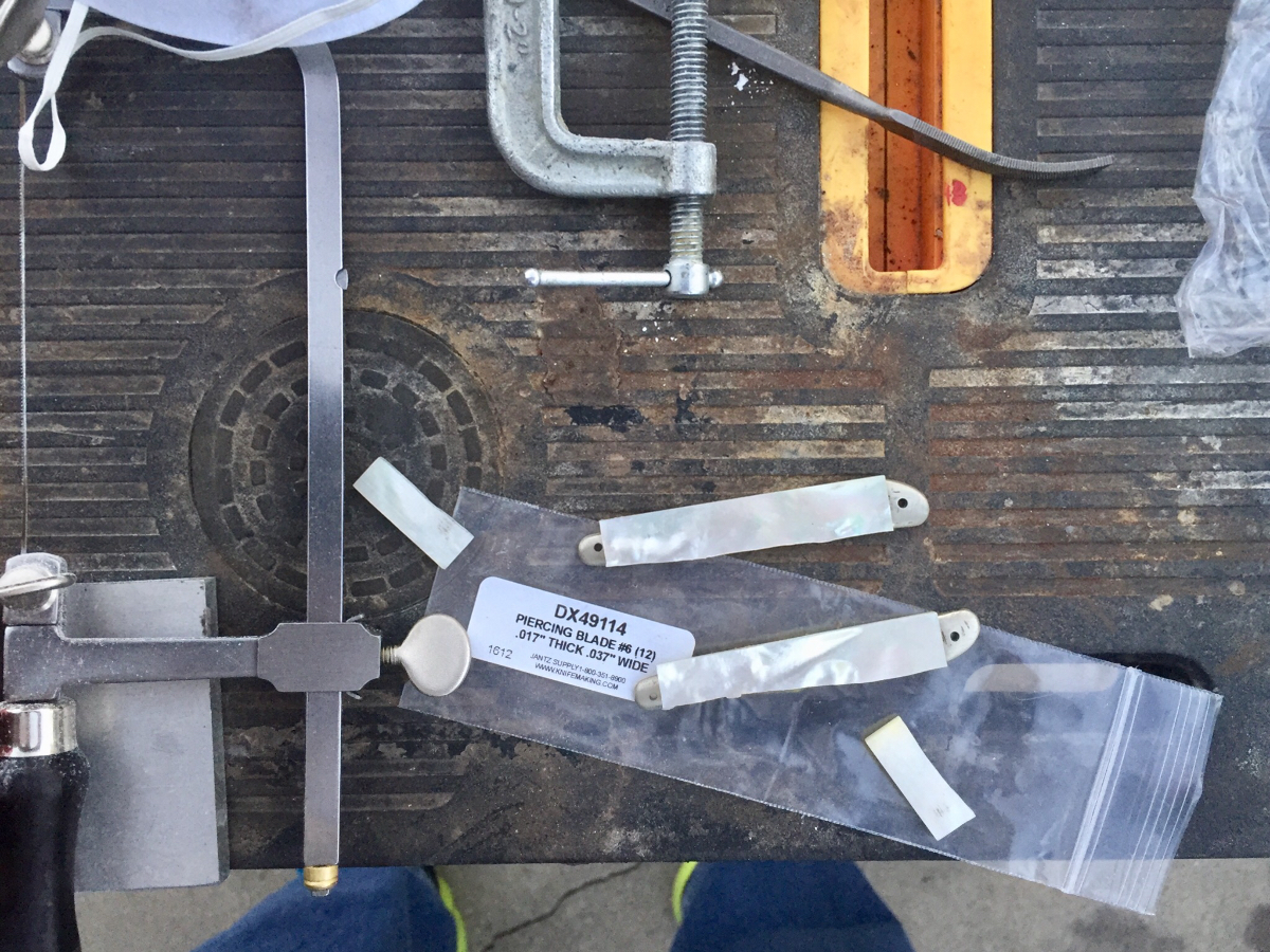

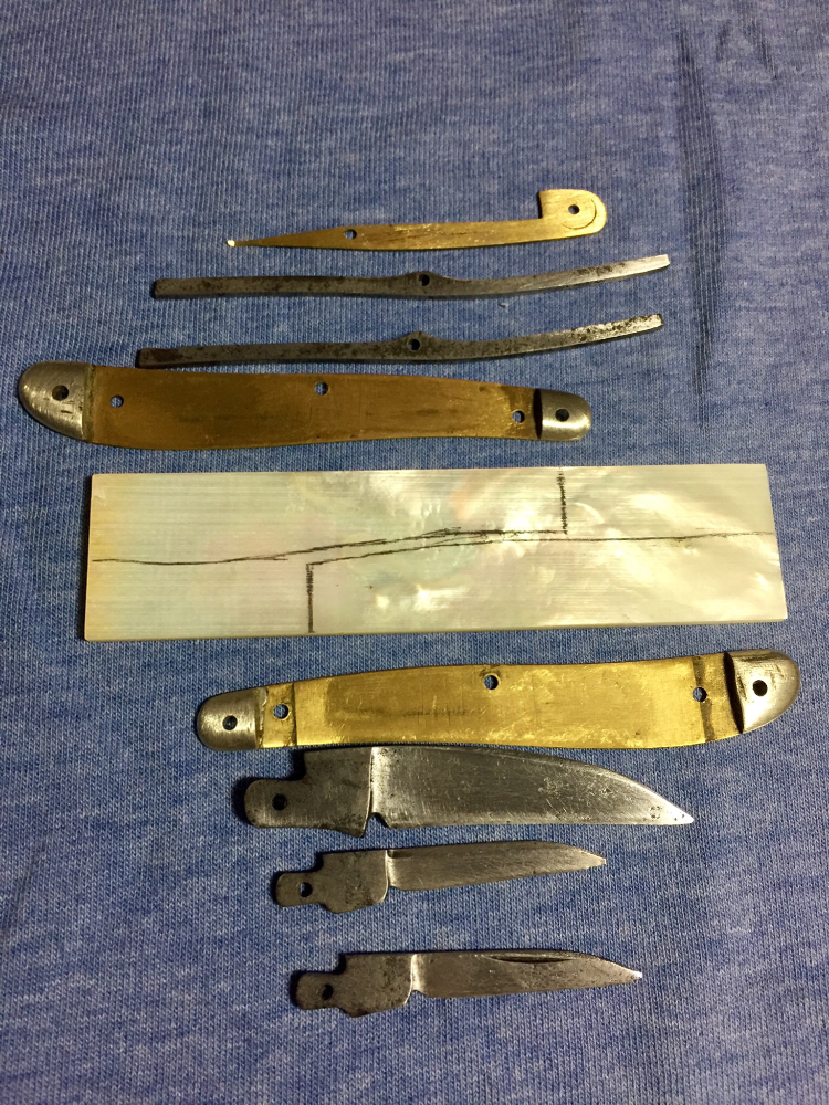

I received my MOP and am just waiting for a jewelers saw blades and nickel silver rod to arrive from Jantz. I had to buy extra stuff to justify the high shipping. Not bad I guess. Now have some stock and tools for future knife projects.
The MOP I bought of of EBay. 2 slabs 2.7mm thick by 22x90 mm. That size barely fits to get both scales from one slab. So hopefully I can have an extra slab for another knife. I opted for the high grade MOP as to avoid imperfections when I finish shape.
I marked the back side of the slab to cut. With any luck I will receive the supplies tomorrow.
Now I need advise on the blades. I only removed active rust and went to 600 wet dry. I did not want to over sand the blades. Do you all think I should go full boat and try to get them as close to factory as possible? Keep in mind I carry and use all of my knives.
Thanks
Tom

Coming along nicely! Now to your question. My opinion, leave them "used", only removing the active rust and nothing more. It's not a new knife, so why make the blades new? That being said, it's your knife. ::tu::

glennbad wrote:Coming along nicely! Now to your question. My opinion, leave them "used", only removing the active rust and nothing more. It's not a new knife, so why make the blades new? That being said, it's your knife. ::tu::
That is the way I was leaning. It’s not like I plan on selling them.

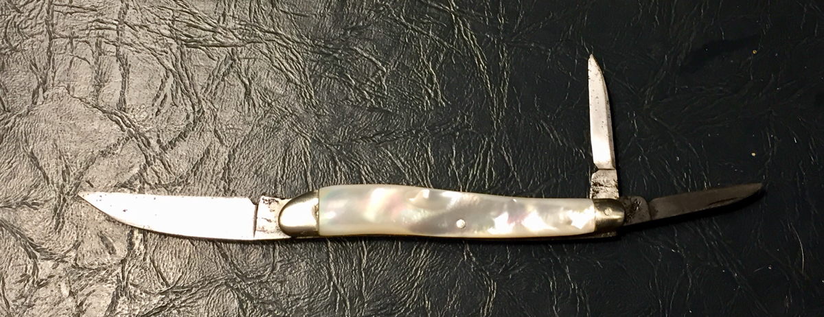

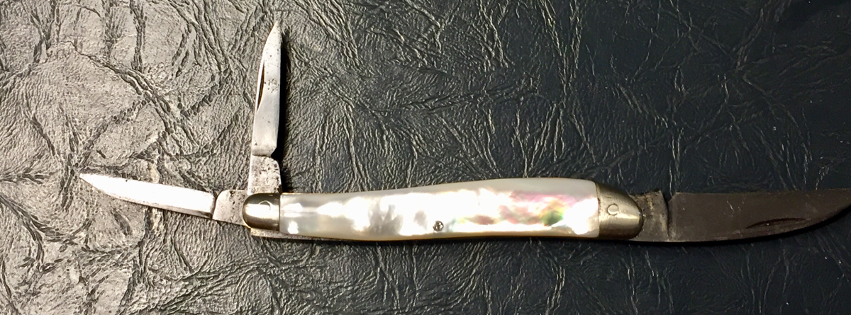

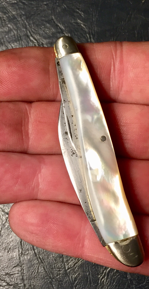

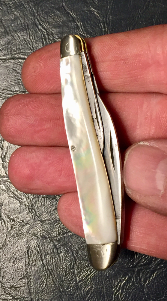

Here it is all done. I will give this a grade of C The bolsters were very messed up. I will work wth that some more. The holes for the pins in the bolsters were way out of round. So it is a crappy looking pin job. On the plus side. I am very happy with the way the MOP turned out.
I can chalk this up to a bit more experience. I would not hesitate to work with MOP again.

Post by Doc B »
Very nice! All you have to do, is look back at that original picture...and know you've given her a great makeover!!!!!
Ivoryman
Posts: 9551
Location: Seattle, WA
Re: Cattaraugus 32153 resto
Post by Ivoryman »
Great show there with the MOP TWhite. Like seeing the mods and craftsmanship. Looks pretty good to me, even the pin job. Thanks for showing. That's great.

Thanks guys for the complements. I am liking this outcome more each day. I have been carrying it for several days now. The blades are nice and sharp and come in handy. When I bust it out to use it, people have noticed it and I get to show them before and after.
I worked on the bolsters more and got them more presentable.
