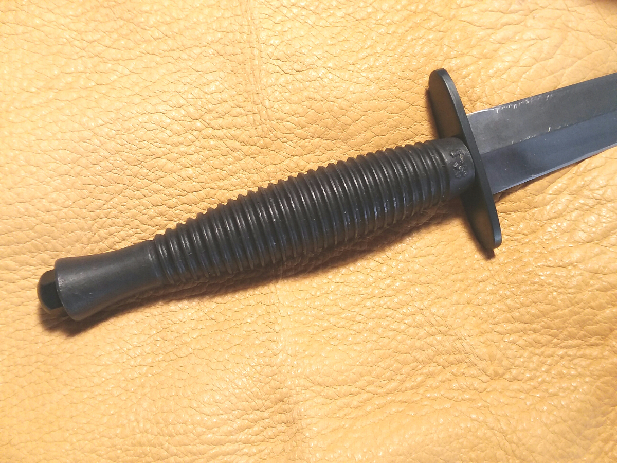

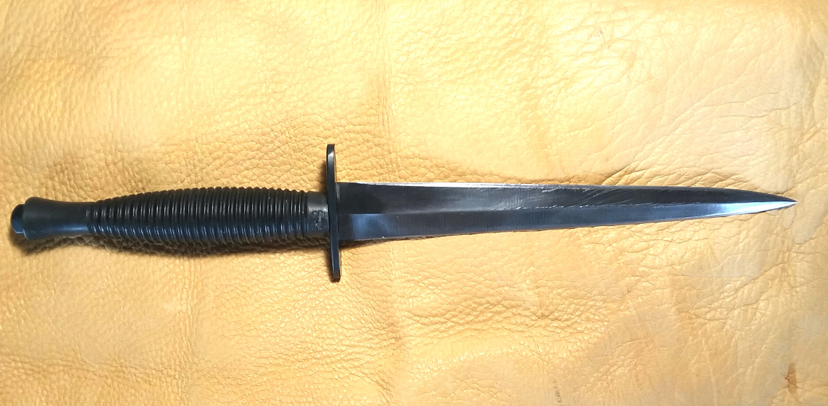

I posted a picture of this knife a few days ago in another thread. I learned that although it's a J. Norwill & Sons, Sheffield, it is of later manufacture and not a collectable variety of the Sykes Fairburn. The grip had a heavy coat of kahki paint on it and you couldn't see any marks on the grip as a result. I removed the paint down to bare metal on the grip, nut and guard. I made some ferric chloride to blacken the zinc grip and heated up both nut and guard with a torch (they are steel) and applied linseed oil to blacken them. It looks so much better than it did painted and it was fun to do. Now I've got plans for a crossdraw leather sheath.

Looks better than camo, you did a good job on it.
rangerbluedog
Posts: 3589
Joined: Thu Dec 03, 2009 7:42 pm
Re: Fairburn Sykes redo
Post by rangerbluedog »
Nice job! I think it looks much better now. ::tu::
-Blue
Click the link below to order your copy of the Boker book!
https://TheBokerBook.com
FRJ
Posts: 16244
Location: Ct.
Post by FRJ »
It may not be collectible but now it looks like something you'd like to own. ::tu::
Good job.
Posts: 39412
Post by jerryd6818 »
I'm impressed! ::tu::
Posts: 21217
Big improvement. ::nod::
