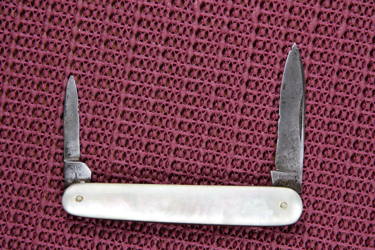

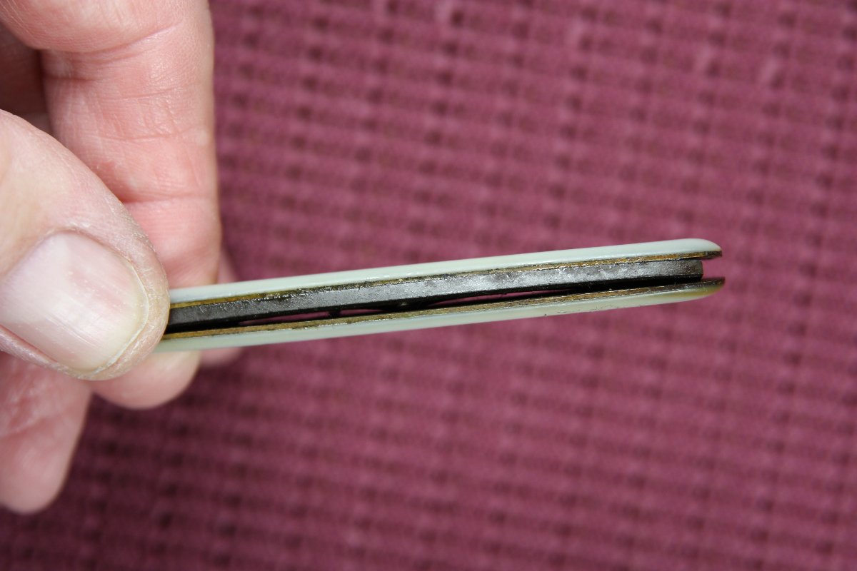

I was wondering if any of you knife mechanics would have any words of advice for dis assembling a shadow pattern mother of pearl pen? It is a 3" Boker that I picked up cheap at a gunshow. My normal method would be to take a Stanley box cutter blade and drive it down between the blades with a hammer to cut thru the 3 pins. I am thinking that that is too extreme for using on a MOP handled knife. The rocker pin on this pen does not go thru the handle material, and the rocker pin has pulled thru one of the liners and the spring side is opening up. I have never taken a MOP knife apart before and thought I may be able to get some tips to avoid breaking what is nice intact MOP. Another option I thought about is to use a tiny ball end cutter in the Dremel to remove the peened over ends from the pivot pins. Any words of wisdom from someone who has done this before?

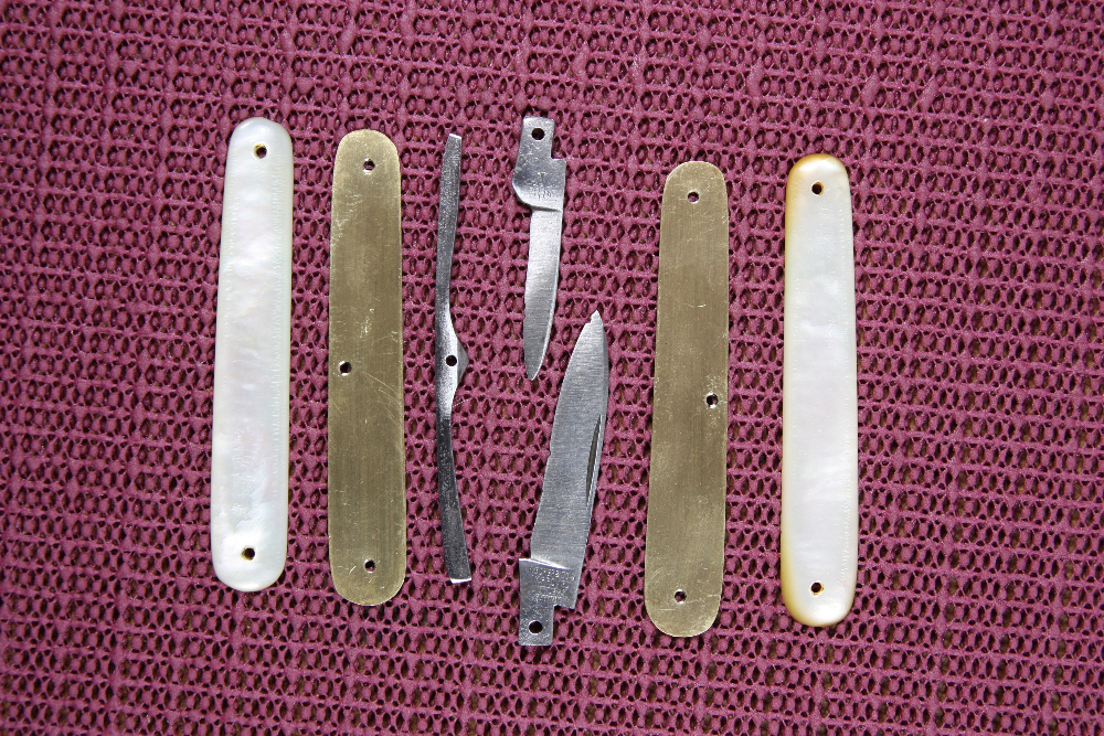

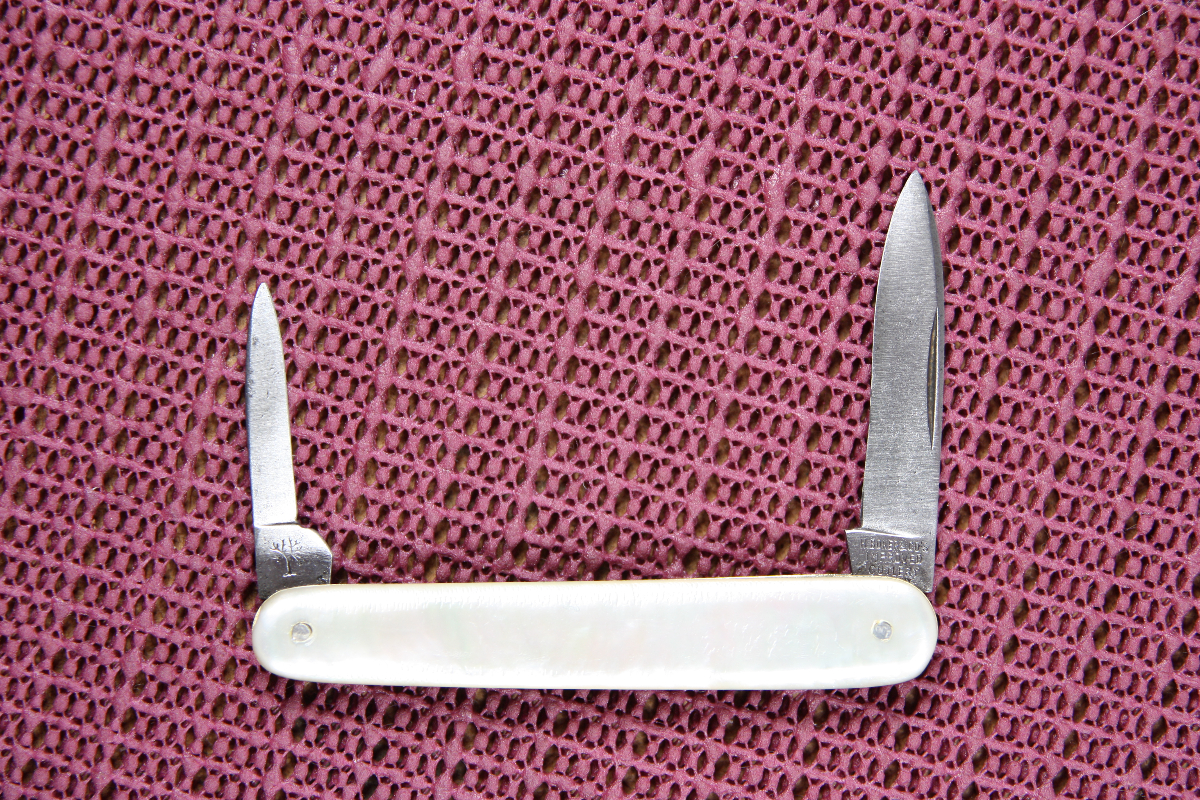

What I ended up doing with this Boker pen to disassemble it was to use a tiny ball end cutter in the Dremel tool and make a tiny dimple in the center of the pins and then gradually work that out to the edges to take off the peened over end to the pins. Then they pushed right out. Cleaned everything up and reassembled by countersinking the outside of the liners over the rocker pin, put in new rocker pin, filed everything flat and reassembled the pivot pins. Turn out good, I was VERY CAREFUL when peening the pivot pins. Like I said, this was the first MOP knife I have had apart.

That came out nice.
- Twhite
- Posts: 156
- Joined: Tue Nov 20, 2018 3:29 am
- Location: Burbank CA
Re: Mother of Pearl disassembly
great job.
- #goldpan
- Posts: 1891
- Posts: 23967
OH that one turned out great.
- btrwtr
- Posts: 5484
Well done!
Wayne
Wayne
- Doc B
- Posts: 3700
- Location: San Antonio
She's a beauty! Nice job on the blades, too...they were in need of some OC love, got it and came out great!
- orvet
- Posts: 19904
Very nice work. Looks like it's ready for the pocket
