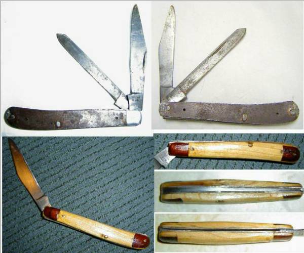

Here is my first try. It was a badly abused two blade trapper.
I'll to make it an edc to see how it holds up.

Hey JOE, thx for the pictures! You tackled the pins right off. I took the easy way out and glued mine on. I was looking at a repair book and it shows pictures of "spining the pin"
How did you handle that part?
I looks like I could get two nail sets and modify them for use as pin spins.

Hawke, I found a small drill bit that fit the orginal holes in the liners and drilled the handles. Then I found some small nails that I chucked up in a drill and turned down to fit, then I pinned and glued the handles to the liners. Finally I peened the nails with a punch on a metal block. I used some techniques I've learned from repairing old Harley clutch hub studs and some my brother, who is a jeweler, taught me. But most was trail and error. With Lots of error.

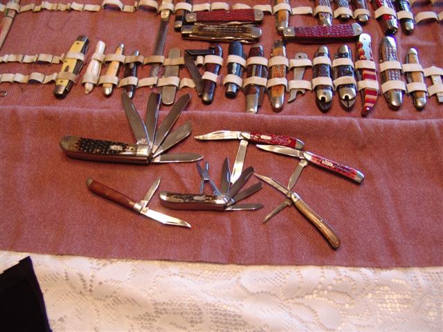

Hi, there all you peanut lover's. GREAT little pattern. I like them. Don't know why I don't have more of them.
The pics below are my entire lot of them...
Clockwise, searting at the top...
Case Magician's knife 1997 1 of 1,000
Case 1996 test run. Different, oddball handles.
KA-BAR barehead. An oldie
Case Big- Nut 1997
Queen 1981 Rawhide series
Just had to throw in a pic of the green bone Beast 1996.

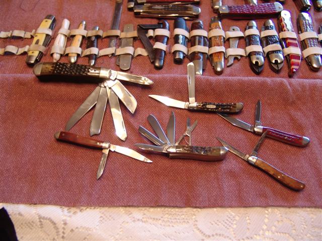

Here's the flip side of them.
I would probably consider any interesting trades or offers, on any, or all of them. They ALL belong, in a true Peanut collection.
