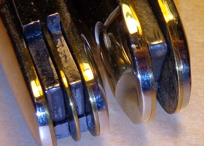

Here is an example of an knife with very sharp corners on the tangs on the left, and on the right one that used to have just as sharp a corner before I rounded it off a bit. Glenn, I have not really seen this situation in knife that does not have half stops. What is your take on that?glennbad wrote:I have used a technique that helps with the strong opening. It is something that anyone can do, however, I would only recommend doing it to a knife you are going to use and don't care if the liners get scratches inside. Open your problem knife blade (tape the edge to protect yourself from getting cut). You'll need some jewelers files. I like the little square cut one. Now carefully ease the corner of the tang with the file to round it over some. You have to make sure to also get in the corners where the tang meets the liners.

I usually only see this in knives with square tangs. Ones with cammed tangs are much smoother in action, I have found. I do not recall having used that technique on knives with cammed tangs, only square.

Marcellus - glad to read that deepening the nail nick worked for your knife. That is a solution I have never seen mentioned and I question if it would help on a lot of knives. It does sound as if you have had a bit of bad luck with your Case knives. I do not have a lot Case knives, about a half dozen, but I only had the one that was a nail breaker. Naturally it was the one that I was most determined to carry!
