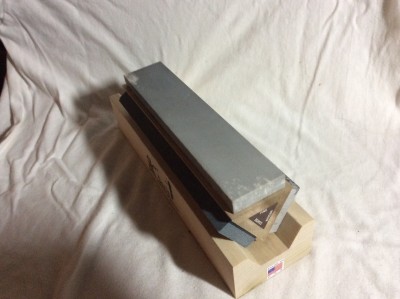

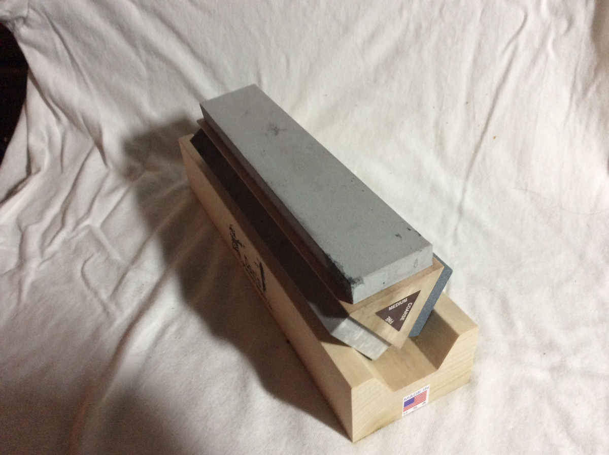

As I am new here and have been picking through millions of posts. I found it a bit strange there is not much talk of sharpening. I for one live to sharpen things. I use straight razors and needed to keep them keen. So I have a few different options for my knives.
My go to stones for my knives are my Arkansas. Washita for first polish after setting the bevel. Then move on to the Lily White and finish off with a hard black. But last month I got the Tru hone set from Dan’s Rough stone os a man made medium is a soft Arkansas and the Fine is a hard Arkansas. This is really working out nicely.

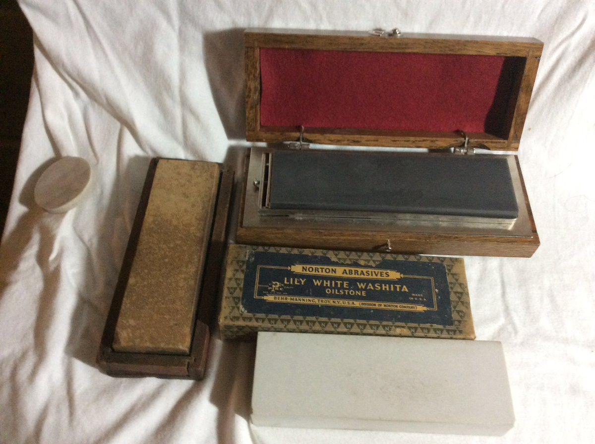

I have different rocks for my Straights. Naniwa progression. Then my naturals are Arkansas Translucent, Thuri, a couple of Coticuls, Yellow lakes and a JNat.Colonel26 wrote:A kindred soul!!!! I love old whet rocks. I’m a free hand sharpened too, and a straight razor shaver myself. Looks like you have some nice old rocks.
I much prefere natural finishes.

Nice Rocks you have there.
