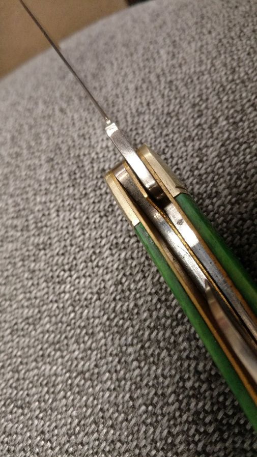

Short answer, yes. You'd have to be able to tap out the pin, then obviously have replacement pin material of the same thickness as the current one. The last thing you will need is the ability to flex the spring(s) enough to get the new pin in. It sounds like on the OP knife, the spey is on the back end, where the spring for the main (clip?) is. That's a tough end to do, as the springs are differently shaped. See the attached pic.philco wrote:Glenn if I may ask, can you replace the pin without taking the entire knife apart ?
See how the spey spring runs flat to the end, and the main spring slopes up to the top of the bolster? Even with the proper tools, it's still quite difficult to flex both those springs the proper amount to place the pin. Not sure how other mechanics do theirs, but I always pin this end first on a stockman for that reason.
